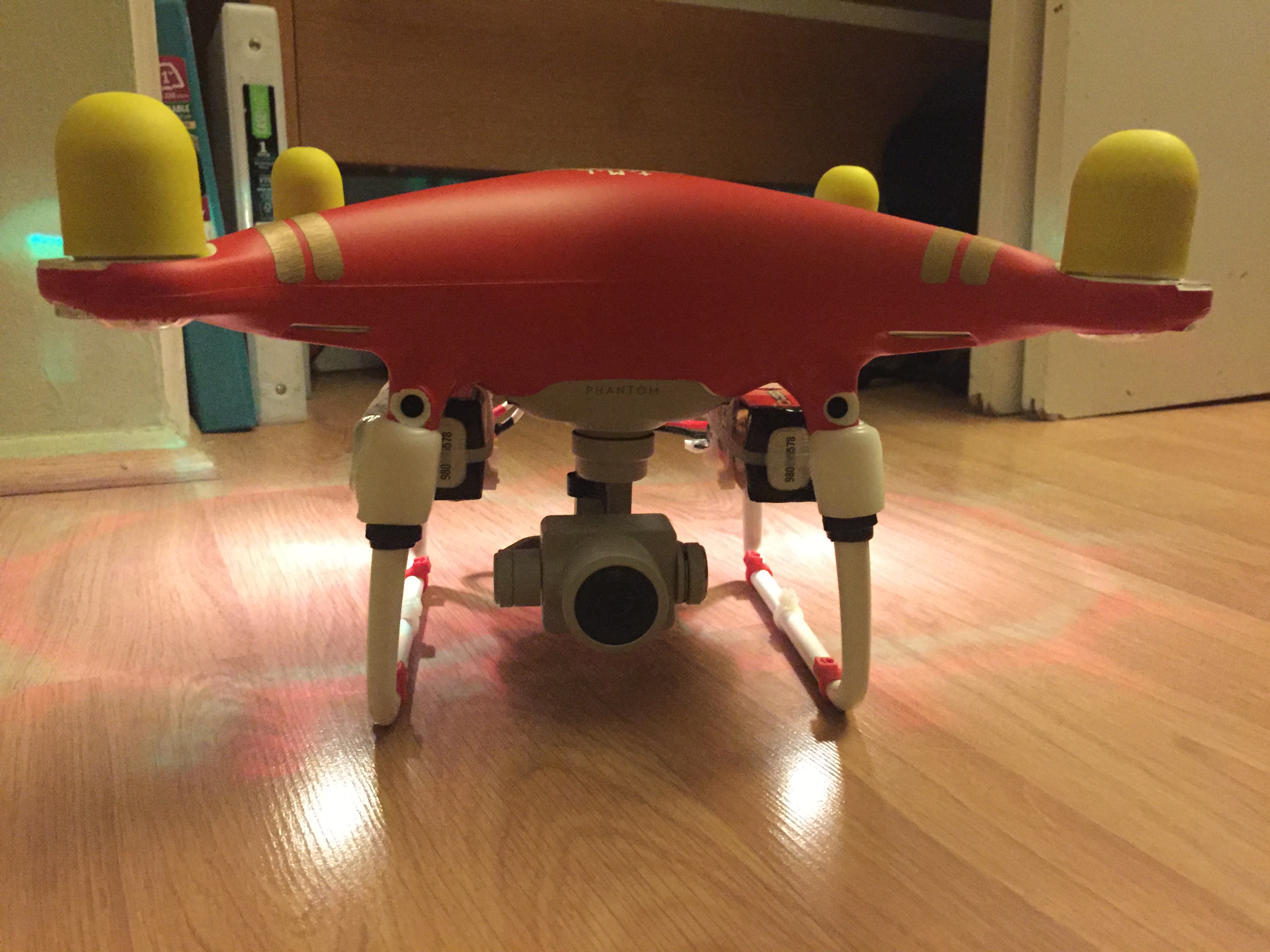

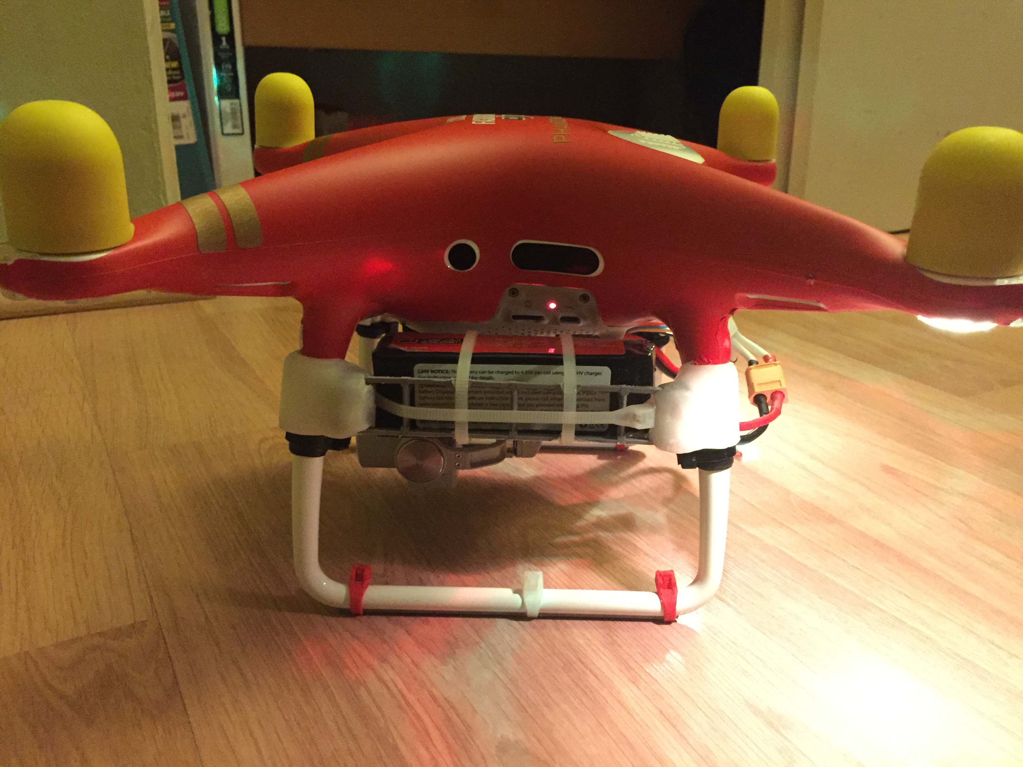

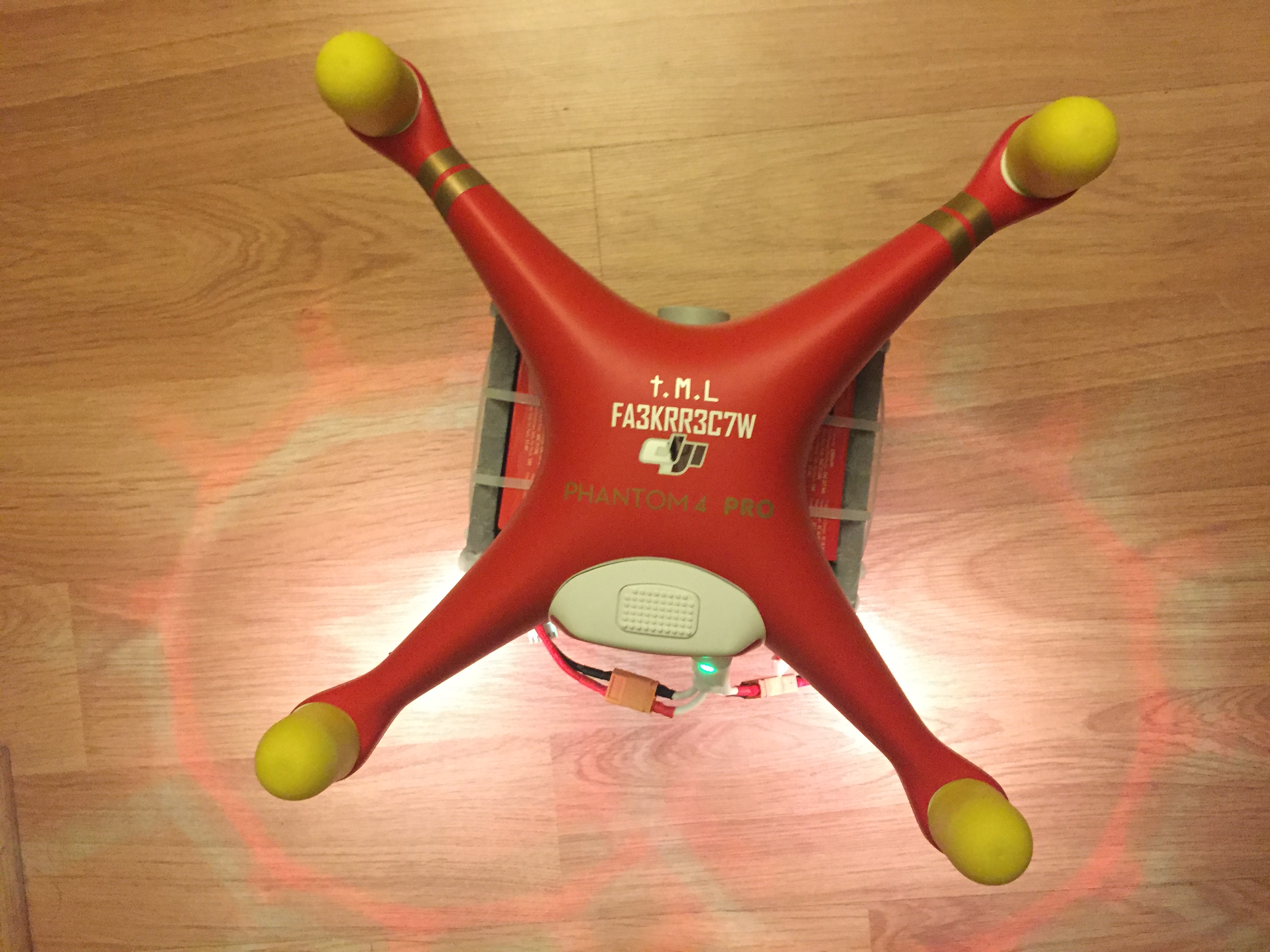

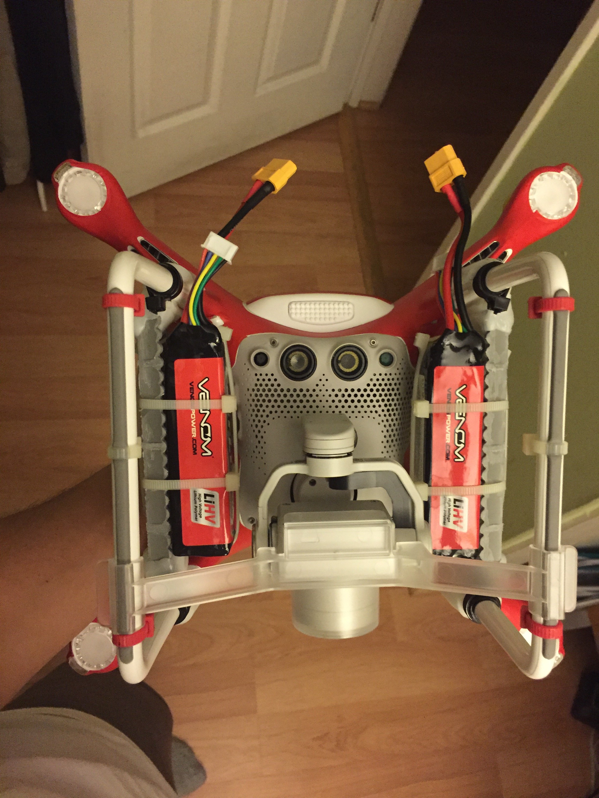

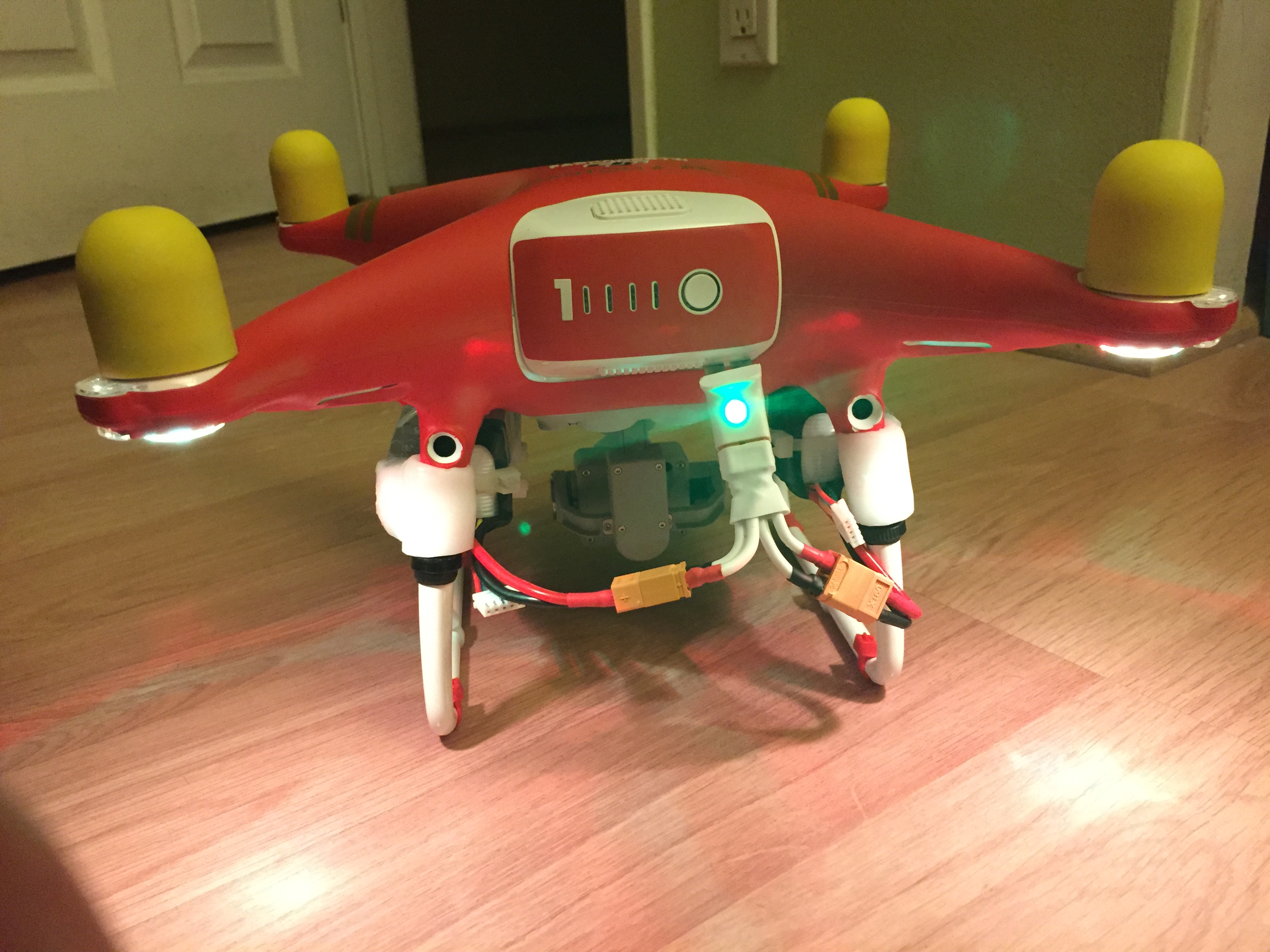

I had the materials, so I spent a few hours custom fitting the instamorph with a piece of plastic from a dishwashing rack. The weight may be heavier, but it's an easy design that snaps on and off. The total weight of the battery, brackets, instamorph, zip ties, and battery mod are less than 500g. I have yet to test this setup, but here are some snapshots.

I had the materials, so I spent the few hours custom fitting the instamorph with a piece of plastic from a dishwashing rack. The weight may be heavier, but it's an easy design that snaps on and off. The total weight of the battery, brackets, instamorph, zip ties, and battery mod are less than 500g. I have yet to test this setup, but here are some snapshots.

Update: Either the weight was too much or the batteries aren't that good. I got 22minutes wih 22% left, so I stopped the test. It flew better with the single pack under the vps, but I might have to change the bracket weight to lower the total weight.
Reactions: azgeek
Update: The batteries might be the problem. When I charged them to storage after the test, it only charged up to 52mAh and 152mAh for the other one, so that means they are not being fully utilized; therefore, it might be the extension cable or the batteries themselves. I guess more testing is required because as far as balance, this dual split pack flies better than the single fat pack under the vps.
Update: I purchased a new parallel xt60 cable since that or the batteries seem to be the problem. I shaved down the battery brackets to 9 grams each, and that only increased the flight time by about 30 seconds, so the batteries or the split cable is the problem.
