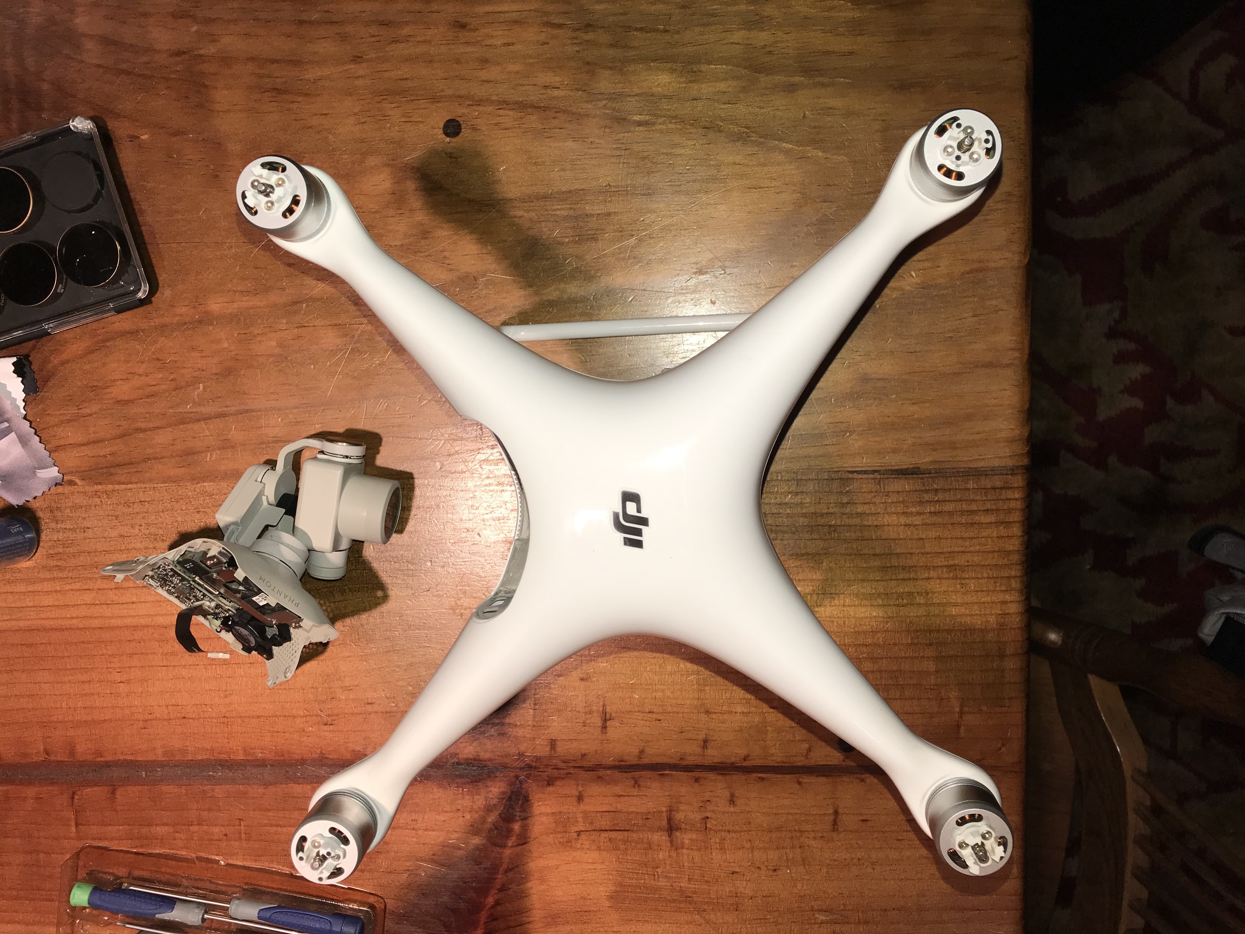

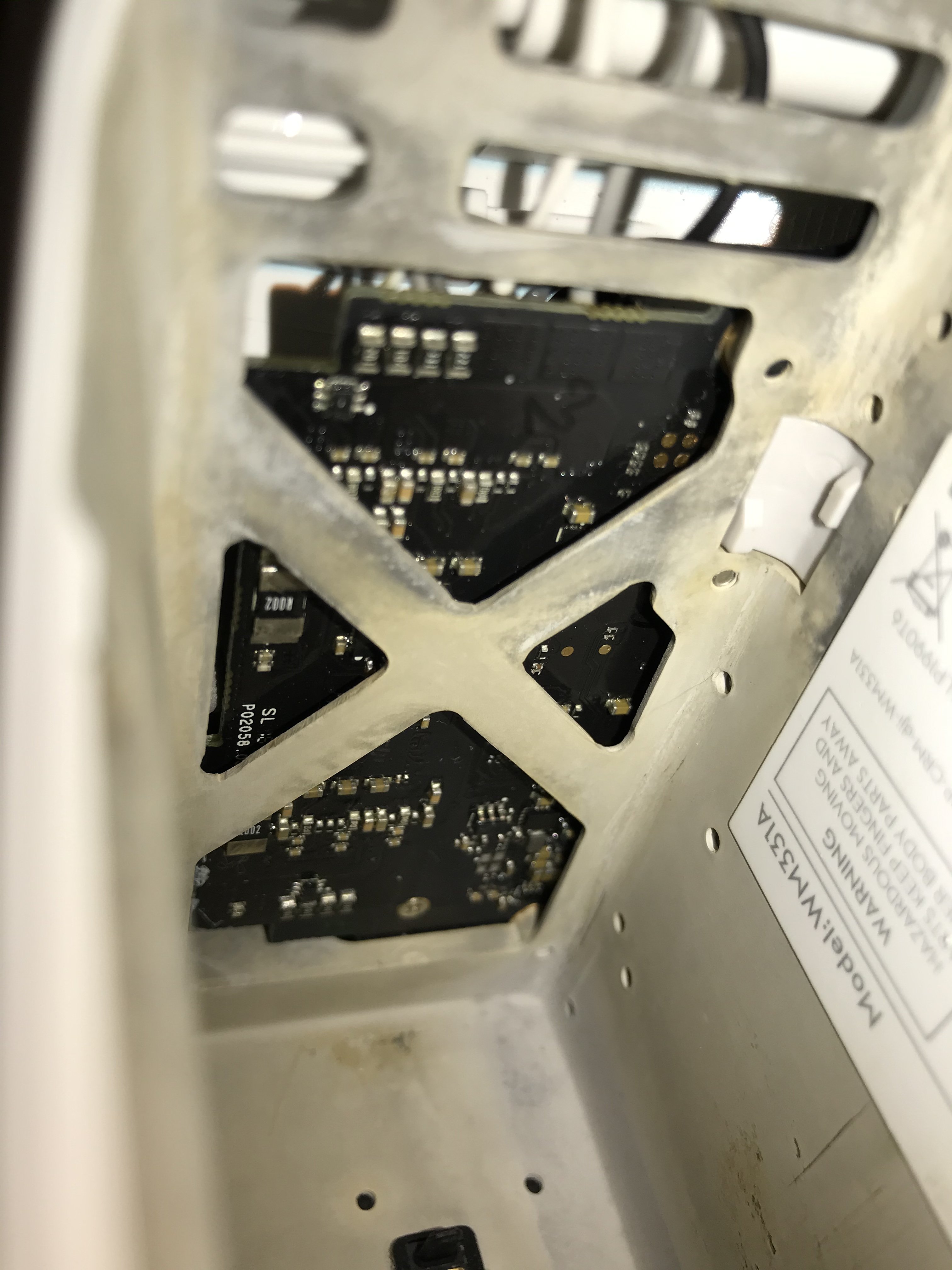

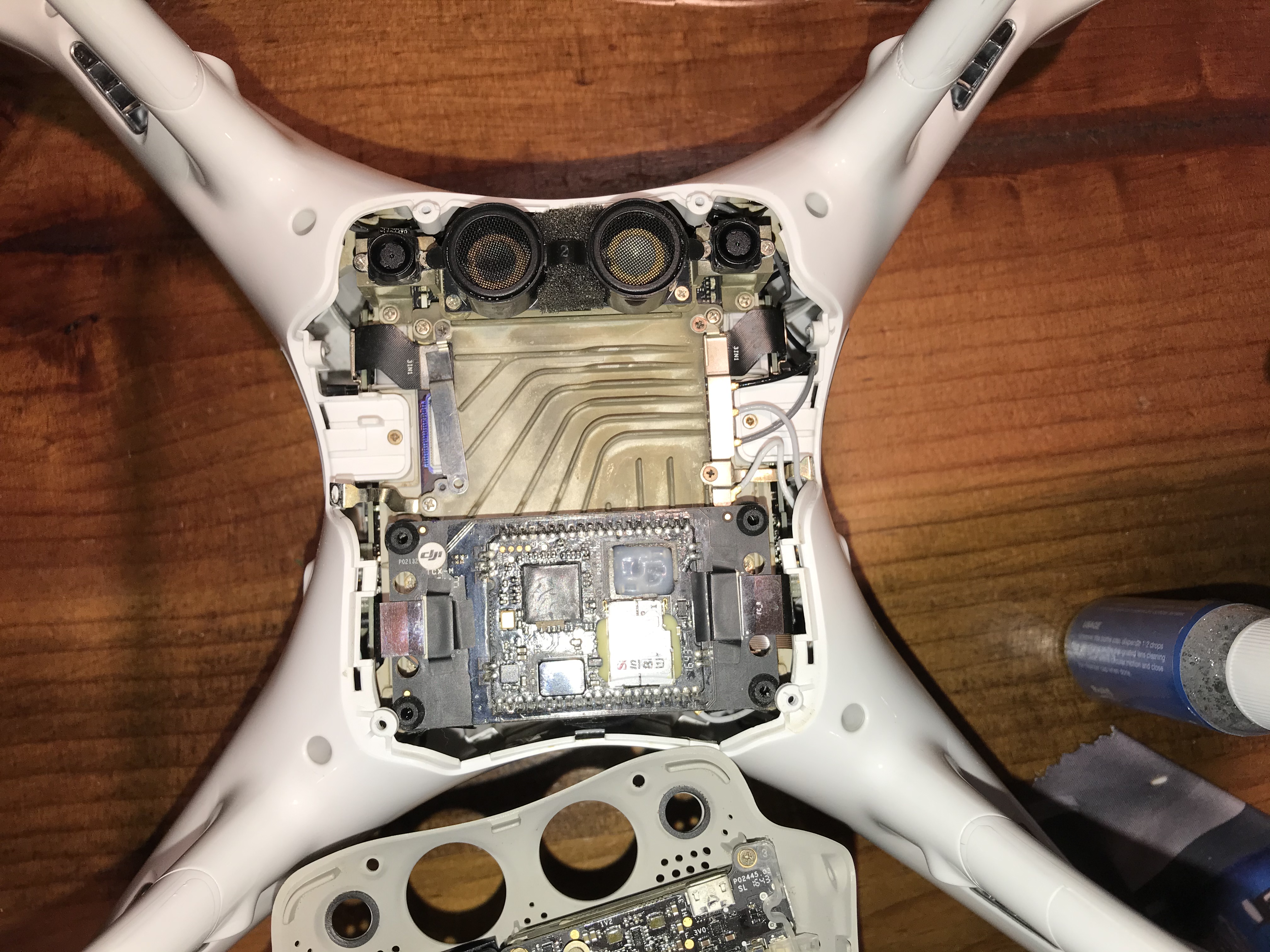

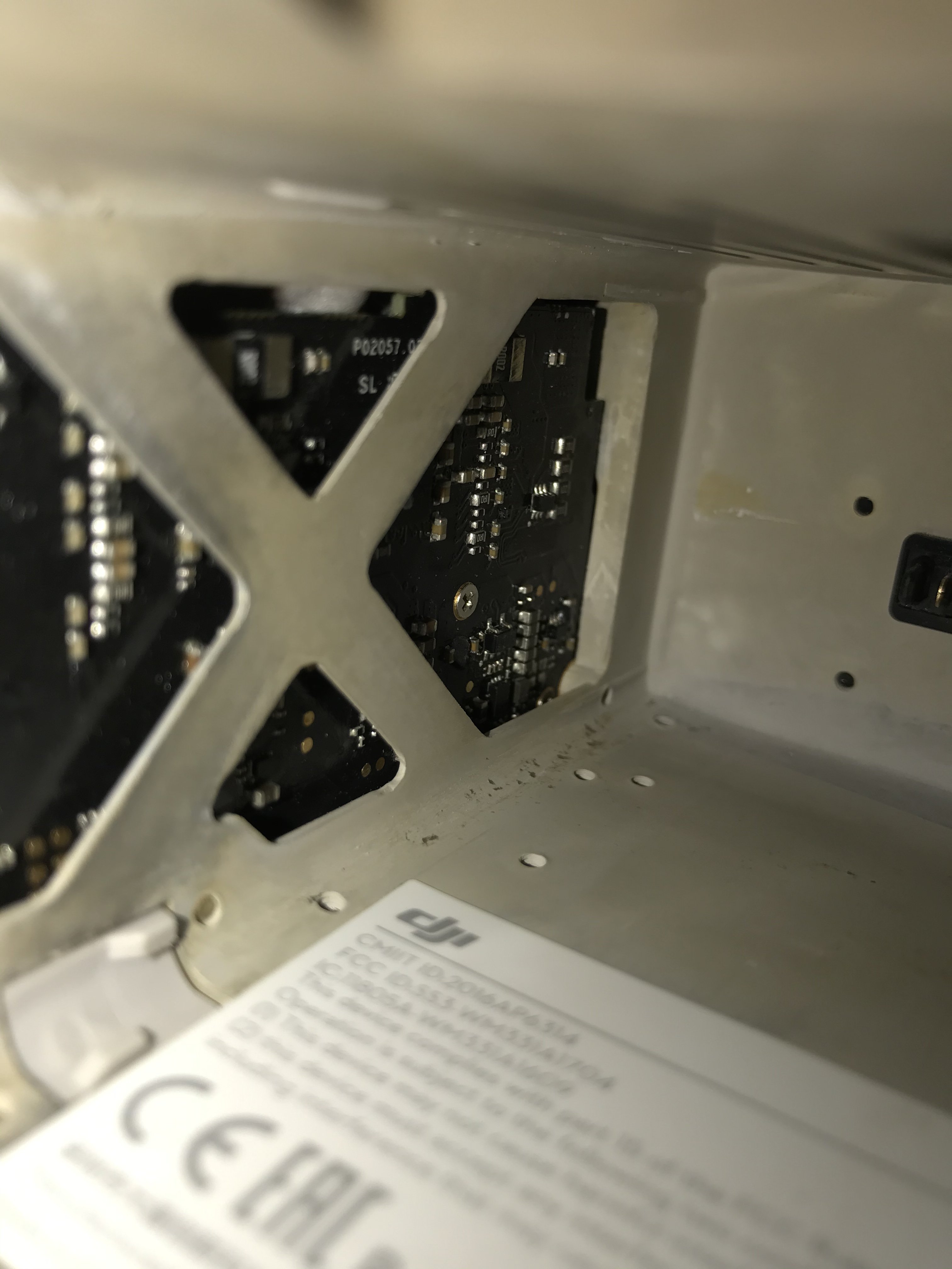

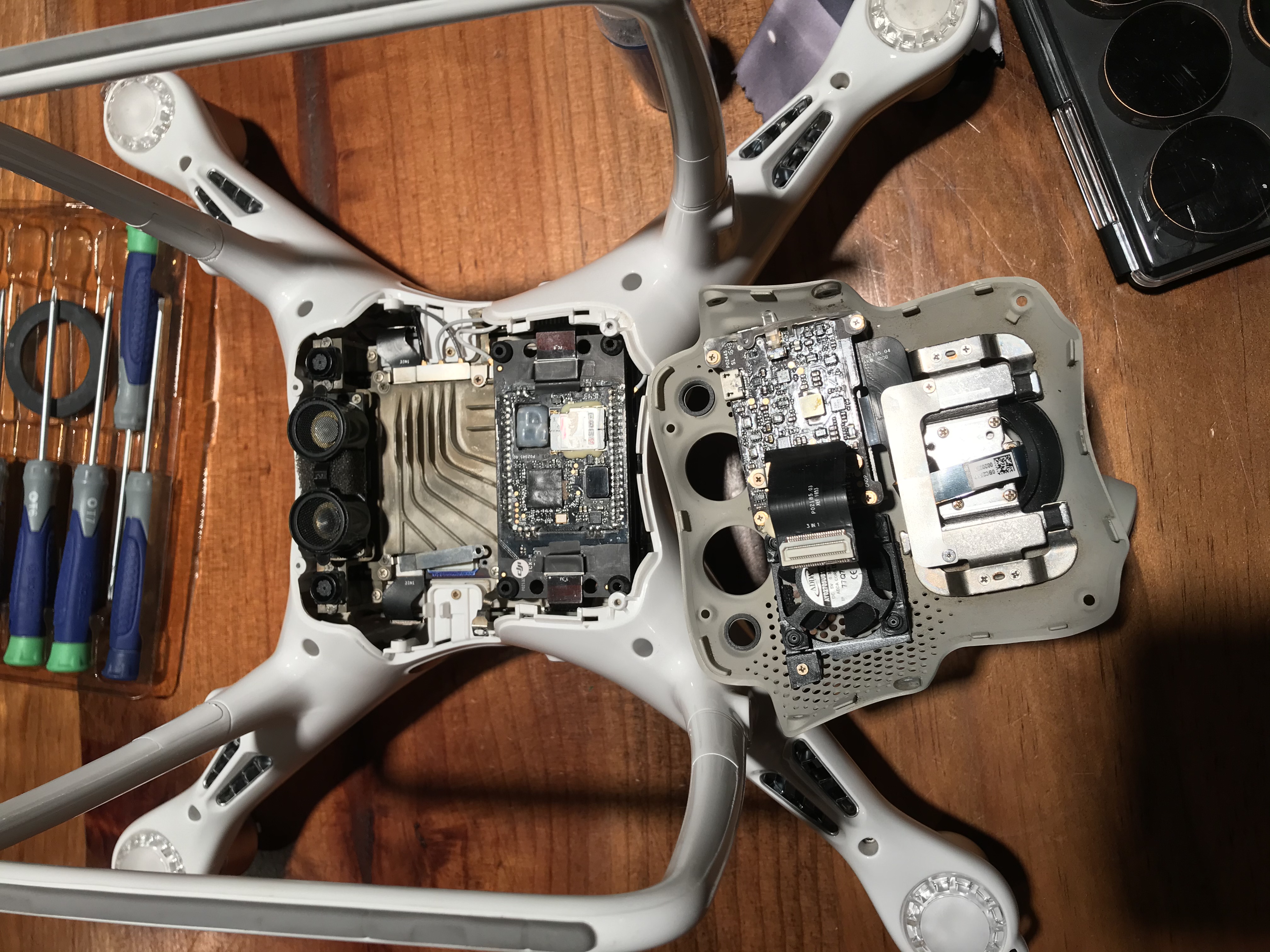

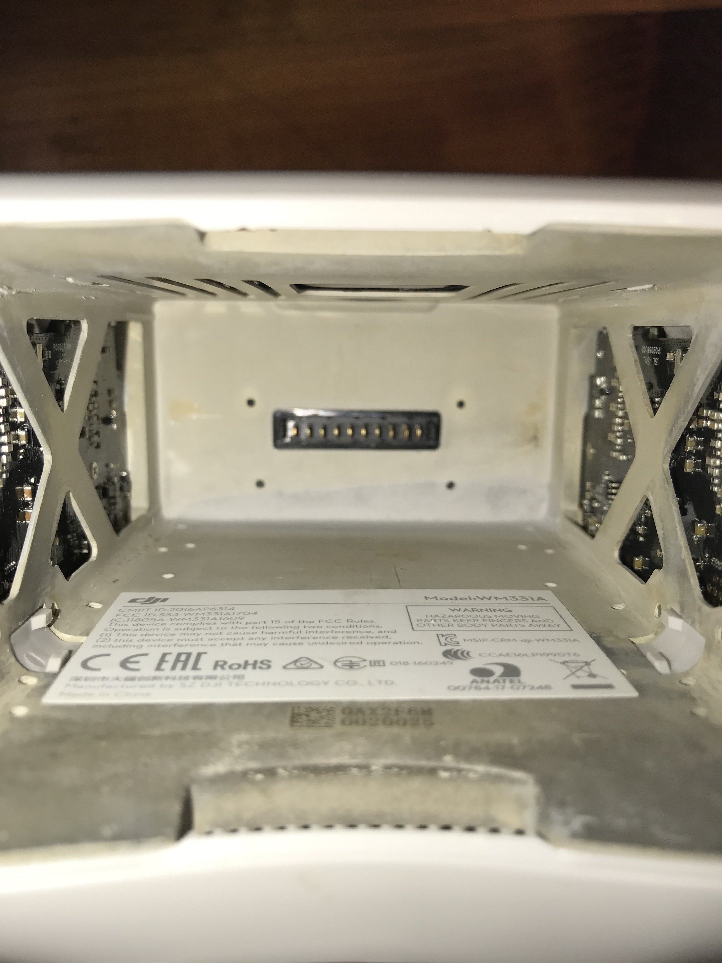

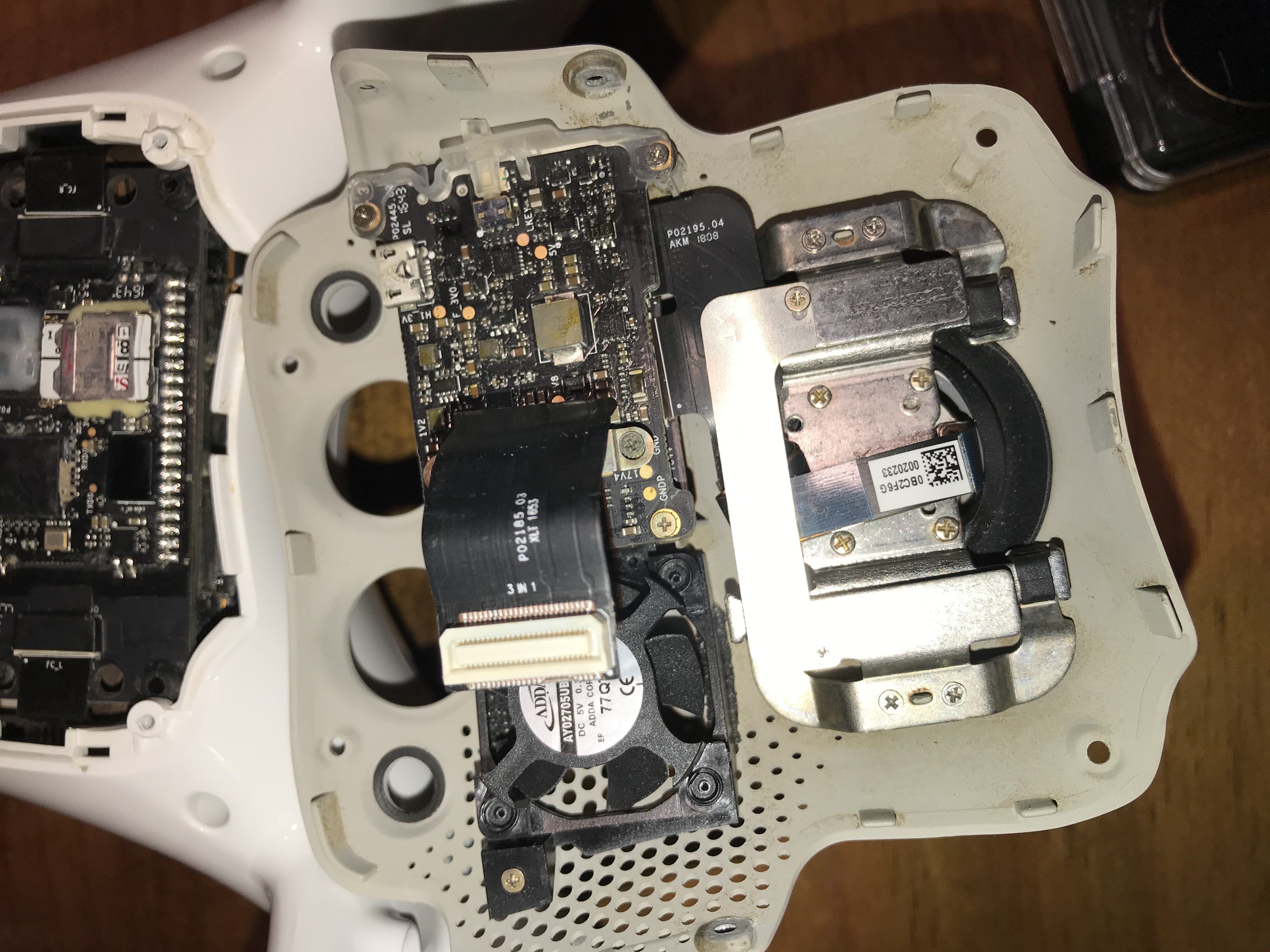

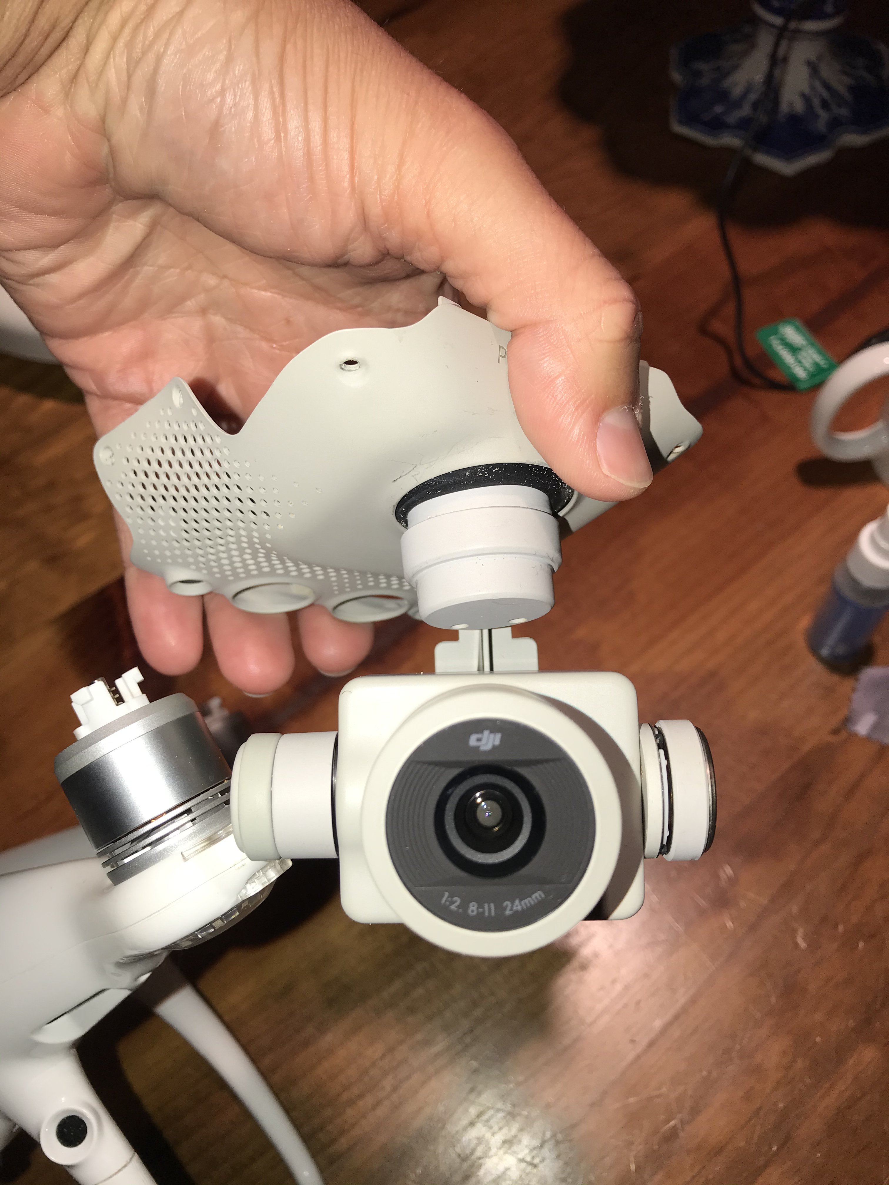

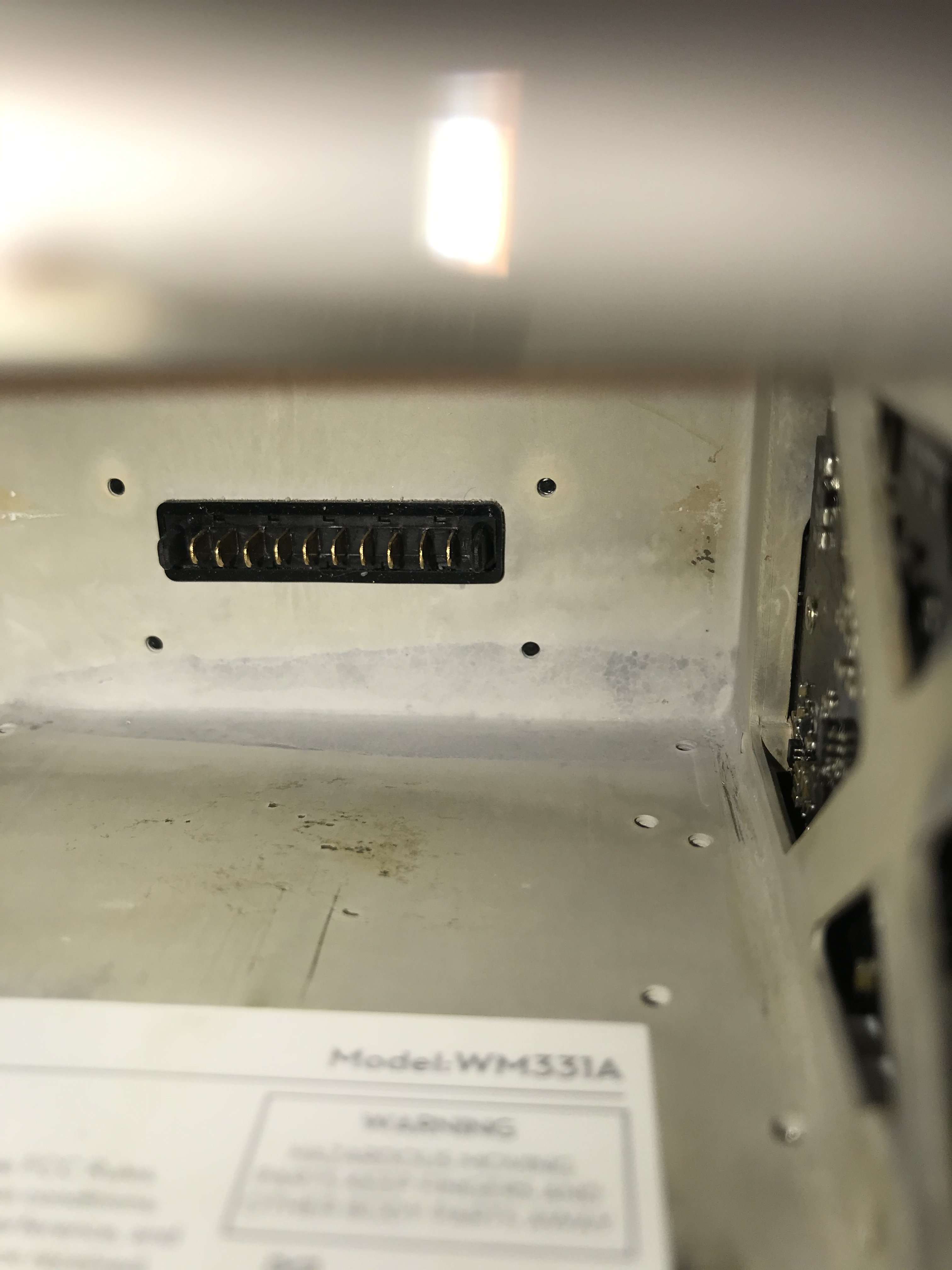

It had some mud and sand in it. It’s likely done and had been submerged for 2 days. Figured why the hell not. I also knew that before the mud and swamp water dried I needed to get it out quickly to have even the slightest chance of recovery. I have spent all day carefully taking it apart and cleaning it with camera cleaning tool kit. What would you have done differently?
Tell me what y’all think? How’s it look?.......
“SO YOU’RE TELLING ME THERE’S A CHANCE!?” -D&D

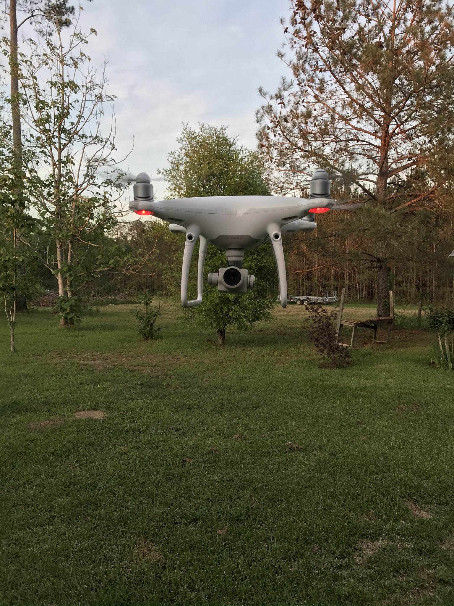

Good News! Found it with my bro’s Mavic Pro, which I enjoyed flying. Everything looks pretty intact. Except a few bent propellers.
Bad News is been submerged under muddy swamp water for two whole days.
Can it be Salvaged at all? It cleaned it out with some clean water(because why not it’s already wet) and wiped it out and now it’s drying under a light fan. I guess we will find out more soon. Anyone have experience with soaked P4Ps?
Check out a video by Flite Test with this stuff called Corrosion-X. Amazing stuff. My buddy saved a transmitter AFTER dropping it in salt water. Hope this helps. New components are the best though. I tie a kite string to mine..... Joking, y'all.
You did just right. All dirty particles must be washed away. Once it was submerged, can't be more wet than it is.
If it was in the salt water then no wash could help, so you have a chance.

Awesome News Guys! It Flys hahahhaha!!!!
Camera isn’t working.
The only thing not working is the Camera Feed. Says Camera Sensor error. It fly’s really good. Slightly unusual sounds but who cares!
I have a new ribbon cable on the way and hopefully that will get my camera back in the game. If not I’ll sell it as is. My replacement is already on the way and will be here in a few days. Got a really good deal because of the craziness going on.
Pictures of it flying....
