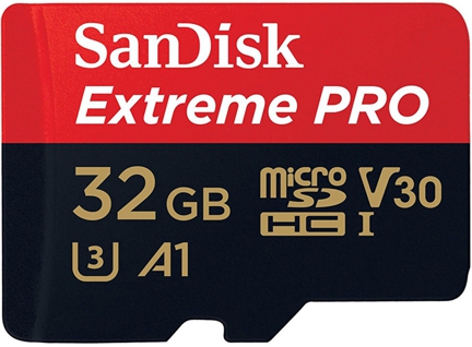

I use only the SanDisk Extreme Pro. 90mb/s write speed.
Never have any issues with them.
Extreme PRO microSDXC UHS-II Card | SanDisk

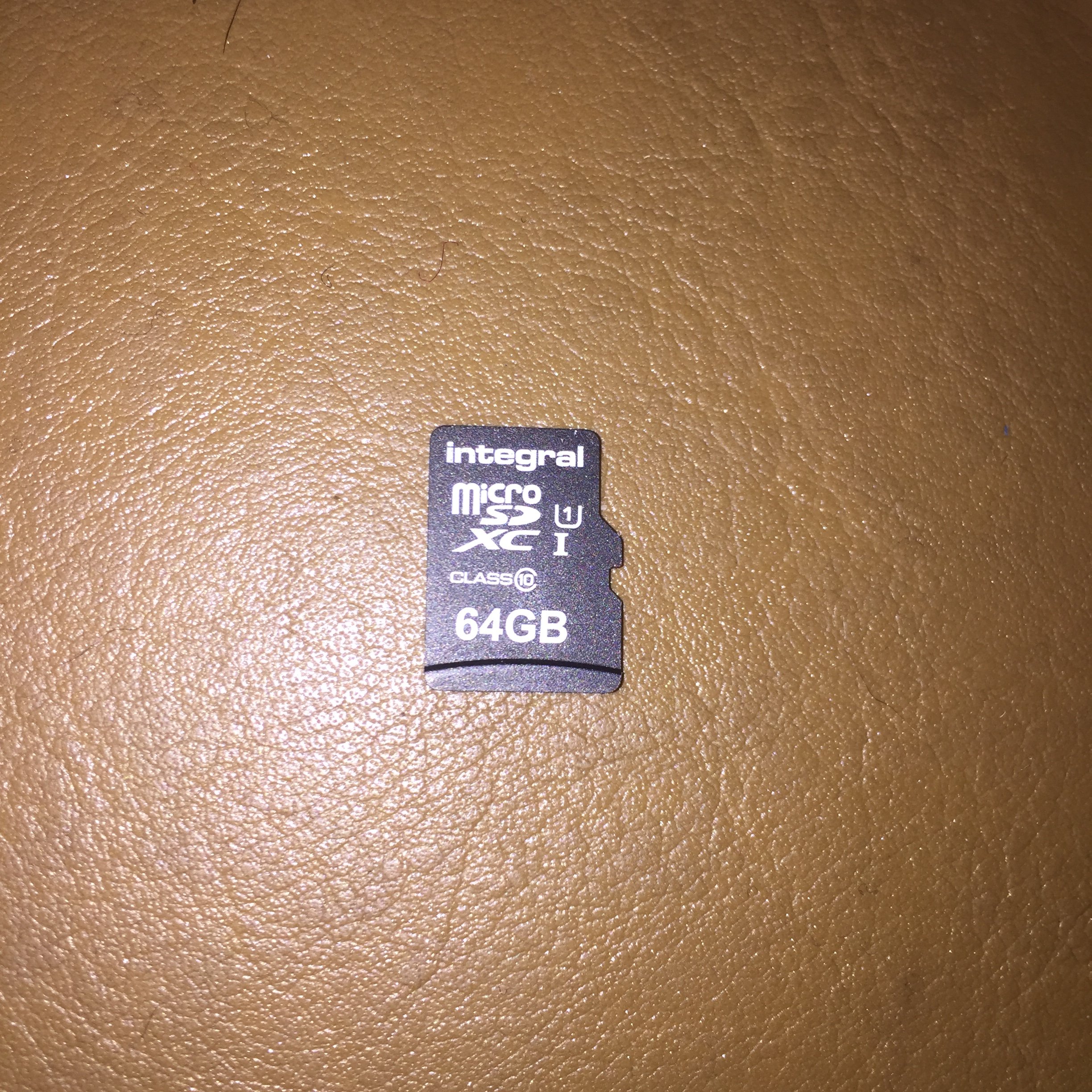

I’m using a Integral and it’s lagging and glitches on videos so I think I’m going to buy a better one

I think Mb and MB are getting confused. The 100 Mbps P4P camera output equals 12.5 MBps, which means many lesser cards will do the job. I've had no issues with SanDisk Extreme (non Pro) and the read/write speed is way more than needed. The price is much better for these cards, so if someone more knowledgable than me can explain the benefit to the SanDisk Extreme Pro I would be very appreciative.
