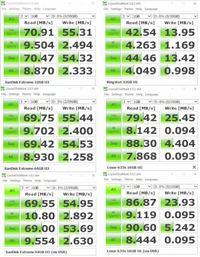

    I don't rely on the C10 rating anymore, prefering to use either U1 or U3 rated cards. The U rating is a classification for cards that is equal to, or exceeds the older C10 rate. Also, don't rely on the claimed read/write speed quoted by manufacturers. They usually quote the faster read rate, rather than providing both read and write speeds, which can vary widely.
    Here is a test I did on some of my cards recently. If you take the Lexar 633x which was supplied by DJI with my P3P, the difference is quite large and really surprised me. The 633x they use refers to a comparison with the speed of a CD (Compact Disc) for some strange reason and equates to (633 x 150/1000) = 94.95 MB/s.
    Also, your PC uses the binary system where 1 GiB = 1024 MB, and SD cards use the metric measurement where 1GB = 1000 MB, so the capacity of SD cards is also different. 16GB = 15GiB, 32GB = 30GiB and a 64GB card is 61GiB.
    Yaaay! I'm confused too, but here is a pretty picture to cheer you up. o_O

    Hmm that Lexar 633x card's sequential write speed is disappointing.

    Thanks for the info.
    Saves me time from even trying lol
