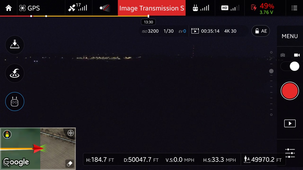

Fired it up and did a quick test, I live in a very very congested area and sadly never really got to test out in the open, so who knows if its better or worse, I did however do a high altitude run, and was able to get almost 2 miles before I brought it back, I still had full signal which was great, but I moved my remote I'd lose it, wish there was some sort of guide on how to aim this thing when you cannot see it, I usually do this at night so at least I can see the lights but when its that far lights wont even help. It was very windy tonight and when I reached that distance I had 50% battery and decided to come home, well I started to freak when all I could hit was 14-17mph :( I did make it back but there was a part of me that thought to just land it out there and drive to pick it up, lol
I made it back with about 24% battery left.

Two things. Boosted increases both the range and the penetration. Secondly, if you unlock the DJI GO map (so North is no longer up), the neon green line back to your Home Point will be vertical when the controller antenna is directly aimed at the bird. Rotate the controller until the line is vertical, and then keep it vertical throughout the flight. Good luck!

Im new to the quadcopter world and DJI but what do you mean by "Unlock the DJI GO map" ?
What he means is, see the map in the bottom right of my pic? There is a gold lock in the top right of the map. If you tap it, it will allow the map to rotate. If it is locked, it locks North as up/top
