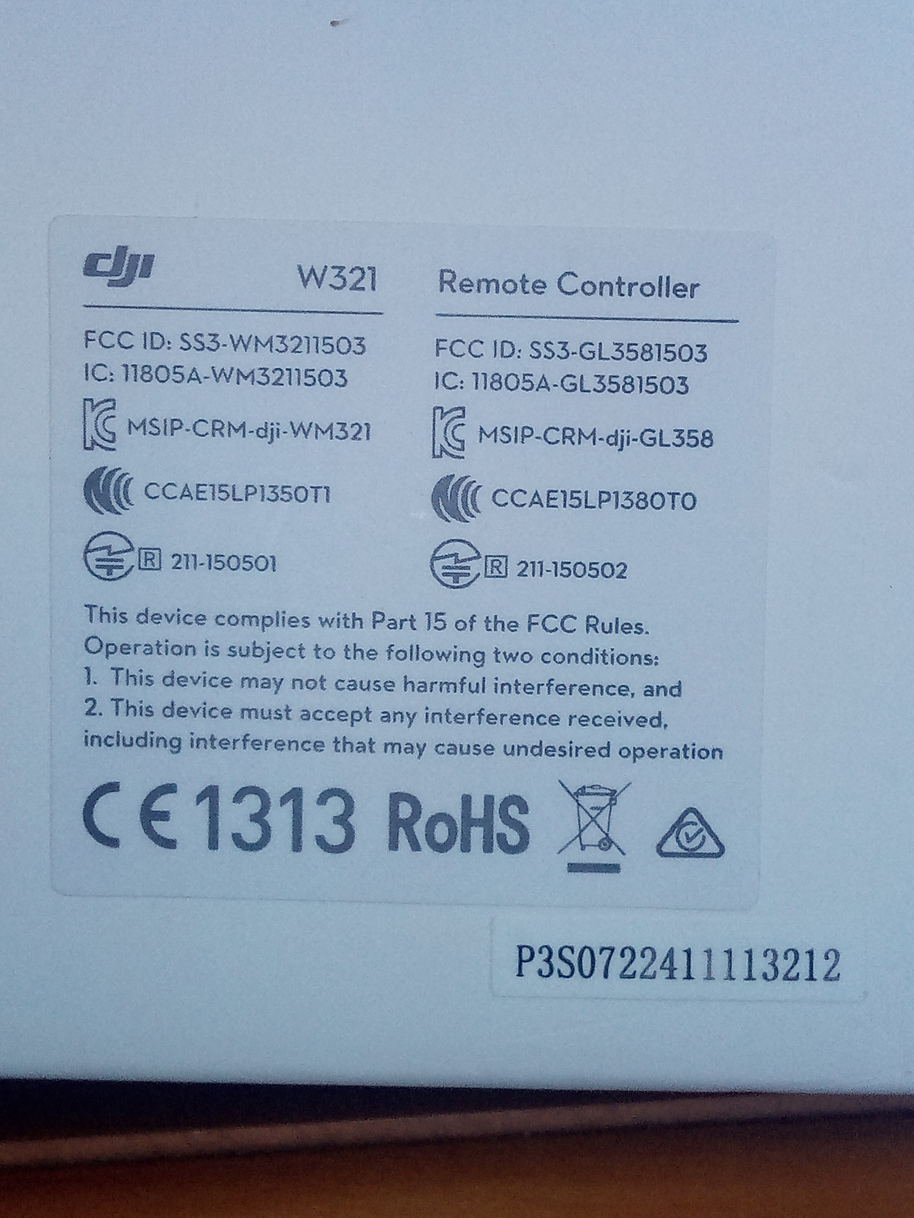

A P3P controller does not use wifi that way. Are you sure that you dont have a P34k and a GL358wB controller?

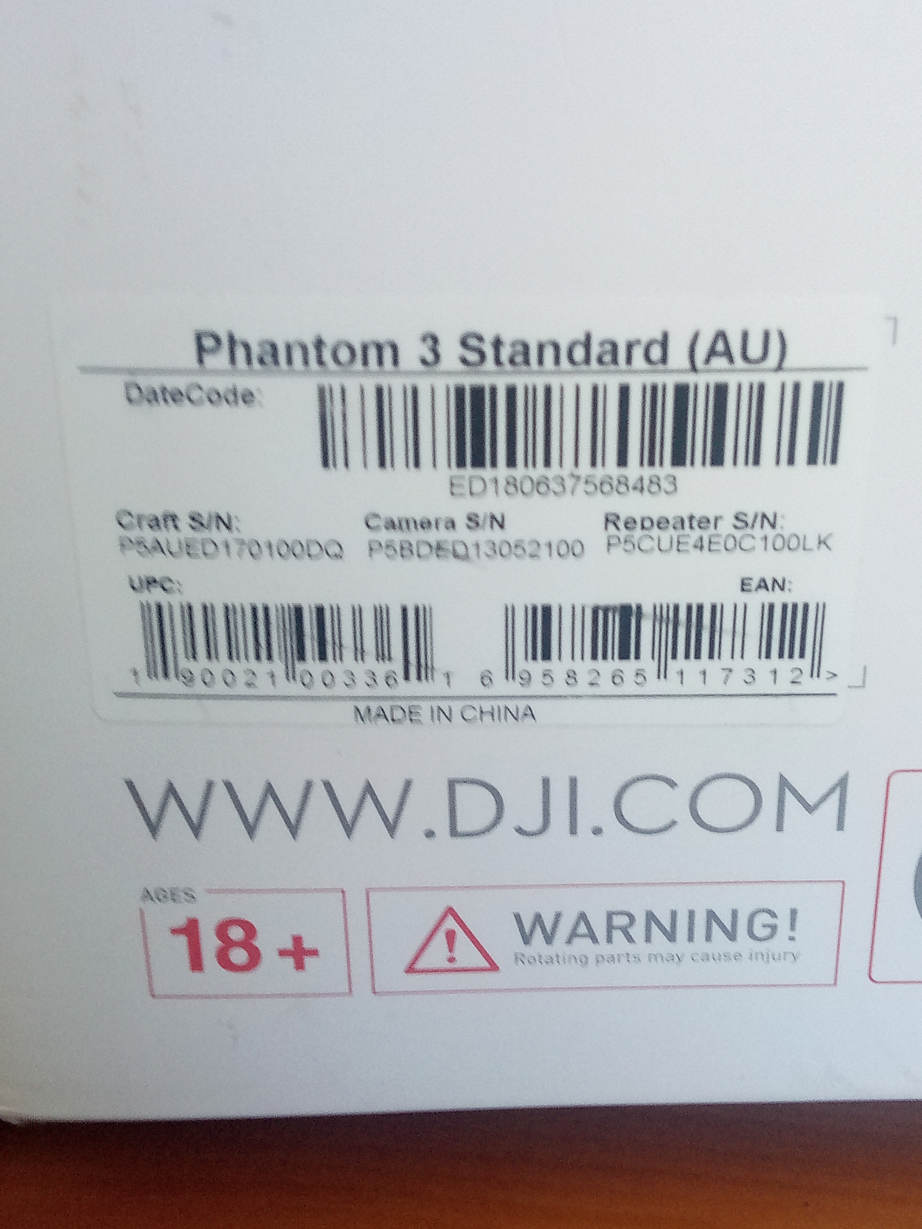

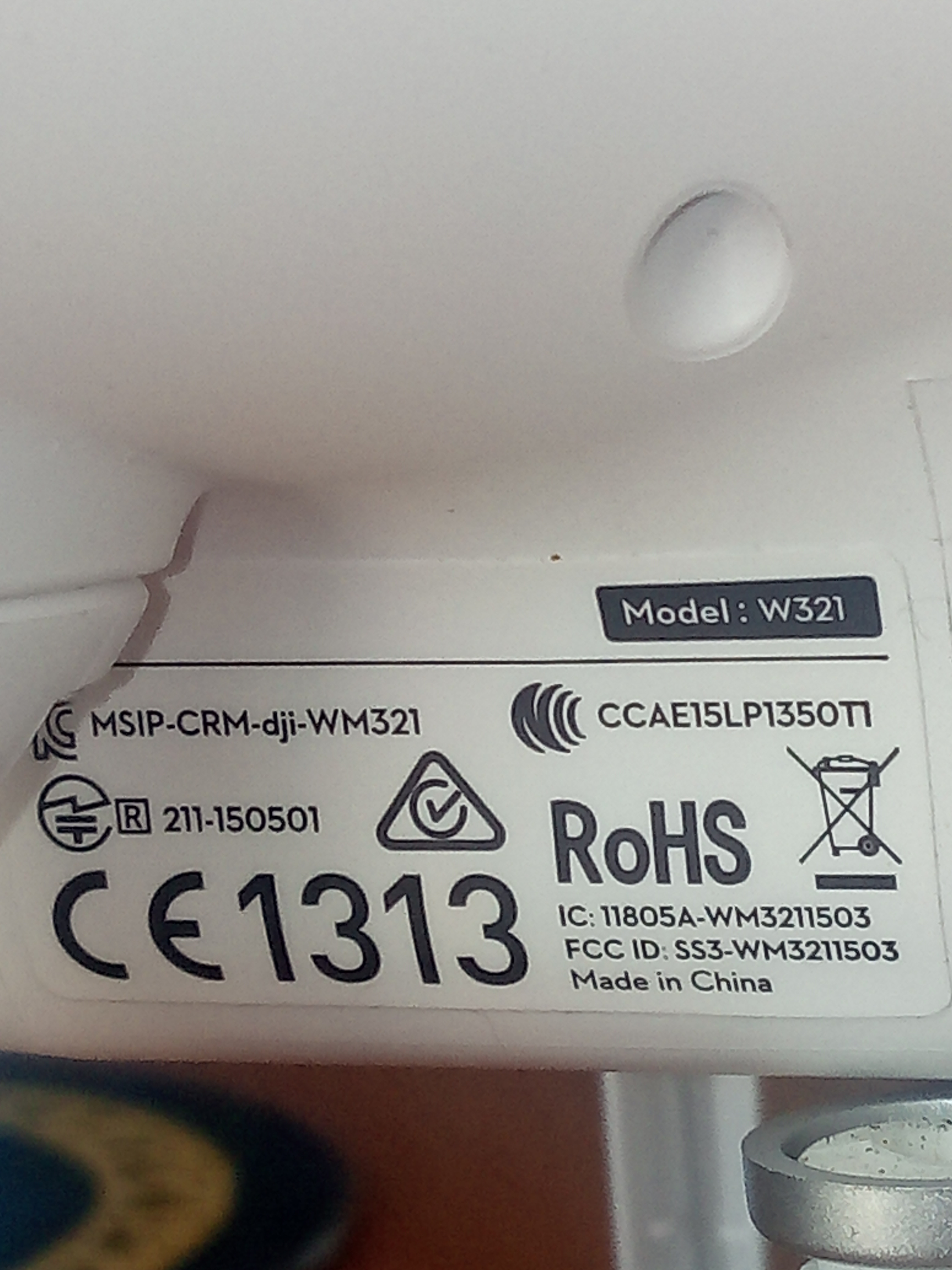

My controller is a GL.358wA photos off side of box & drone P3 standard The (AU) represents Australia. Even though I live in New Zealand some goods arrive via Australia.
