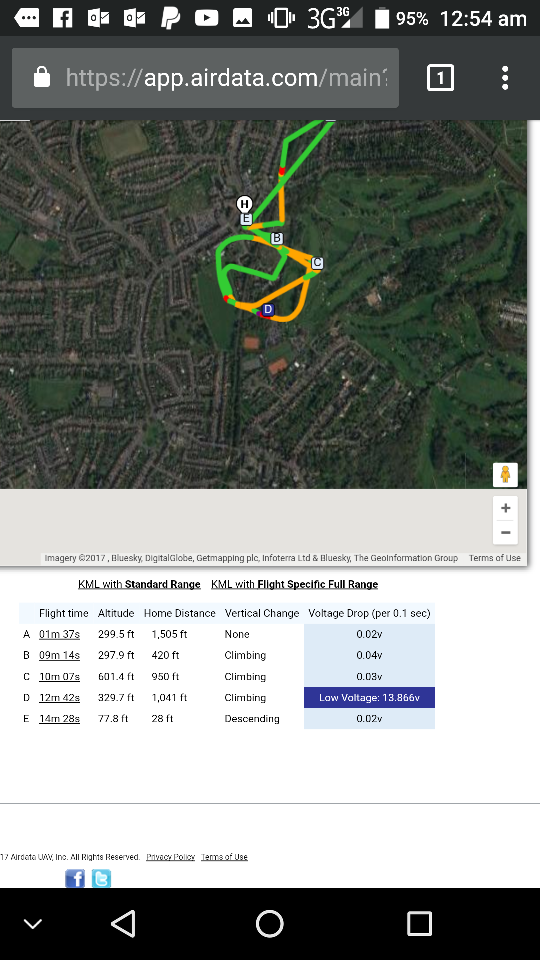

Low voltage... Is this really bad?
Battery seems fine, no major cell deviations and giood capacity for the cycle count. Voltage sagged during a brief period of high current drain. This is to be expected. You could avoid it by planning your missions so they execute with less aggressive altitude increase. If any cell drops below three volts in flight the battery will shut off in mid air.

Hi guys the last two flights I had with this battery I noticed it says low voltage. I am wondering if this is bad. I included a screen shot plus a link to the whole mission. Want to say that this was a litchi mission where I went out of signal for a few mins which will explain the long "signal loss" message. View attachment 86253
Airdata UAV - Flight Data Analysis for Drones
