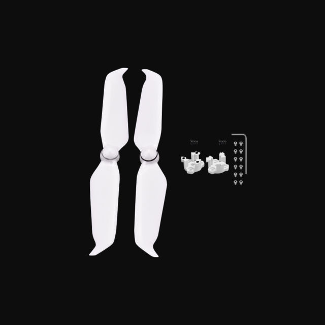

bought a batch of new 9455 low noise but find them unstable. The seller claims that you also have to change the paddle to work properly? anyone who knows about it?
s-l640 (1).jpg What I mean with paddle are the 2 small holders to the props, someone who changed them?

If you're asking if it's necessary to change these to use the low noise props on a P4P, the answer is no. The props are plug and play.
I find my p4p looking very unstable during anything close to a fast decent. It shakes like crazy on the way down.
Hey this is Phantom Rain, we did a lot of testing with the New Silent Props , We did find issue when breaking hard right at the end of the decent, but as you can see on the video if you go to 3:03 you can see how smooth it should be for you.
Is it likely that you were fighting the decent and than that would explain why you were getting chatter, something to consider.
