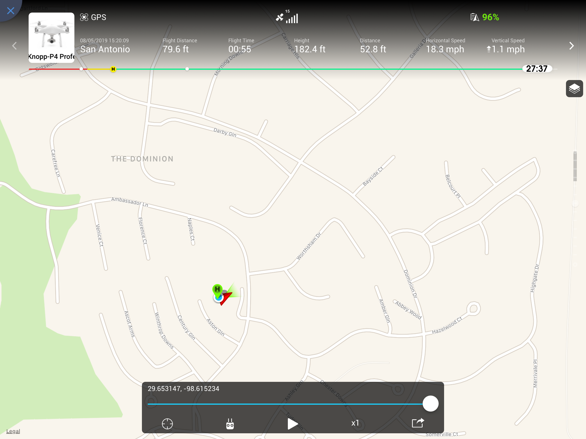

First question - is this the correct takeoff location?

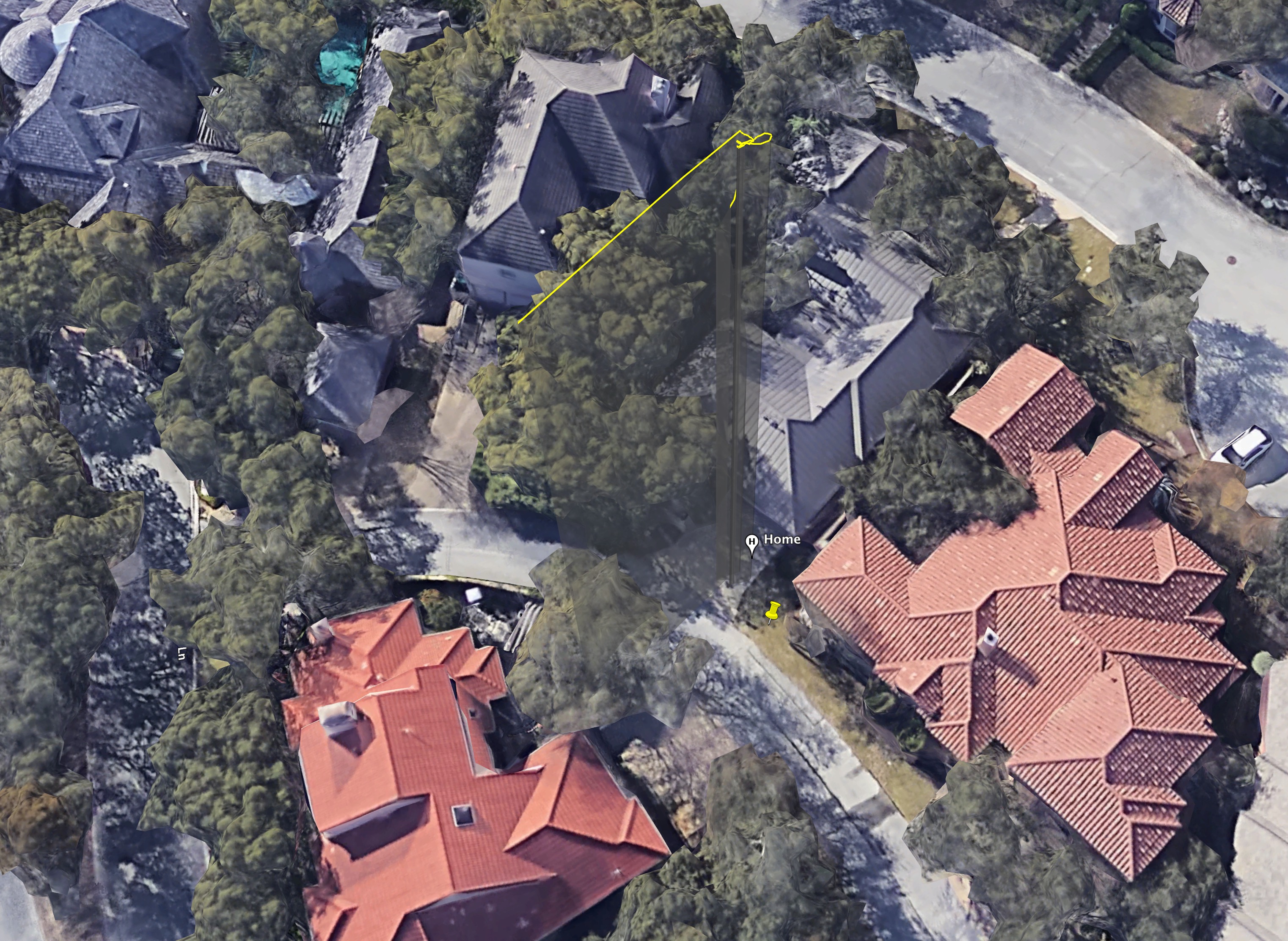

At the point when the log file ends the aircraft was 180 ft high and just 50 ft away laterally. You should have been able to see and hear it. Could you tell if it continued to fly in that direction, or did you lose visual and audible contact at that time?

I was looking down at the RC trying to see what was happening. From the last DJI screen it was headed east. In a straight line about .5 miles is a military base (camp bullis)

I know what the screen showed because that's in the log file. The question is whether you continued to see or hear it after it lost connection.

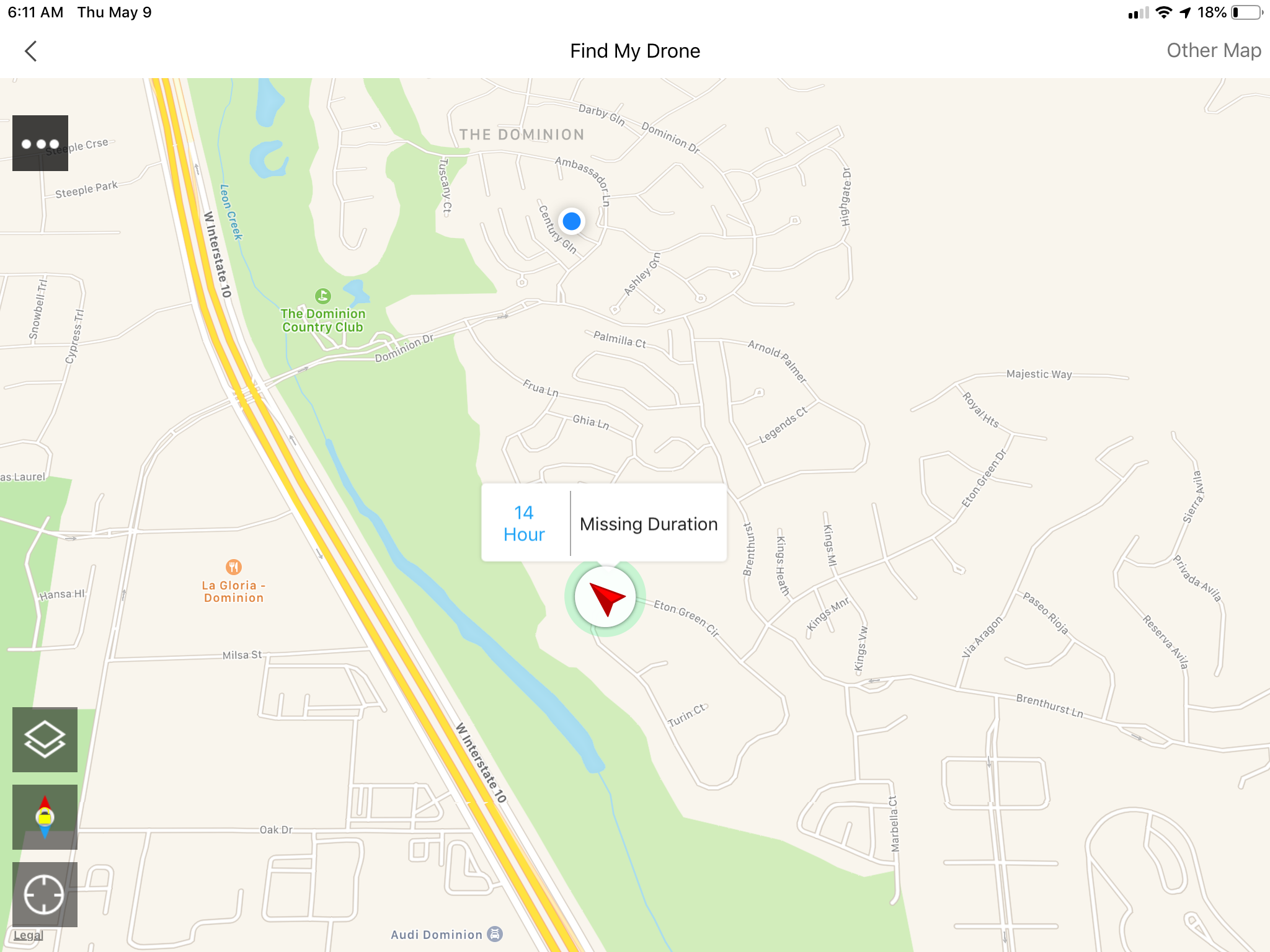

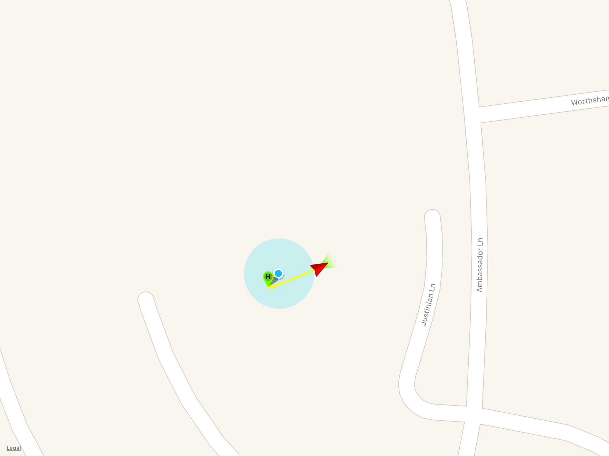

Does this map in Find My Drone provide a realistic expectation of where my drone ended?
Find My Drone usually shows the last known aircraft location from the most recent TXT flight log on the mobile device. Do you have a more recent TXT flight log than the file you attached above?
