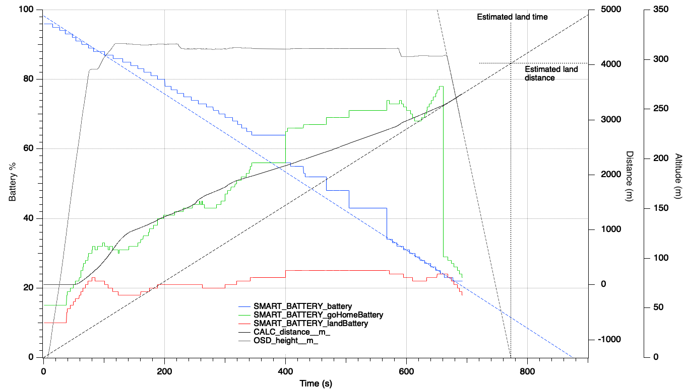

As noted above, the wind speed was the problem, 45 - 50 mph out of the SW at 1000 ft. Looking at the battery level, distance and altitude shows the following:
The good news is that after critical battery autoland was triggered at 660 s, there was enough battery left to land (as there should be). Estimating landing time from the descent rate and combining with the drift rate to estimate where it would have landed gives a further drift from the last recorded position of between 250 and 525 m.

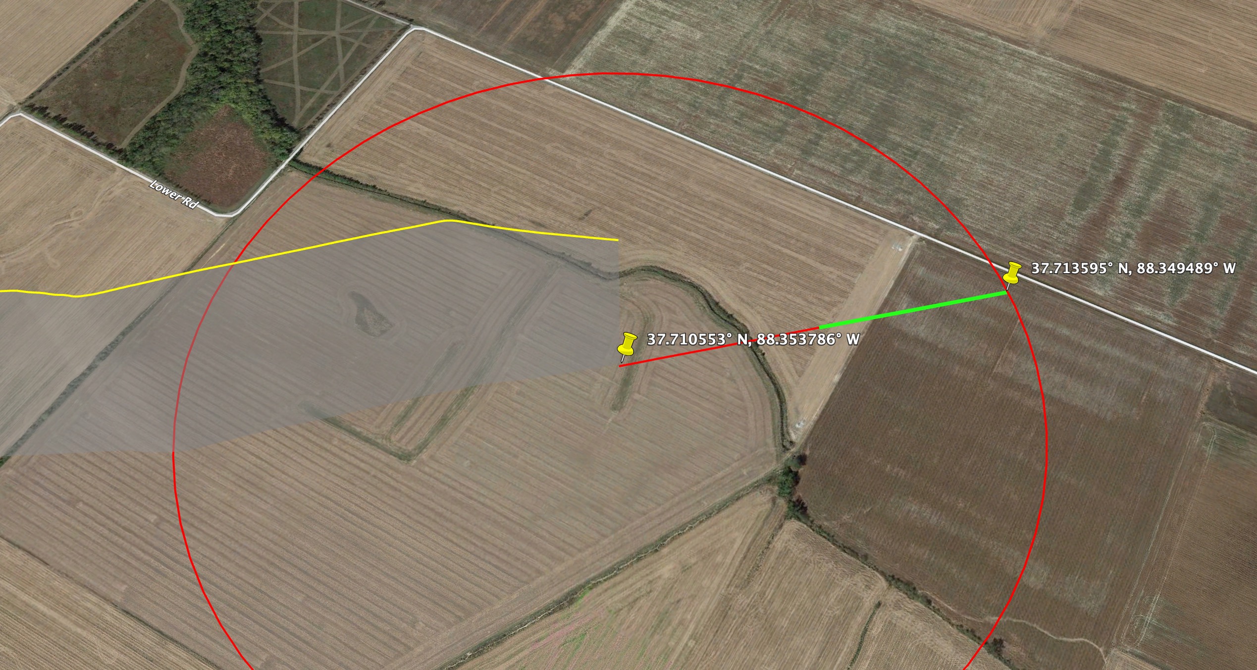

Looking at that in Google Earth shows the following:
It should have landed somewhere along the green line segment.
Probably precisely half way along the green line given the reliability of your log analysis.

Wow, thanks, thats pretty much where I searched, Most of the green arrow was thick soybeans that would have really hidden the drone. Will try walking that line tommorow.

I searched the field again this morning with a bright light from 5:30 to 6:30 when I had to go to work. No luck. Sadly it rained heavily all day and will rain heavily tonight and tomorrow. I am 90% certain it's not on the green line, but a bit ahead of it. I believe as it lost altitude the wind was much weaker it began a more straight down descent. Winds close to the ground were maybe 10-16 mph in teh fields while I was searching for it.
The red section of the line crossed a growed up drained ditch you can see on the map. Around the ditch is heavy brush and the soybeans are really thick there. You can't see at all. I think that area is where it went down.
