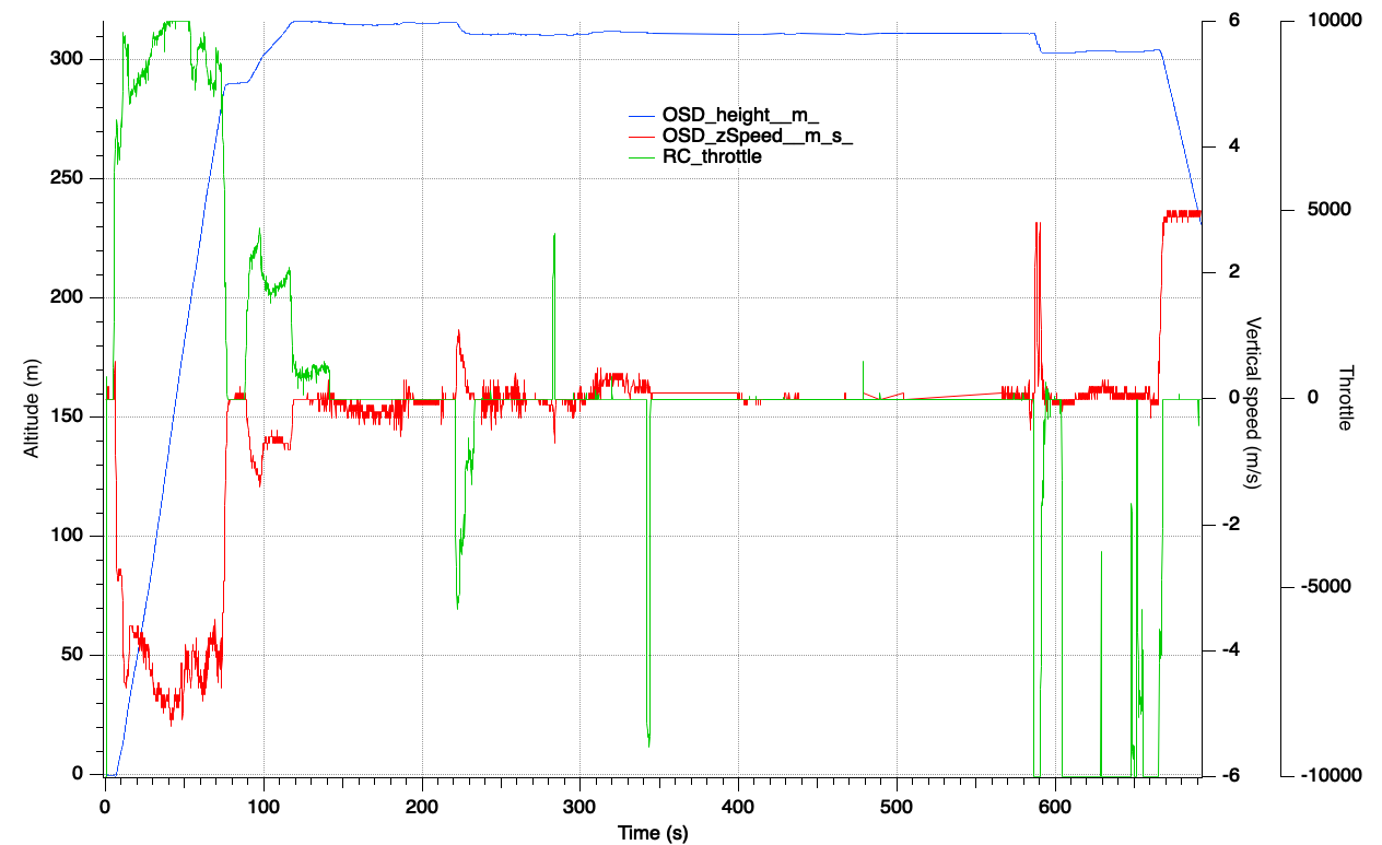

The data shows pretty clearly that pushing the left stick full forward for long enough was what took the drone to 1000 feet.
After that the wind did most of the controlling.

The flight data is full of indications of a strong wind.
Look around 9:47 - in RTH the drone was going backwards at 18 mph while trying to return home.

Looking at the log the aircraft was climbing from takeoff, the stick input data shows it was climbing vertically climbed well past 400ft AGL 2ft. away from the point of takeoff. One minute into the flight it was at 738 ft. and 134ft. away from point of take off. Wind will move a multi-rotor aircraft horizontally but I've never seen any weather phenomenon that would literally lift a 3.5lb object almost perfectly vertical up to 1000ft.
I don't understand your comment. There is nothing unusual in the log profile of the climb. Maximum climb rate was around 5 m/s under full throttle.
Sorry my post is confusing, but yes, basically I agree that the pilot deliberately climbed to 1000ft (which he had no business flying above 400ft. AGL, but we can save that debate for another thread). The wind did not lift the aircraft aloft to that altitude.
The post I quoted alluded to that the wind caused the aircraft to ascend to 1000ft. which is not the case.

Ah - got it. I should have followed the post trail more carefully.

Wow! That's an impressive log. Are all flights recorded in this way or does one have to set something up to enable it?
