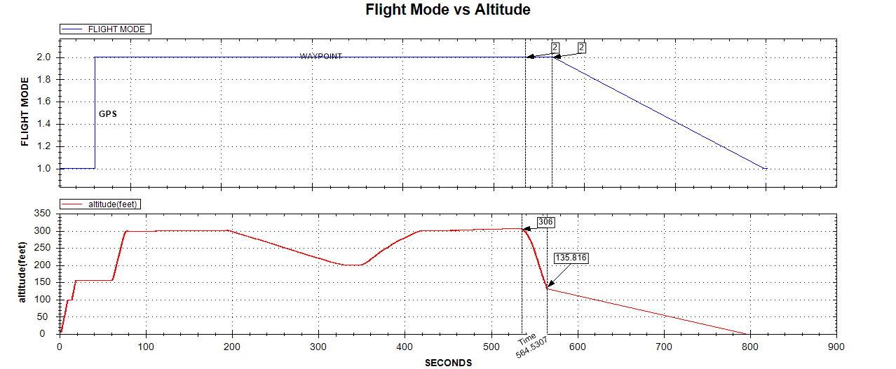

This is a bit baffling. I do not yet see a reason for the loss of altitude. According to these charts, the aircraft was still in waypoint mode and started loosing altitude. It's hard to say if this was before or after missions end.

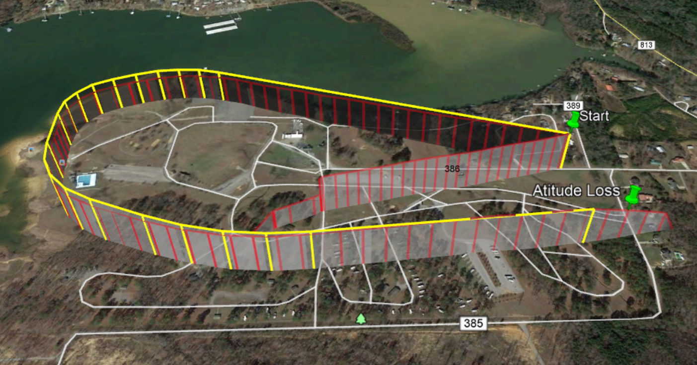

Just for the sake of putting this up. Here is your Litchi Flight profile( In Yellow ), with the Actual Flight Profile( In Red ) over layed on top. All smooth until the end. Still baffled about the altitude loss. It makes no sense. Glad you found it.
If you plot altitude against distance rather than time, and show the actual data points rather than just the interpolated line, then it does appear that the most likely explanation is that there was another waypoint added prior to upload. The loss of altitude approaching the last intended waypoint is due to the smoothed altitude transitions.
