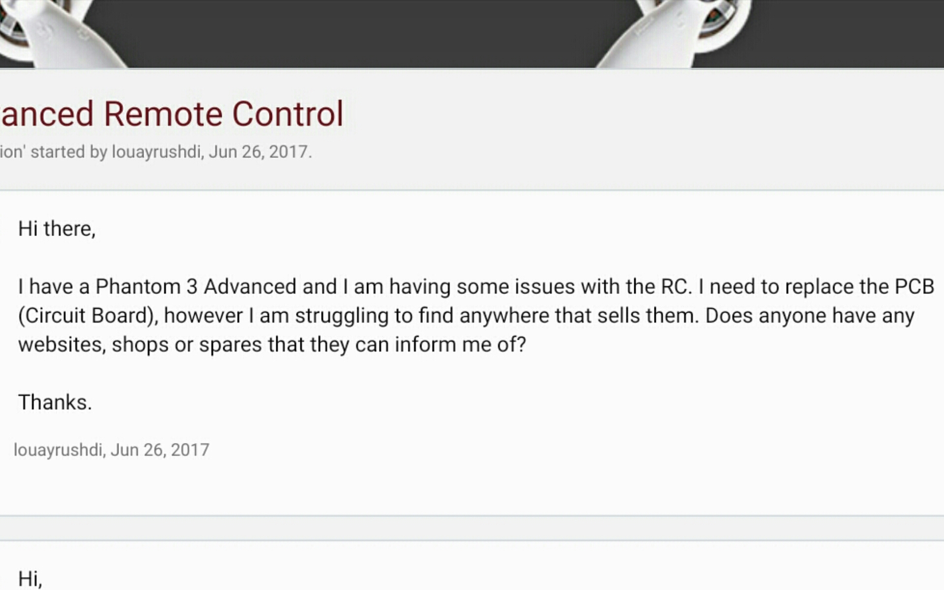

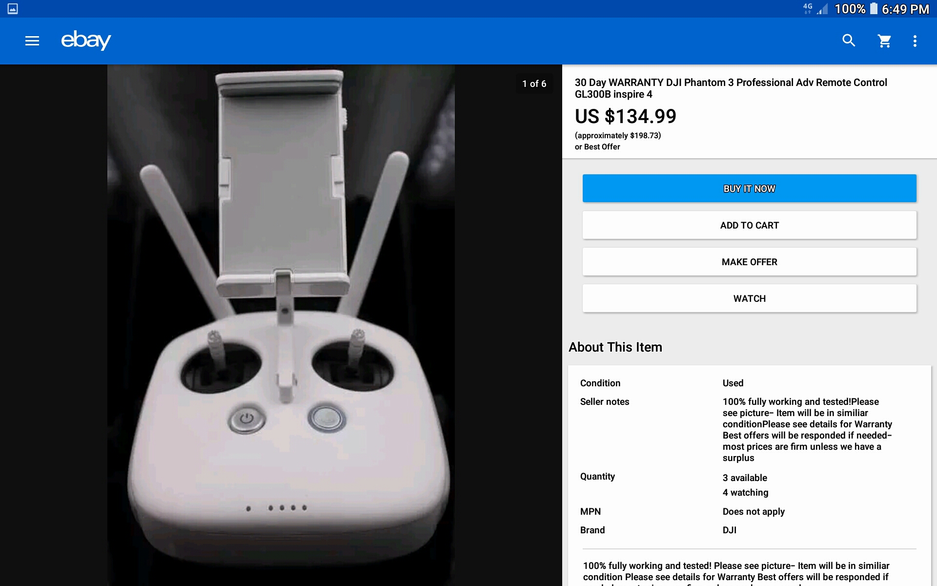

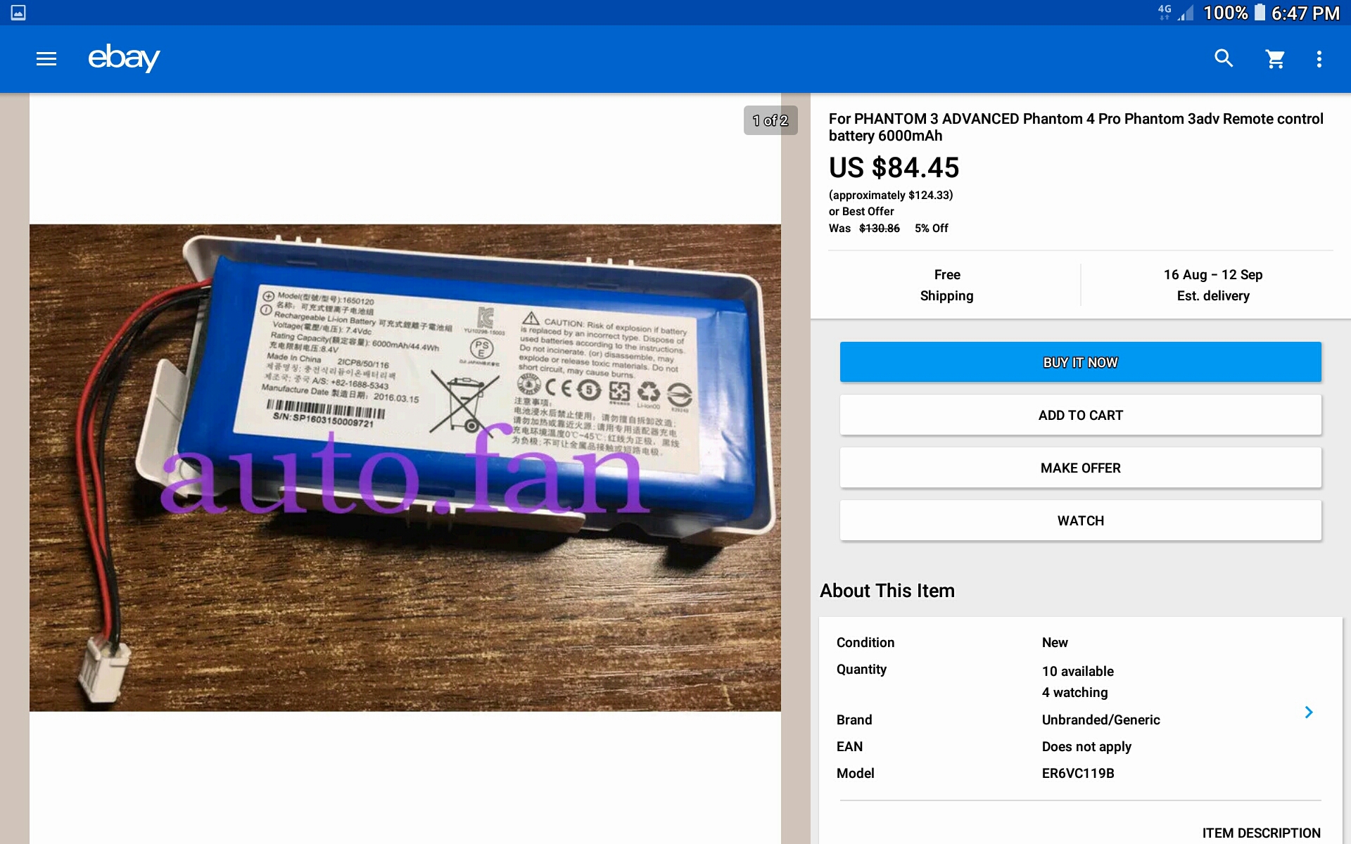

Man what a tricky thing to find info on but did find this old post describing the remote PCB circut board,,2nd pic shows replacement battery currently on ebay,,3rd pic is good used remote if nothing else turns up,,,I would first look into the remote board as reading a lot the finger points in there,,,I think your call if you want to spend $$$$,UNLESS someone else in NZ got a p3a remote not doing much,,prefer free just to help this poor chap fly,,come on more good deeds :)

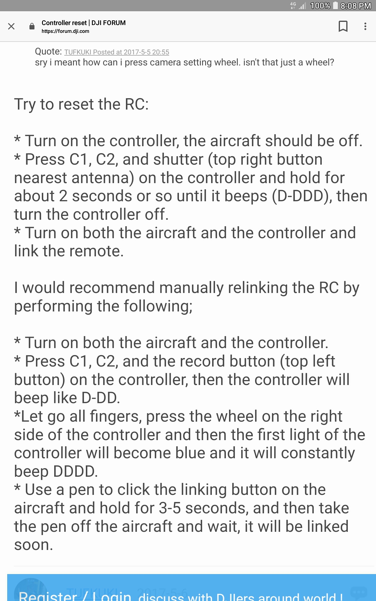

Found this rc reset,if works you have to redo your custom setting,,I been searching for ages but hard to find any info
,,,,,forget my remote I offer it won't work,,others might work but mine got gl358wb which not compatible
Here's another couple pics of battery info,,not sure why this below says 8.3volt,never herd of it but bottom picture of p3a remote specs say 7.4 volt,below where says click and hold,try that method,other says you can force it into charging mode,,hope this bit more help,I'm still looking around................
Ok the disparity of voltage quotes ...
7.4V is the nominal voltage of a storage level 2S pack. Full charge voltage is actually 8.4V based on max charge level 4.20V per cell. In practical use you will find cells drop back a touch of the charger and 8.3V is a more realistic figure.
There is nothing wrong with the info in the links you gave.

Found this rc reset,if works you have to redo your custom setting,,I been searching for ages but hard to find any infoView attachment 101911,,,,,forget my remote I offer it won't work,,others might work but mine got gl358wb which not compatible
Tried this several times nawww , I’ve packed it away until I can either find another solution or another RC THANKS one and all
