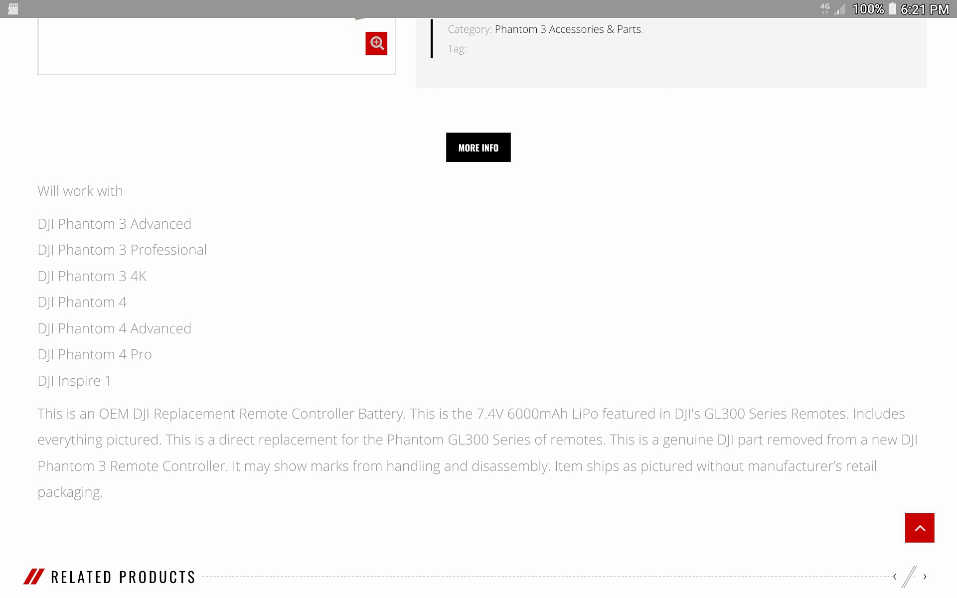

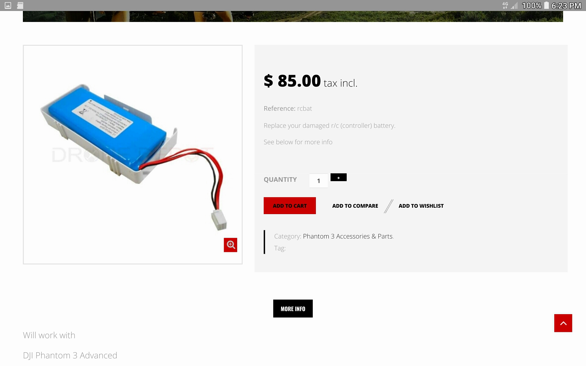

Hi hey just did search and you have already got the replacement battery looking at picture,,these details for one you have so one I send should workView attachment 101859
Thanks for that I wasn’t game enough to throw it in before this post now it’s in and I have one bar charging crossed fingers wish me luck

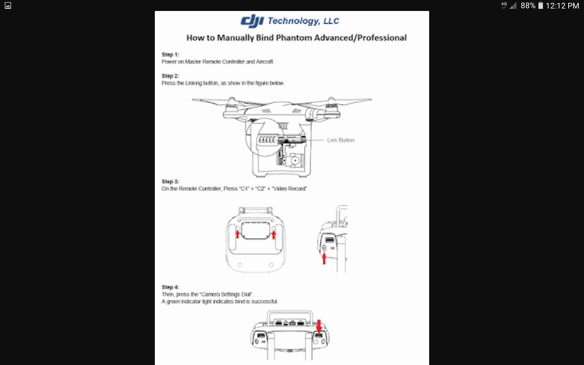

Ah that's not nice,was waiting for good news,rc light flashing red could be couple things but to me it sounds like re linking aircraft and remote is needed,got good fingers for stretch on remote,this manual relink for when djigo app can't conect (other linking method in app), not sure on the charging cause battery was good ,just need to have a search on that see what I find,,,also how many white lights come on when remote on off button pressed and held just once not twice to turn on

Just went by your battery info for part number here is what DJI came back with then I followed out to someone who had it in stock for the same price. Buy DJI Focus Battery For Remote Controller - DJI Store
add: there are video's on how to change up the battery on you tube.
The DJI Focus battery is for a HandHeld camera gimbal ... NOT the P3P controller ...
I am well aware of replacement batterys for P3 controllers ...
The DJI focus battery is a 3.7V ( 1 cell ) 1700mAh pack for an external gimbal.
It will not fit - it will not have enough power or voltage for a P3A or P3P controller. It may power a P3S controller IF you can get the plug to fit !!

Ah that's not nice,was waiting for good news,rc light flashing red could be couple things but to me it sounds like re linking aircraft and remote is needed,got good fingers for stretch on remote,this manual relink for when djigo app can't conect (other linking method in app), not sure on the charging cause battery was good ,just need to have a search on that see what I find,,,also how many white lights come on when remote on off button pressed and held just once not twice to turn onView attachment 101861

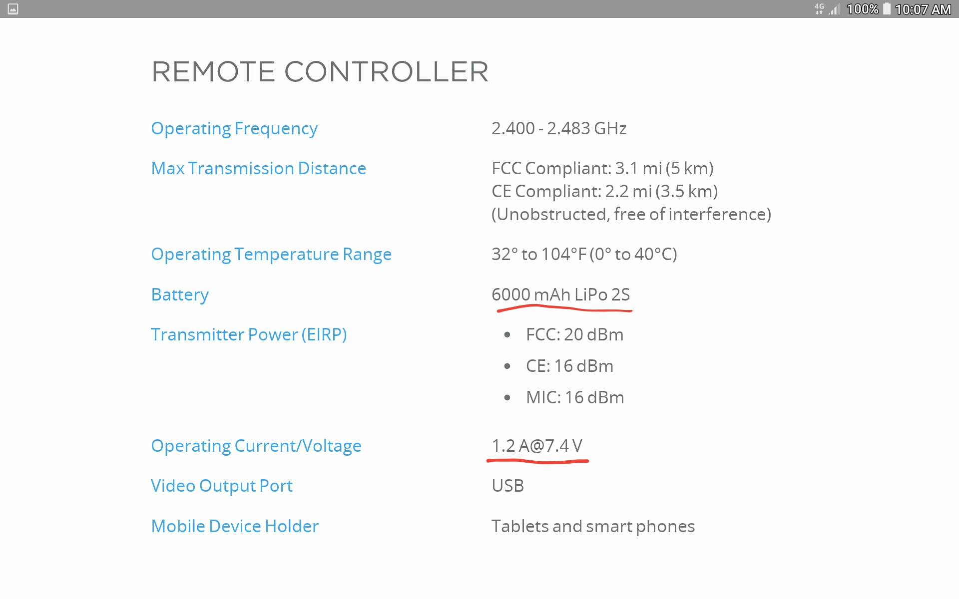

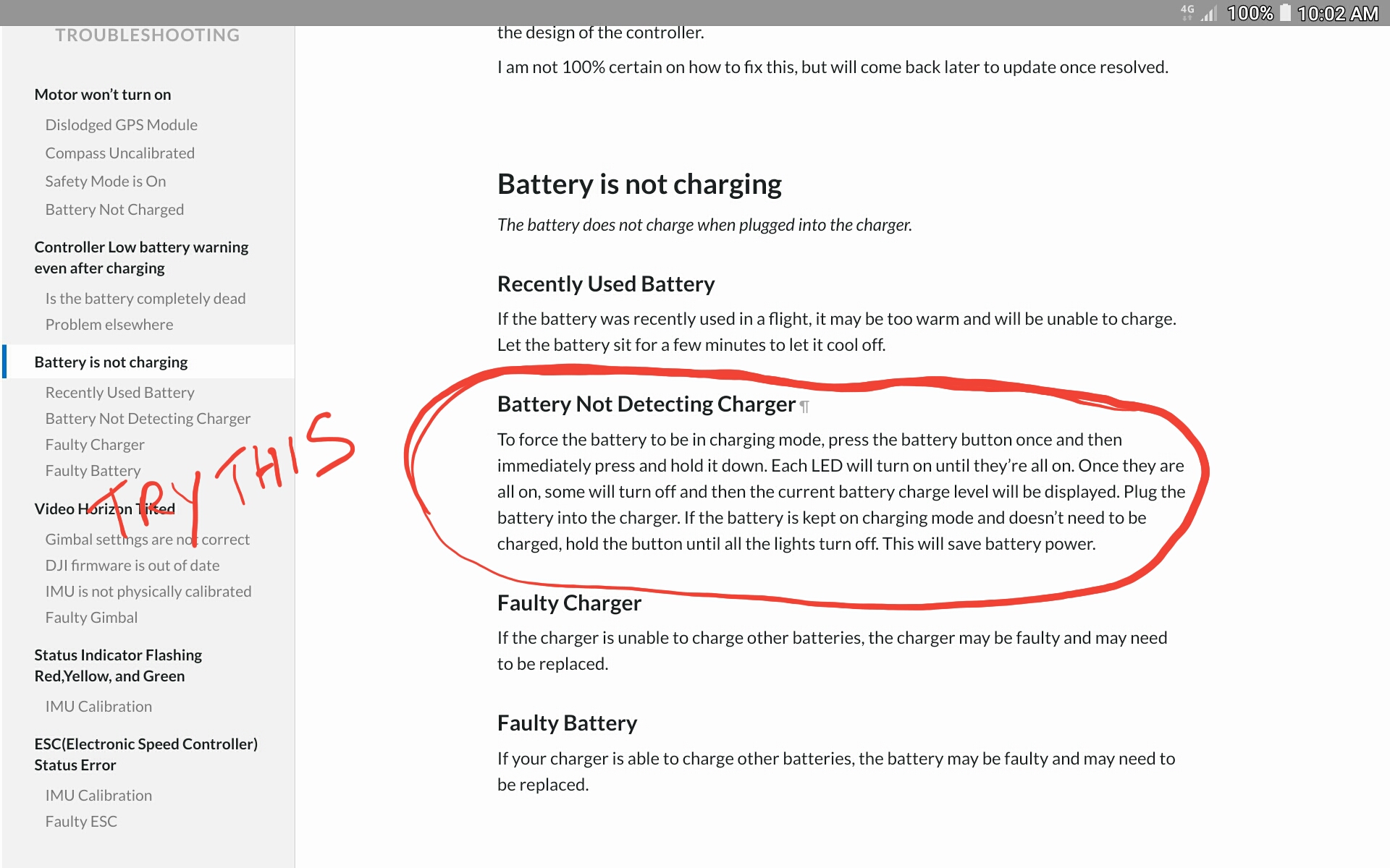

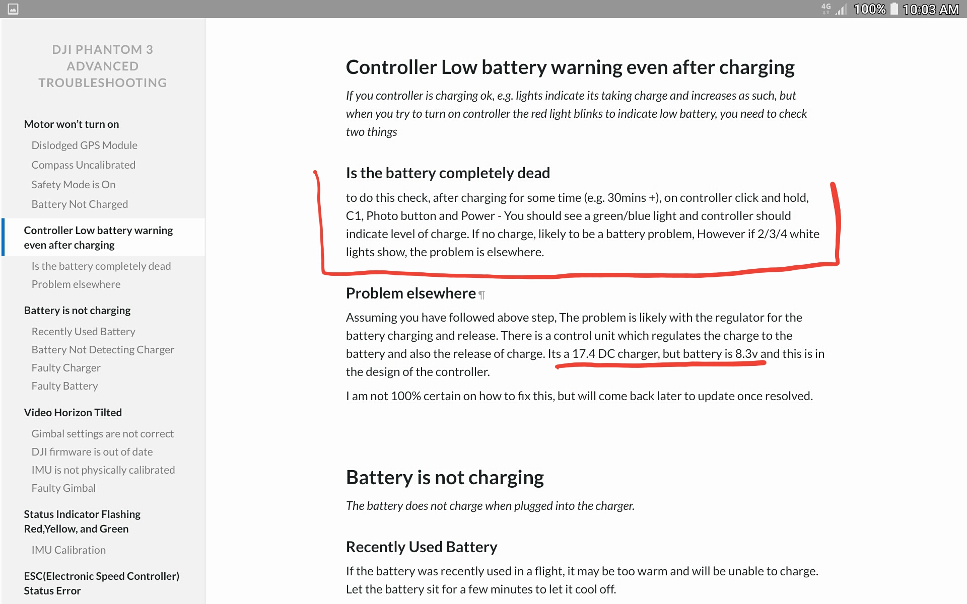

Here's another couple pics of battery info,,not sure why this below says 8.3volt,never herd of it but bottom picture of p3a remote specs say 7.4 volt,below where says click and hold,try that method,other says you can force it into charging mode,,hope this bit more help,I'm still looking around
fyi

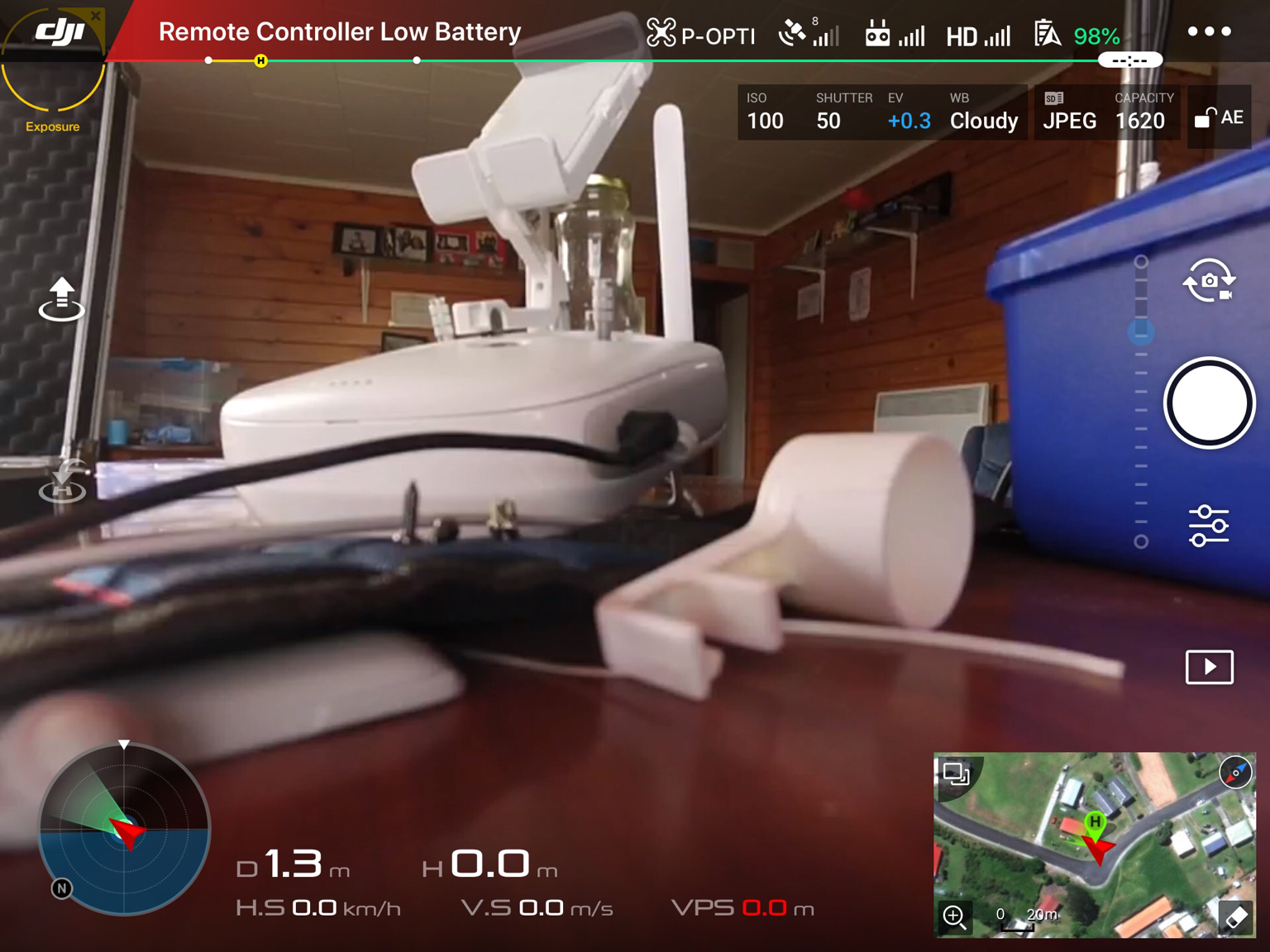

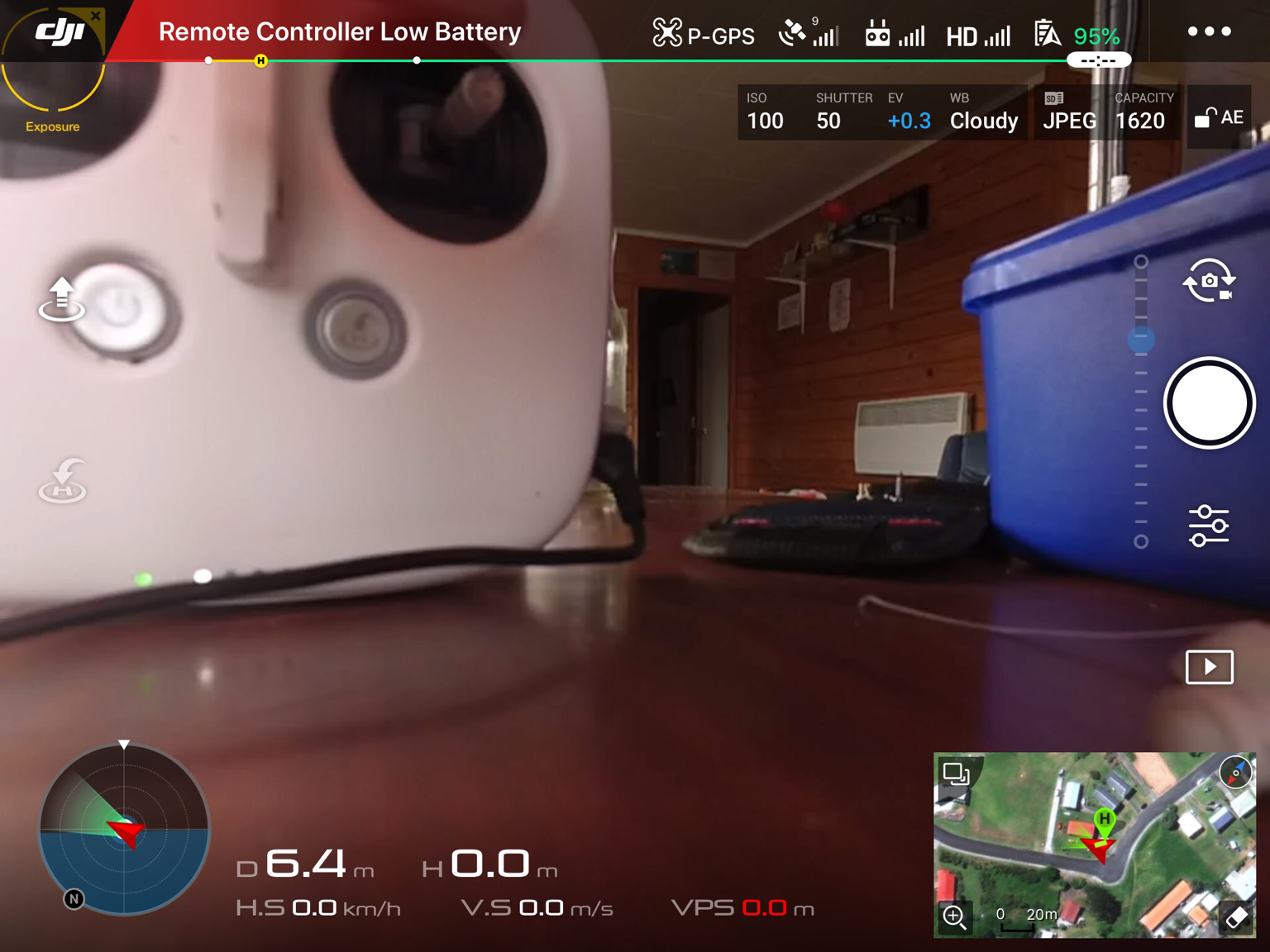

Green light one white light flashing connected to app says battery at 4%
View attachment 101895fyi

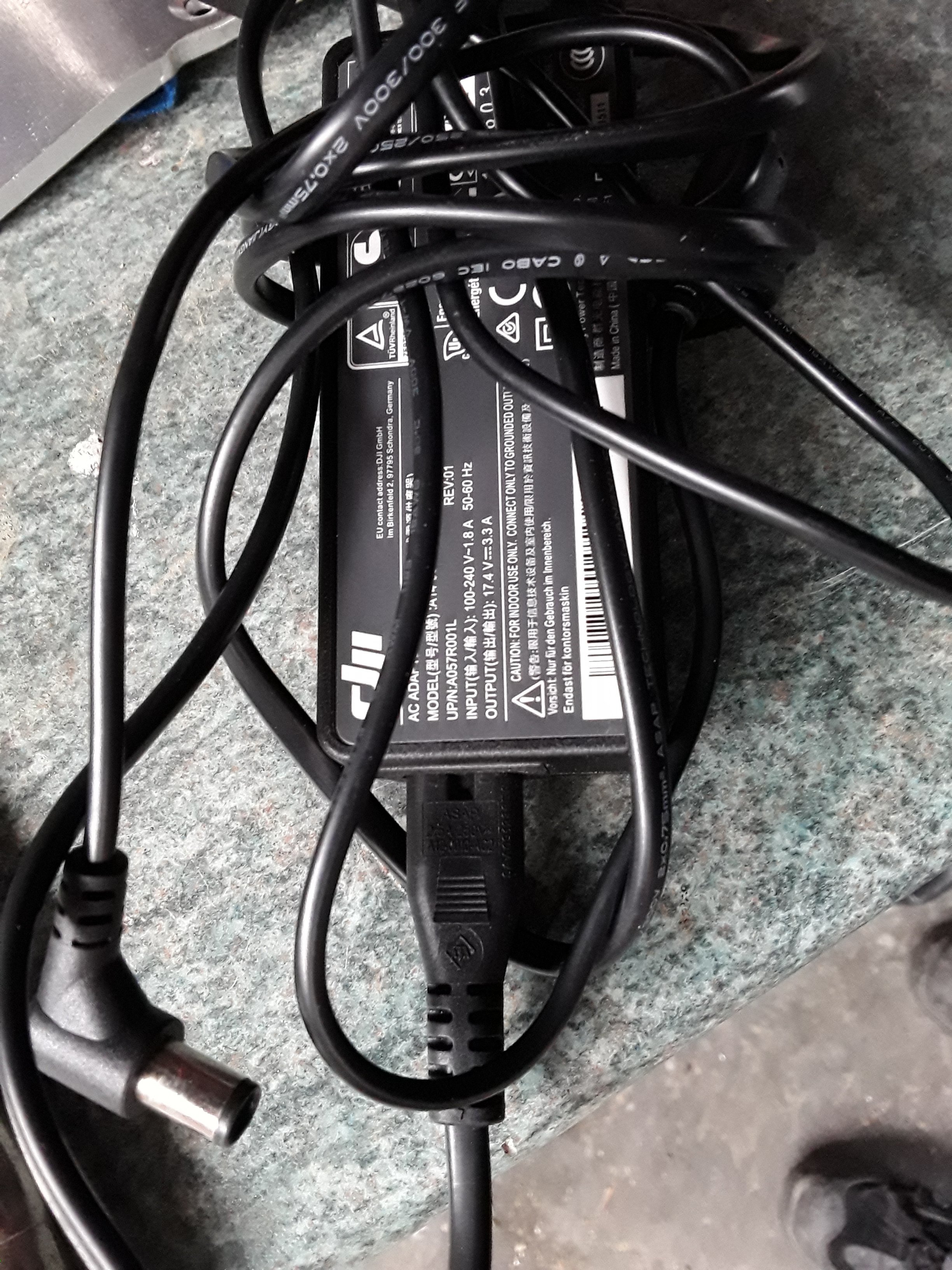

ok 30 min at 4% will be dead by now,,yes check with multimeter, I was going to send you my charger and another p3 battery but sure that one is good,

TRY THIS = thanks Again I tried the c1 combination with photo and power button and 3 lights illuminated

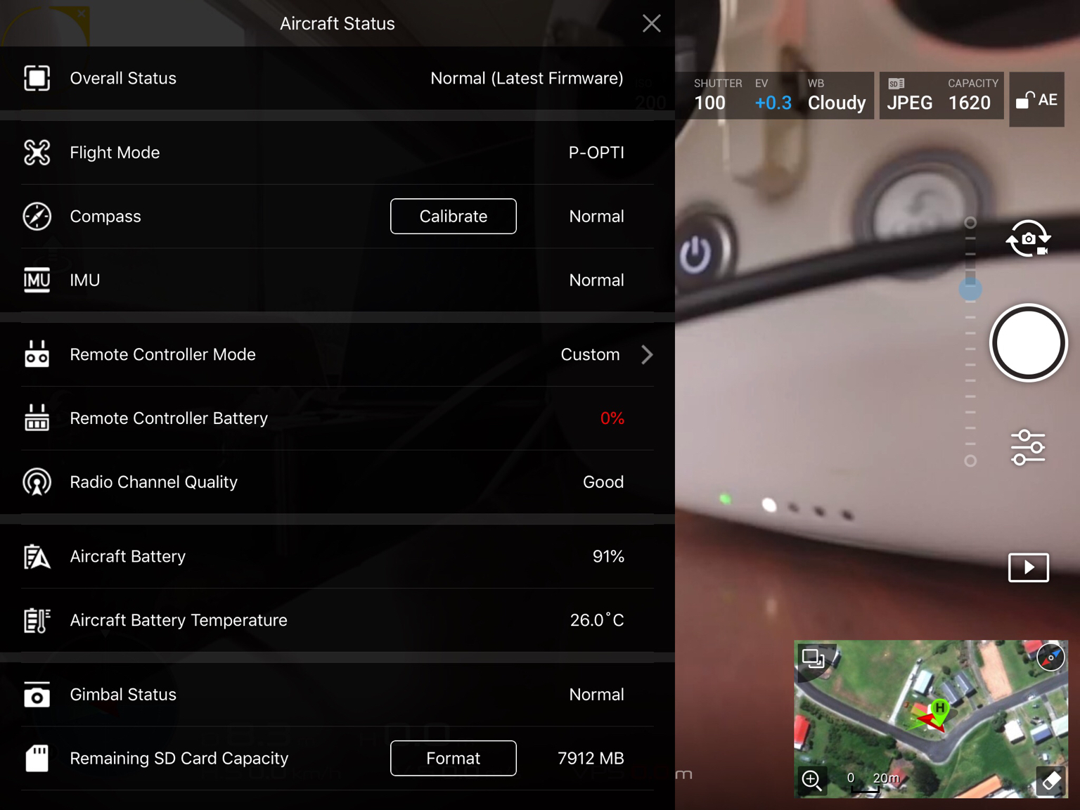

OK good it flashing it might doing its thing,,if it does not charge or change I send my charger and fully charged battery, just a tip , pays not to leave drone on to long or camera gets bit hot,,what other settings you got on your remote controller settings,I see its on custom,not seen that before,,,also I find very odd is that battery remote reads at 0 ,

I have customised the controller to my preferred way, I made it the same as the digger I drove for years that’s all it is
According to your post ^^^^^ with your red markings it says
The three lights illuminated suggests that the problem is not in the battery but elsewhere I never got a Green blue light also
I am leaning toward the RC itself as the drone battery are charging as per usual so I don’t think it’s a charger problem but thanks for the offer you have been awesome
