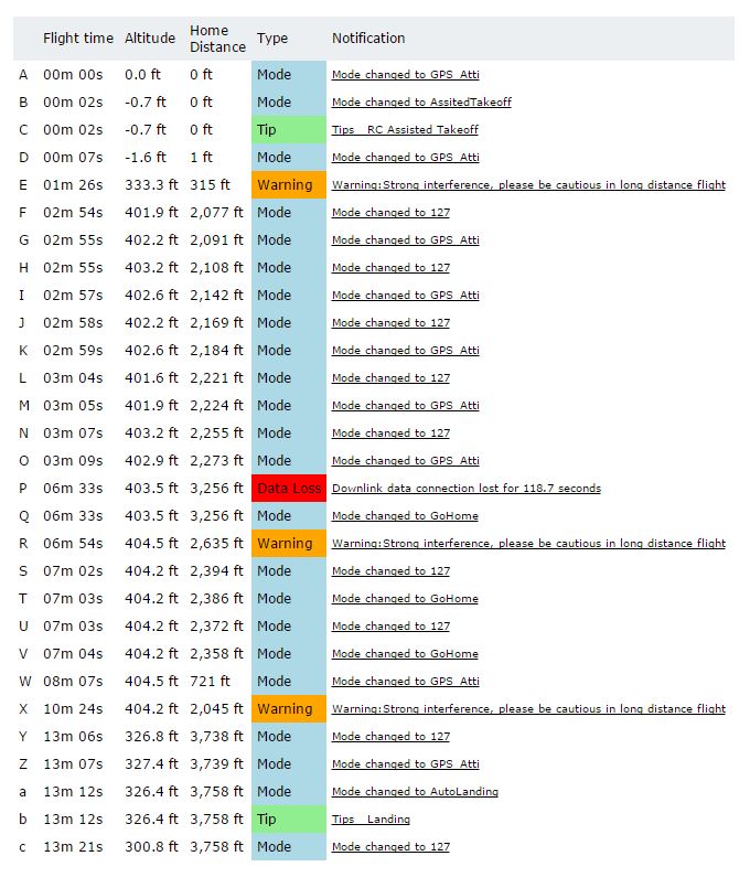

Curious at 315 ft away it said "warning interference" and you lost connection at 3200+ feet? What part of warning didn't you get?
Thanks for pointing that out, I must have missed that. I'll be sure to pay more attention to those warnings in future. Is that why RTH failed and the drone auto landed?
So I just lost my drone. Looks like it auto landed in the middle of the lake after losing video and control. I definitely did not tell it to land. Home was set correctly as it had already partially come home once. Obviously this one is a lost cause but as a learning experience, can anyone suggest what went wrong? Would the interference warnings cause it to auto land when I lost contact? I would not have thought so. Feeling pretty sad right now. :-( Opportunity to get an advanced though :)
