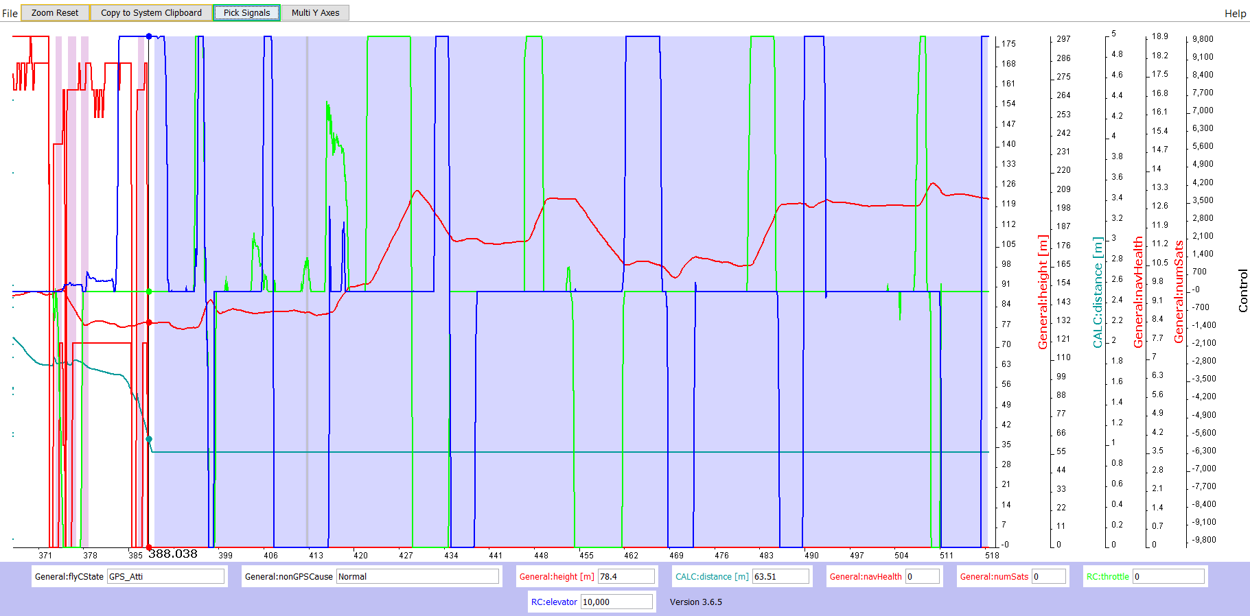

Sorry for the late reply - I somehow missed your post. That's the file. The GPS data were recorded. Below is what the aircraft did up to the point of disconnect:
111227

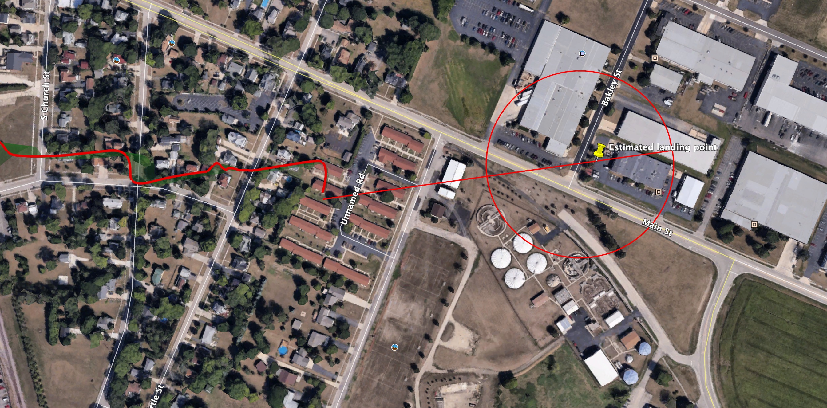

At the disconnect it was around 125 meters AGL. It was in ATTI mode so the disconnect should have immediately caused the FC to initiate autoland. At a descent speed of 3 m/s that will have taken around 42 seconds. The wind was blowing the aircraft on a heading of 58° at around 9 m/s, and so, taking into account wind speed reducing with height, it should have travelled another 300 meters or so. That puts it somewhere as shown below:
111228
Note that the hook at the end of the flight track is because you were intermittently applying stick control. I'd look along the red line, starting at the marker. The circle is a fairly generous error bound - it should be well inside that.

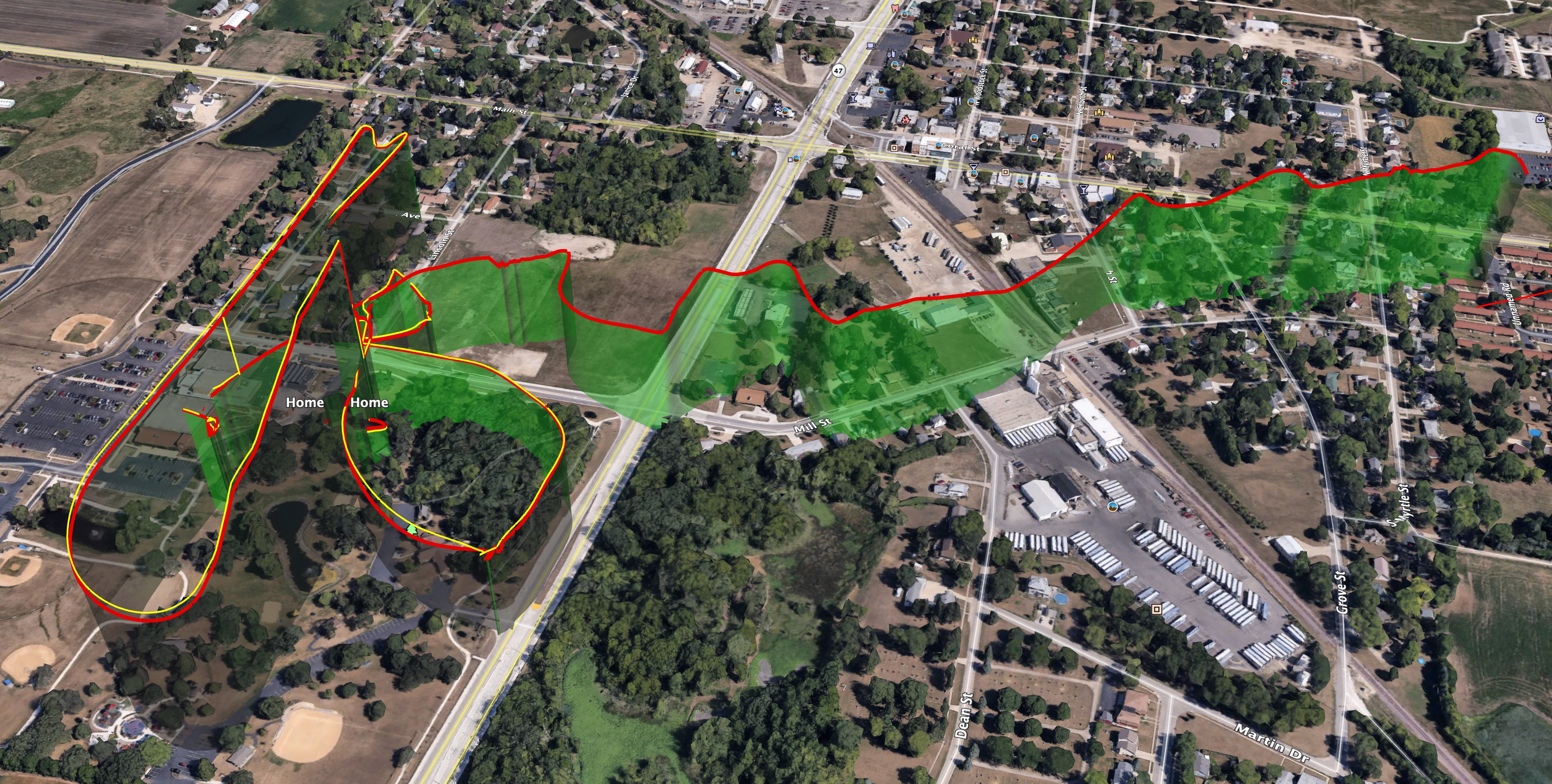

From 6:35 to 7:09 you pushed the left stick forwards 5 times for 2 to 7 seconds which was responsible for taking the drone from 251 ft to 408 ft.
In atti mode the drone can drift with wind (if you let it) but you still have control although the flight characteristics are a little different without brakes and position holding.

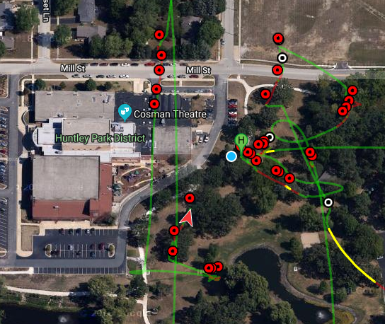

3) When the downlink dropped and you lost the live feed in DJI GO, the green light on the remote controller would have been a sign that the remote controller was still connected and controlling the Phantom. Powering off the remote controller would have made it auto land about 184 feet from the home point around its location here:
111333
There were a lot of trees in the area, so this would have been the least ideal scenario. And you would have had to use the DAT flight log to locate the possible landing area (like @sar104 did above) if you weren't able to see your Phantom when it landed.

I'm fairly confident (> 90%) that it would have landed in that circle, with a strong bias towards the center where the pin is shown. The wind field was reasonably steady and these aircraft have proved to be quite predictable in such situations.
