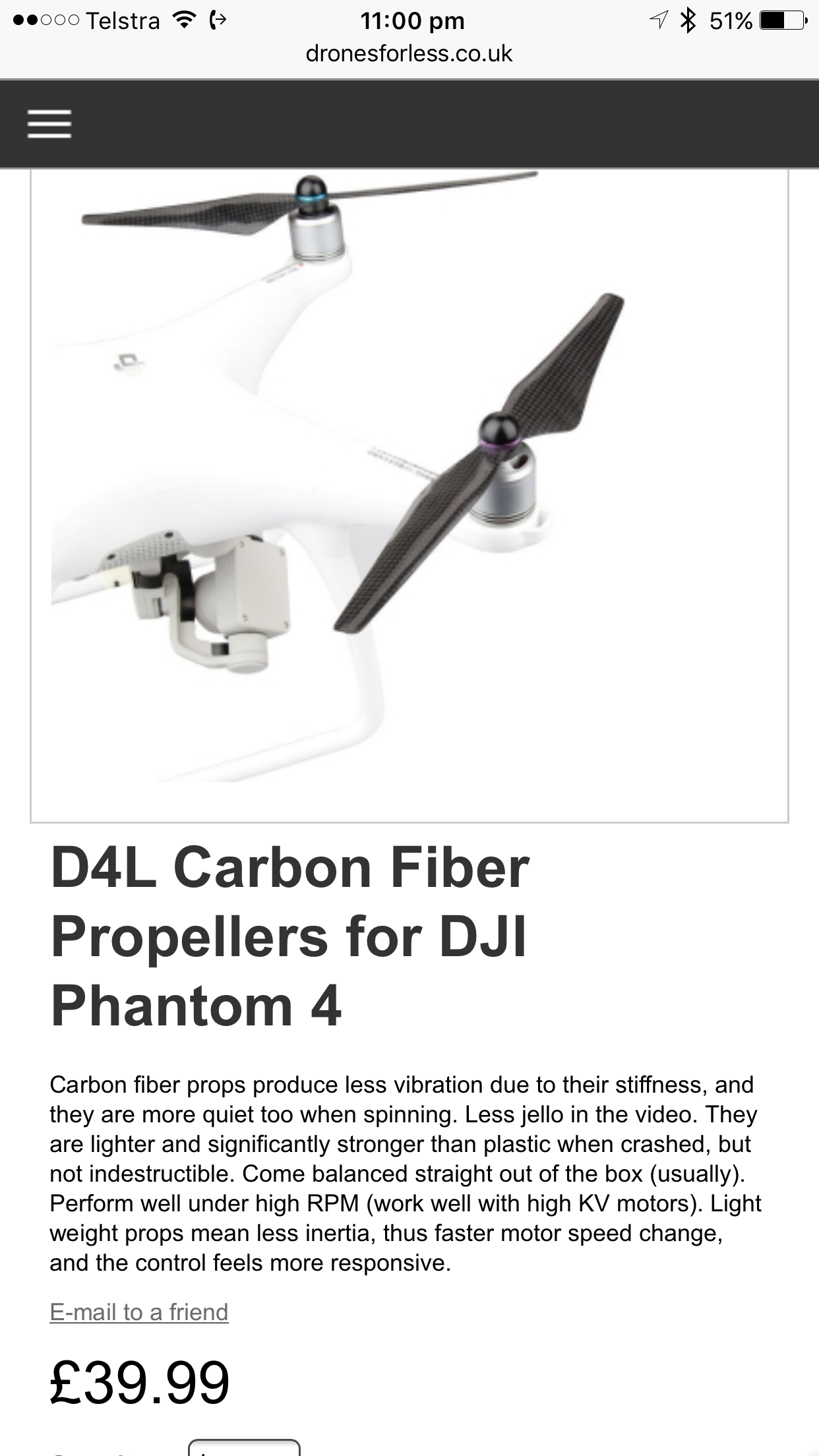

Checked their site and can't find anything listed about this " fixing" system. Doesn't say anything about their carbon fiber props using anything but stock hubs, as far as I can see. Doesn't make a whole lot of sense.
Listed for phantom 4 as an upgrade....
Saw the add. I'm not seeing anything about changed hubs or the like. Am I missing it? Thanks
No.... I didn't see anything re changing hubs either, a picture is worth 1000 words in some instances though. These certainly look like the P3 style hubs on a P4 body.
Ahh...never looked hard at the pic. Guess I was trying to gleen the info from the write-up. Thanks
