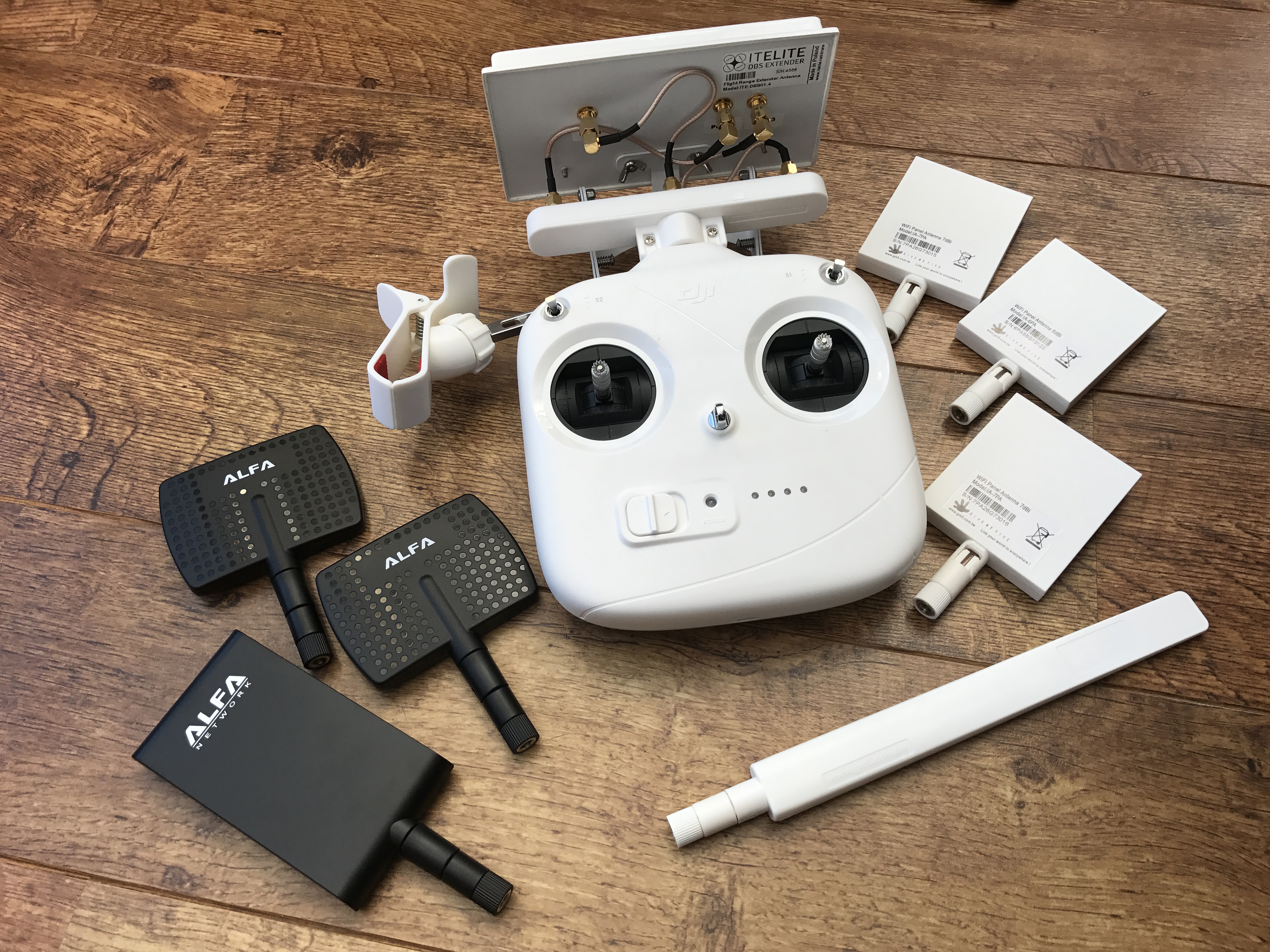

I've been doing a bit of eBaying, and have managed to get my hand on a bit of kit (see the photo below). I wanted to install a range extender with the minimum fuss and impact on the controller, should I eventually decide to take it back to standard (I won't, I know, but it's still early days :)
Anyway.... we're all ready to go. A week in Ardnamurchan, in wildest west Scotland! I should be able to test without much interference from WiFi and other radio sources. Only issue will be the lack of cellular coverage.
I'd be interested to hear what people suggest or think will be the best setup.

First (local) test was a success, although it was a little bit windy. I used a Litchi mission to fly around a small mission. Didn't lose video once, although I think I was a little foolish/brave to send it up today.

Interesting, so you used the ARGTek mount and also attached the DBS mod as well. Cool. Always wondered if this could be done, even if it is obvious that it could seeing as the mount is nothing other than a mount lol.
I was looking at the Argtek but decided on the Alfa mod instead (for the P3s as well). Half the price of and the same or better performance as the Argtek from what I have read. I have not fully tested them yet, though I did run a Litchi mission with them installed and lost signal at 3500 feet, but with solid forest cover, hilly terrain, and only a 180' altitude I actually lost VLOS almost immediately, so I was pleased with the 3500 (since I was also not paying any attention to the direction I was aiming them).
DBS will no doubt provide the best range of the three, but is the most expensive. I think the Alfas are the best value overall.
I paid about £50 for a (new) Argtek and managed to snap up the DBS second hand for £50 too.

I paid £25 for my ARGTek 2nd hand (pretty sure its a knockoff though) but wouldnt mind getting the DBS too. Glad to see that both can be utalised.
Even though mine 'might' be a knockoff it still seems to work, afterall, its the antennas that are doing the work, not the mount.

I take it there is a bit of adjustment in the DBS mounting frame? Does it sit very close to the ARGTek mount?
I am guessing you didnt fancy drilling any holes in your case, the idea of repurposing the ARGTek mount really appeals to me.
Yeah it's close. Have to screw the connectors with care. It would be easy to stress the connectors I think, however they look well made and as long as you're careful you should be fine
Did you try/consider swapping the connectors ie screw the angled connectors to the ARGTek mount and the straight connectors to the DBS? From you picture it looks like they would have a bit more clearance?
