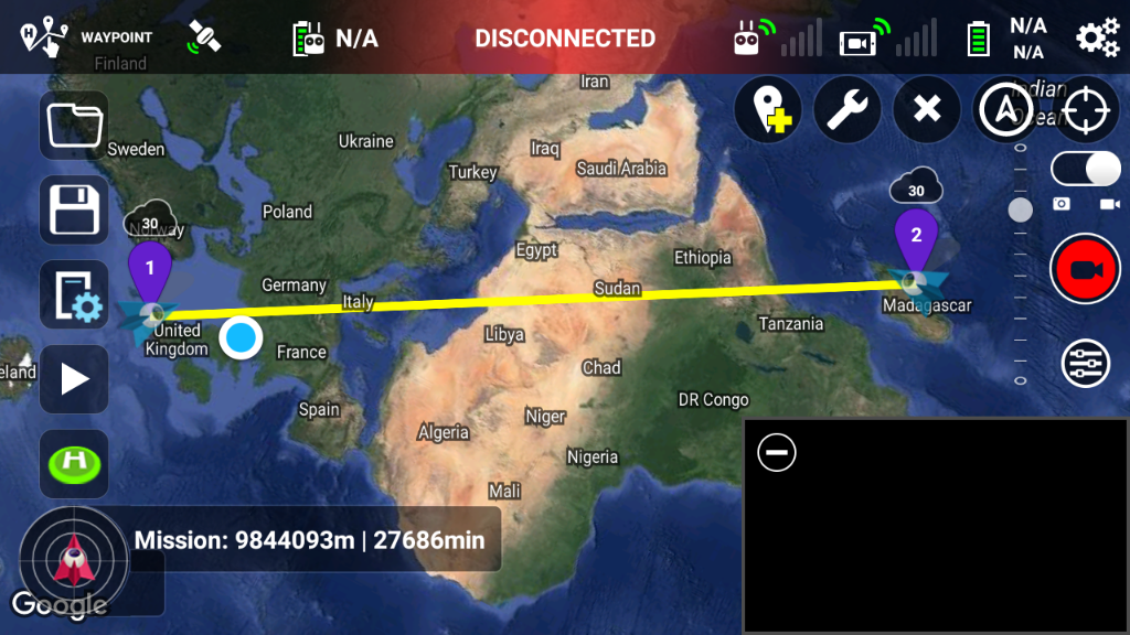

However I wouldn't attempt this one tho...... [emoji23]
NOT possible due to DJI-SDK Limits (you would get an error message after uploading the mission):
Min-Max 3D distance between 2 WPs: 0.5-2000m
Max distance between Home and WP: 4000m
Max Cumulative mission distance: 30000m
Min-Max Corner radius of waypoint: 0,2-1000m
Min-Max Orbit Raduis: 15-500m
Min-Max Height: -200-+500m
Max number of actions per waypoint: 15
Max number of times a single waypoint action can be repeated: 15
Min-Max Mission Waypoints: 1-99
How many times the ground station task will be repeated: 1-255
Min-Max Pause setting in WP-action: 0-32 sec. (0-32767 ms)
Rotate UAV in WP-action: -180°, +180°
Controllable Gimbal range: (-90° to +30°), -90° to +0°
