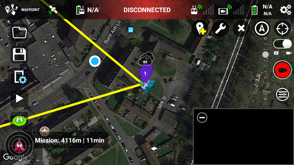

That's one of my missions I done a few times. Always comes back with around 40% battery. Have to note three important things
1) I fly at 90 metres on this run... Higher you go the stronger the wind
2) I fly the drone first using a battery to warm it up, then quickly switch batteries and launch the mission. It can knock 2-3% battery off just by turning the drone on and it warms up
3) this was done in the summer and winter so it was fine to launch and the battery was always the same
Hope that helps.

So- just over 4km and you come back with 40% battery, the OP is planning to fly over 8km. What speed did you set? Less than 25km/hr presumably.

I sent mine at the maximum speed it can go. With the OP he is only adding an extra 3 mins flight time so in theory he should come back with roughly 25-30% battery remaining. Best thing OP can do is really do a local 14 min flight a few times, even if its just going round in circles at the height he is planning to get a good idea on how much battery would be left
