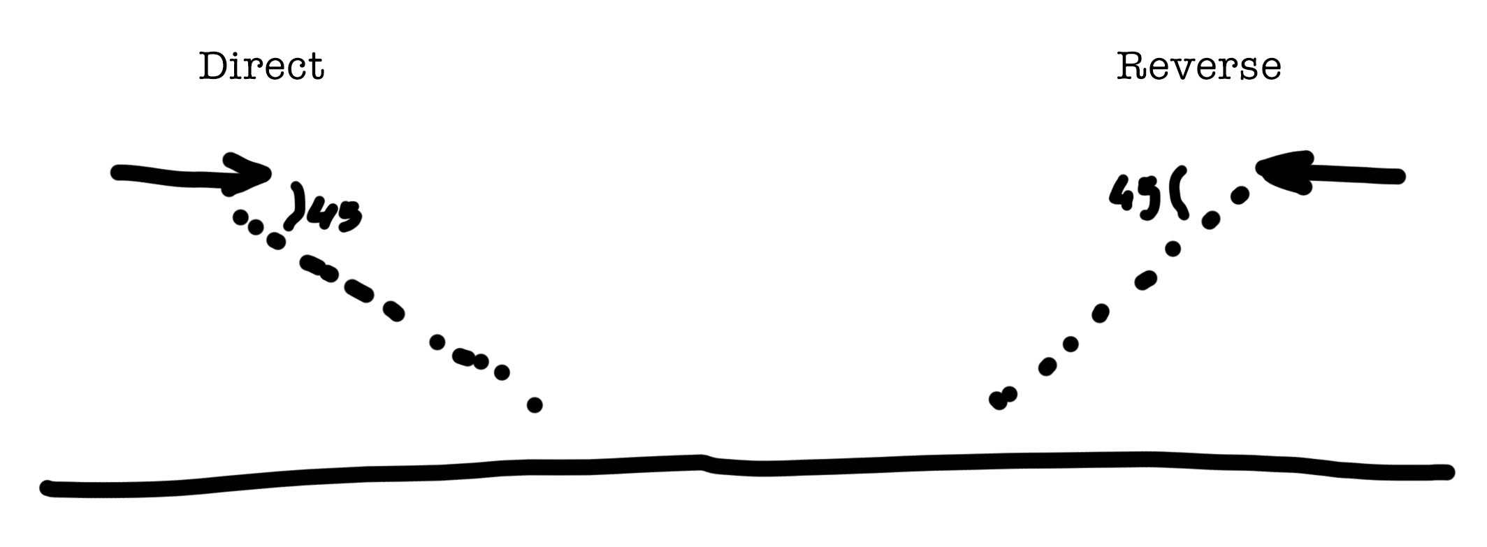

I want to manually take photos at 45° from the horizon during the mission.
At the end reverse the mission, turn the plane 180° and travel wp # descending
Other thing is that Reverse "takes" 22 minutes (2.7km) while Back to 1 Finish Action "takes" 24 minutes (200m), estimated, I understand.
