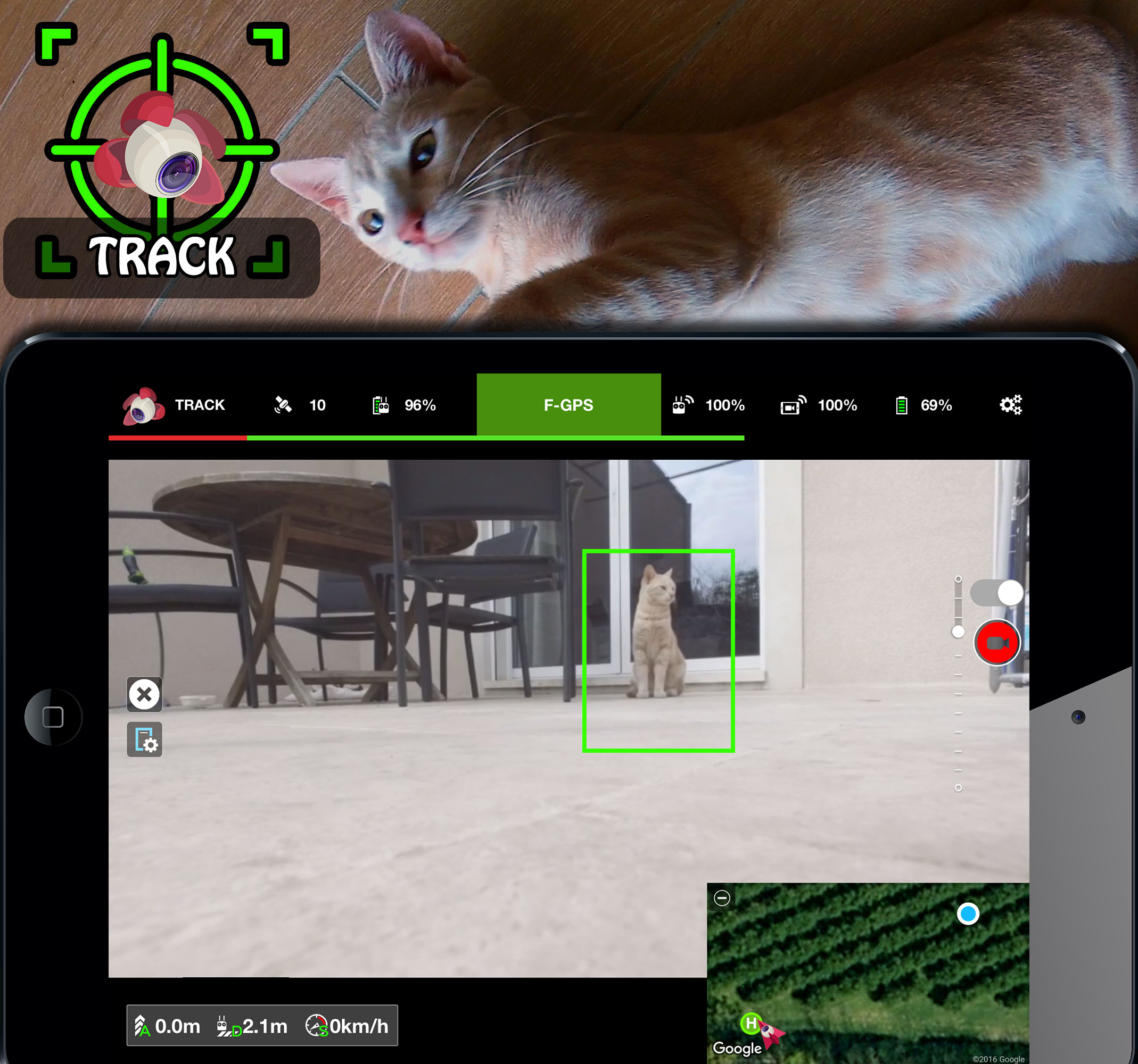

The Phantom 4 is officially out today...but don't worry if you still have a phantom 3, we've got you covered with our upcoming Track mode!
In Track mode, Litchi uses computer vision algorithms to keep a selected object in the frame while you pilot the aircraft.
Track mode enters beta testing today on iOS!

I tried track mode. I learned a lot on when to start/stop the mode only after selecting the tracking object as the video shows. But I kept losing tracking when increasing the distance. Note the box get much larger as distance increase. Also noticed the phantom moves side to side widely as you adjust the sticks (had the polar pro legs on so you could really see it though the gimbal keeps it smooth). Do I need to dial back the joystick speed multiplier or something? I'm on beta build 168.

Which mobile device are you using? Try without screen recording on, this is likely to affect tracking. Based on your video it seems there was some video lag. Track won't work if there is video lag.
Ok. Was using iPad mini4
That was the trick. My iPad mini 4 cellular tracked well without screen recording on. I may try using SHOU screen recorder like I used with vertical studio. Hopefully that doesn't add lag in the app.
