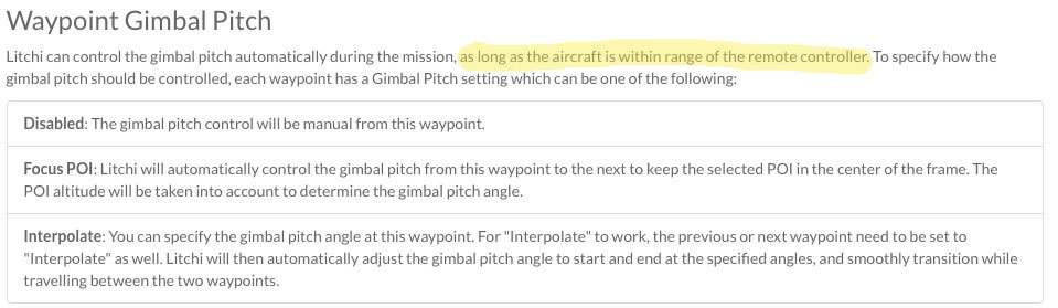

From the help section of Waypoint flying on the Litchi web site.
Thats why. Because for whatever reason, when outside of controller range, Litchi is no longer able to control gimbal angle. I have tested this myself and confirmed it. When you loose RC control, the gimbal will stay at whatever angle it is set at. There is a way around this though, but you must you straight line rather than curved waypoints. You can set a waypoint action to set the gimbal at a particular angle. Problem is, it will stay at that angle until the next waypoint is reached, with a new angle setting.
... Bottom line, to get that nice POI framing you need to be in RC contact.

The DJI SDK only allows gimbal control if the AC is in contact with the RC. This "restriction", if you will, limits what Litchi is allowed to do. It's a DJI limitation, not a Litchi one. DJI will have to support it in their SDK and, according to Litchi, it has been suggested to them.
