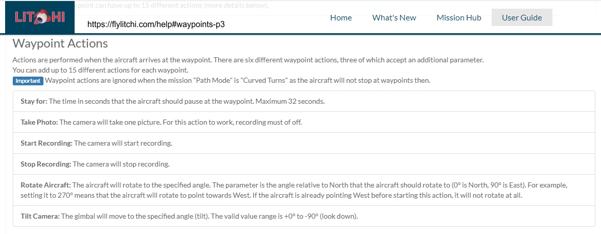

I don’t have access to mission hub to review your flight atm but just as a stab in the dark you don’t have curved turns enabled by any chance? Waypoint actions are not triggered with curved turns.

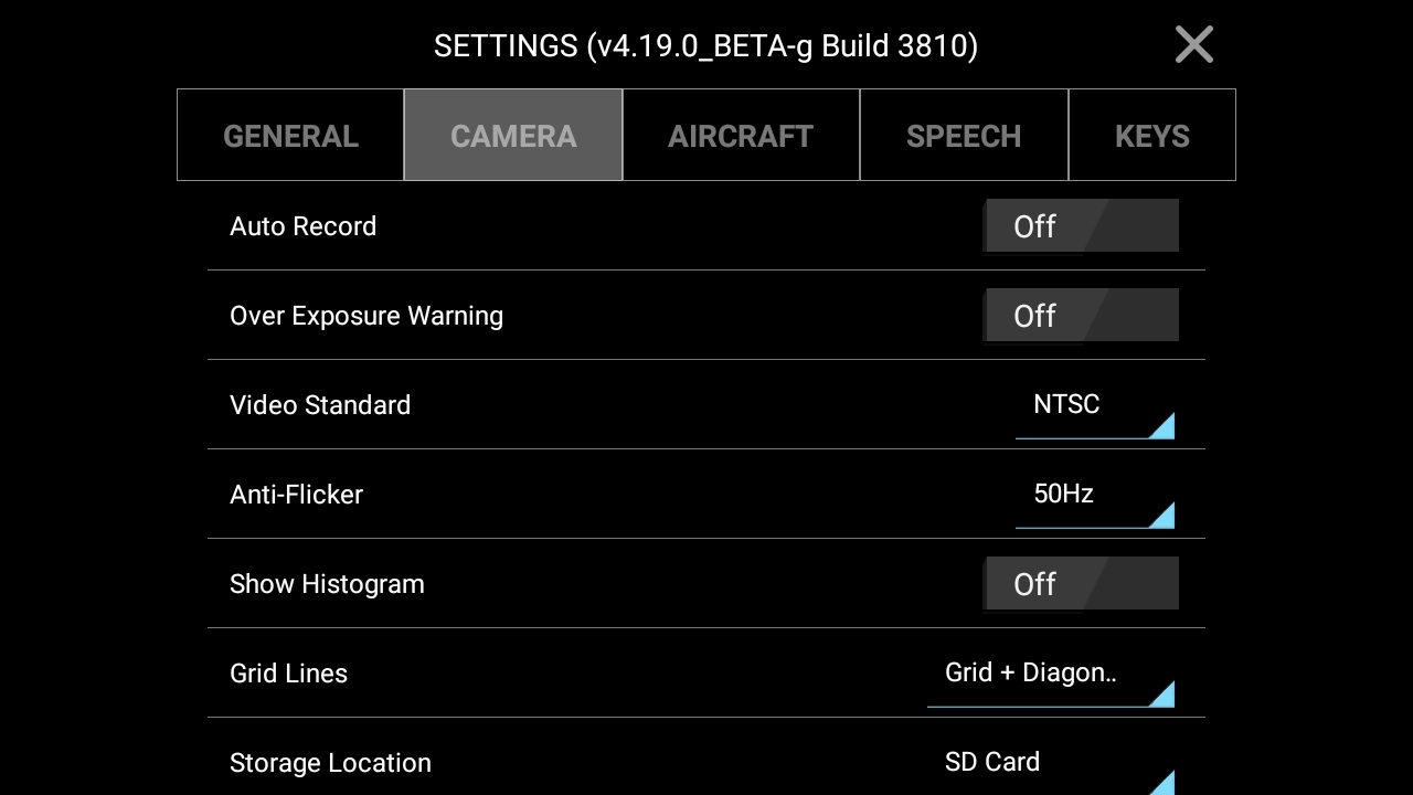

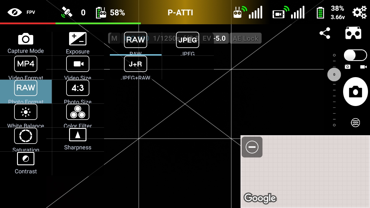

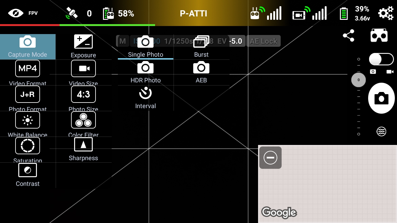

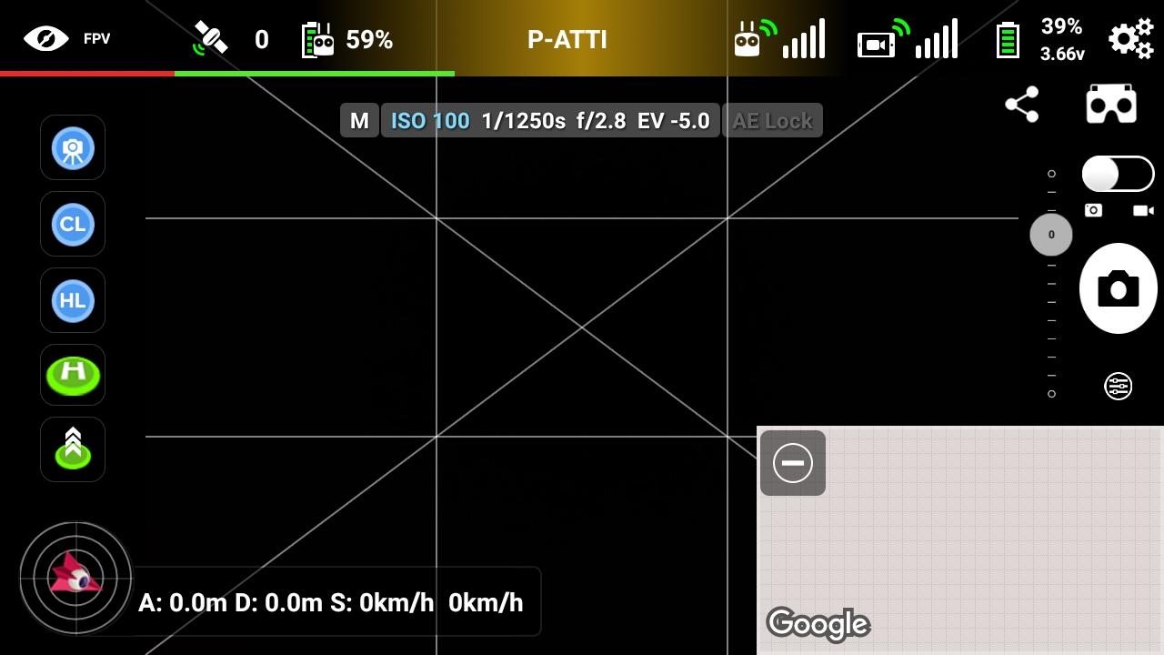

1.Make sure Litchi is in Photo-mode
2.Capture Mode is set to 'Single Photo'
3.Auto Record is turned Off
4.Photo Format is either 'JPEG' or 'RAW', not 'J+R'

You also must have "straight lines" selected not curved.

But it's strange to have to do that, as I used to have curves all the time before and it worked fine
Impossible. (Read the line marked with "Important")
