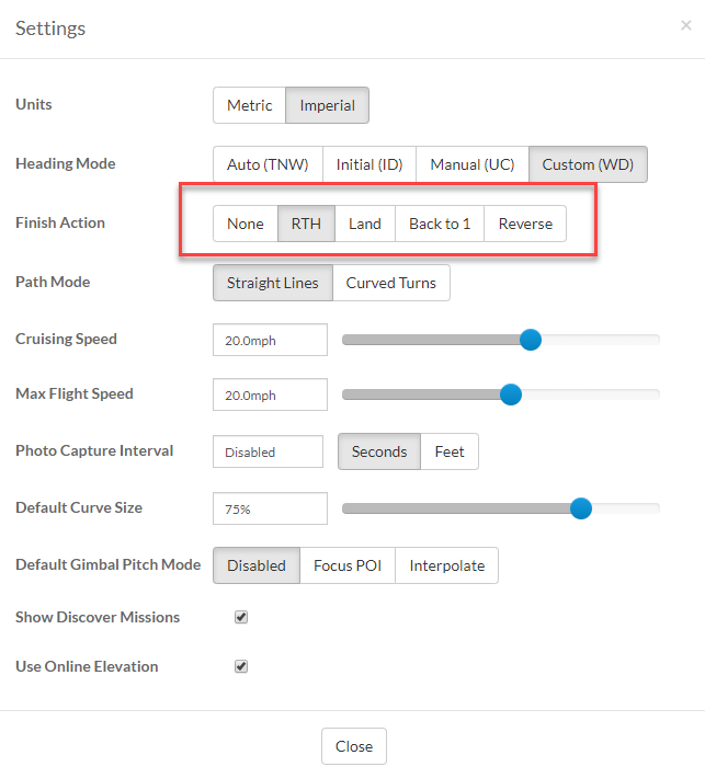

I believe it is standard on any Litchi Mission that the Drone completes the Waypoints. That's the way it works on all of my missions. You can configure what the Drone should do however when it hits the last Waypoint - RTH, Land, etc.
Make sure you have RTH selected in settings for the end of the mission. The drone will do what you have selected and if you have no connection at the end of the mission, you could be in trouble.

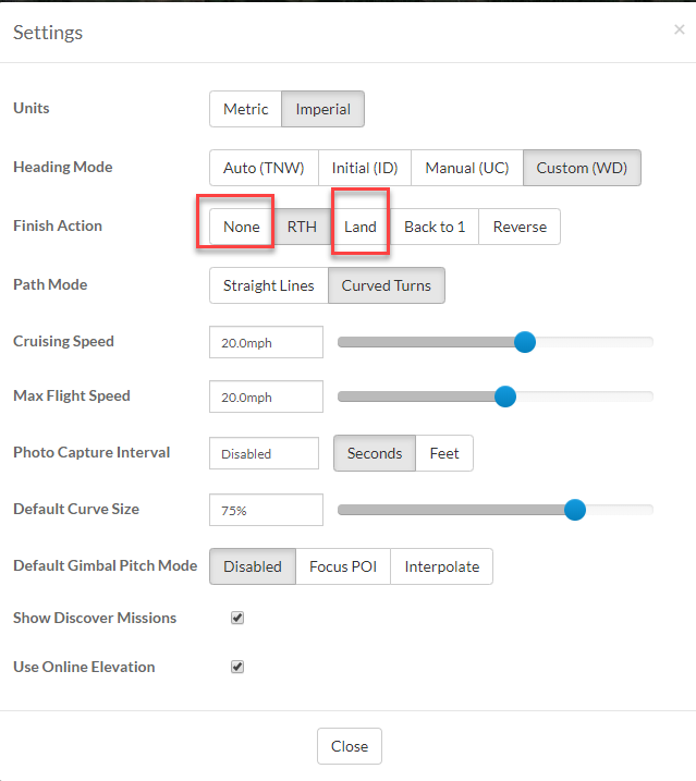

Here is an example.
If you have "None" or "Land" selected in the settings, and your last waypoint takes you out far enough to lose connection, your drone will either hover there until the battery depletes and lands or if you have "land" selected that is what it's going to do.
Regardless of the selection, you must always keep battery life and correct altitude settings in mind.
