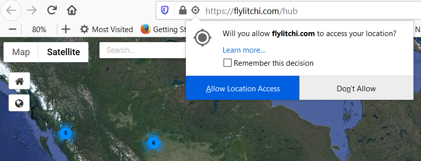

Its not a setting. You should get a pop up....Like this..

First, what browser are you using? You may not have your permissions set correctly.

I can't find the location section in chrome.
But it is in Firefox and lists of web sights allowed and not.
One thing to try is clear all saved settings in chrome.
