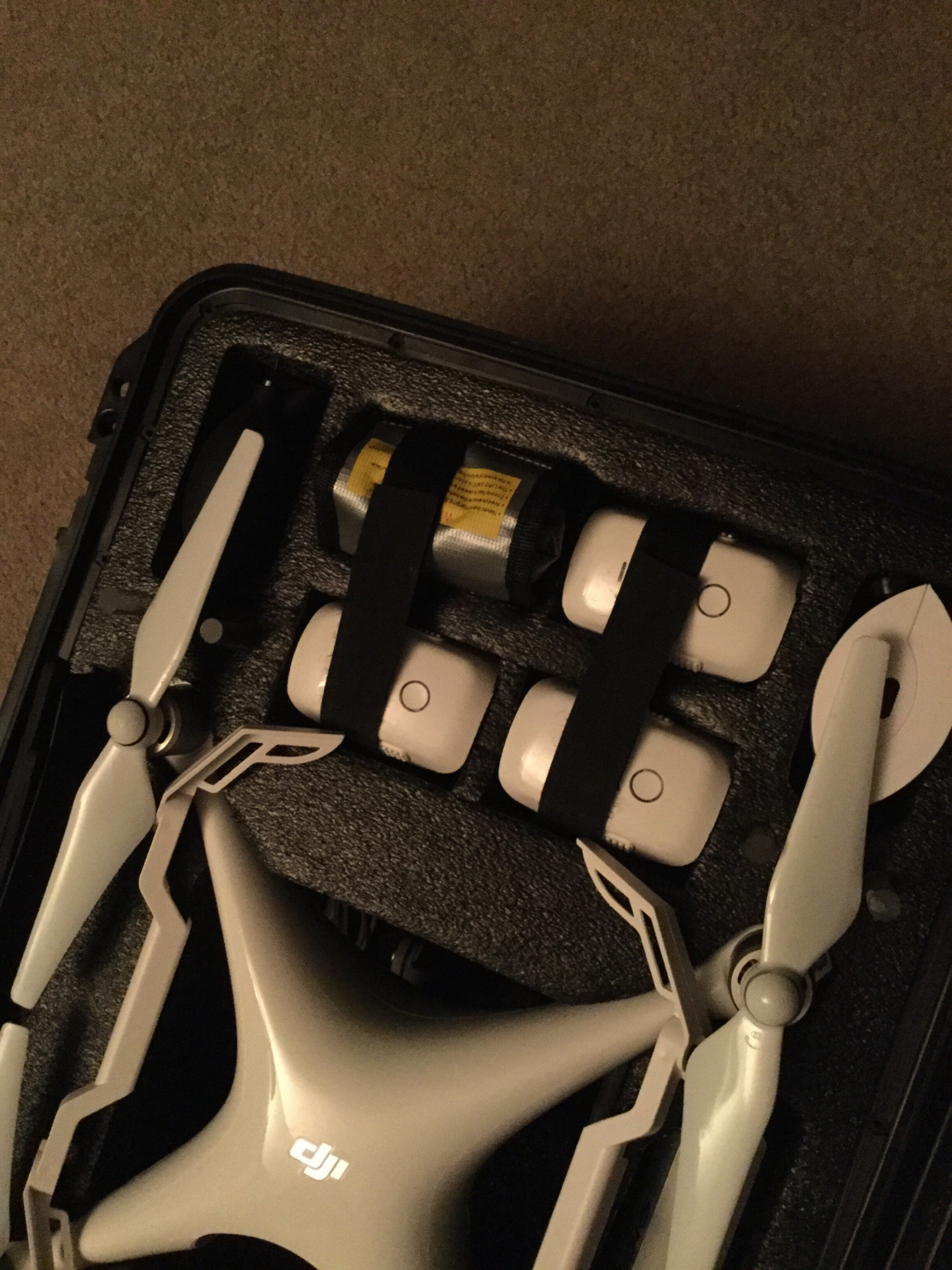

Hey everyone. I have a couple of questions about lipo battery bags. I now have 10 batteries for my P4 and have just got the battery safe bags today. I was wondering if the batteries that are in the case should also be in the bag. I can get them in but they are very tight. If they should be in the bag I guess I could cut some of the foam out of the case to accommodate the bag. Also I see pics of batteries being charged while in the bag. Is this necessary? I never leave with batteries being charged.
Batteries are most dangerous while using or charging them. I've never seen anyone mention an undamaged battery caught on fire while the battery was stored in a case. Even though, I store my batteries in LiPo bags (outside of my cases) when not using them. That gives me some peace of mind since I store them in my house.

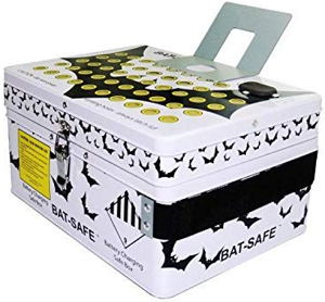

If you're in the room while your batteries are charging (highly recommended), you should be fine charging them without LiPo bags. If you want to use a bag as an extra precaution, then something like the BAT-SAFE would also be a good option to consider.
