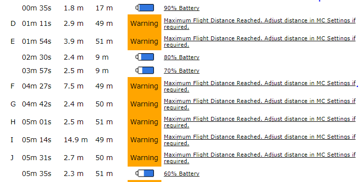

It happened to me... see file Airdata screen shot attached,, and resolved when I switched to Litchi and back. I am looking to buy a CrystalSky with no option to use Litchi.. should I be concerned?????? DJI what is going on???
