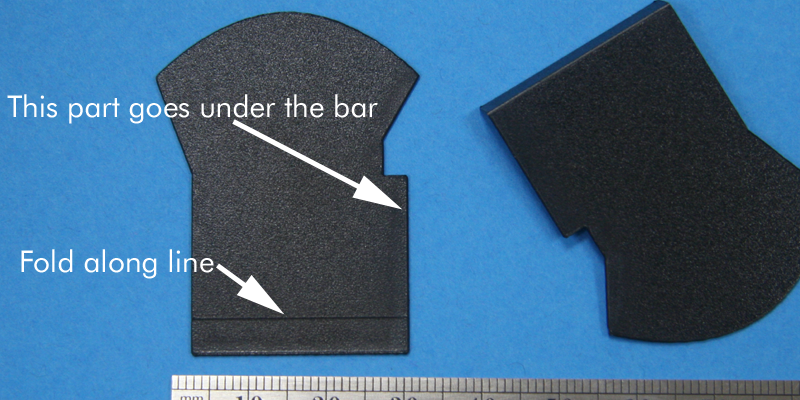

I don't normally shoot in SuperWide mode, but I've never noticed any vignetting. I'm sure there's situations where it's possible, but I haven't encountered any. Ideally there would be lots of FOV/aspect ratio/lens calculations involved in making a perfect hood that rejects off-axis light. I just did a lot of trial and error. This is a special use case, because we're only looking to reject one thing- prop flicker.
I looked at that type of 3D printed hood. I didn't like how it attached, so I made the little "card." I always felt like those type could fall off. Plus, $30 is a lot, but that's about as cheap as is economical with 3D printing. 3D printing is more of a prototyping tool, not a production tool. Weight is also a concern...the ones I came up with are less than a half a gram.
I also didn't like how most hoods had a top and bottom piece. That's extra weight that isn't needed. What are we rejecting light from? The ground? Might be useful on a standard GoPro you take snowboarding, but if you're GoPro is upside-down on your Phantom, the shot's probably ruined...or will be soon :)

When you guys get these things, make sure you're orienting them correctly or they won't fit. Pay close attention to the instructions and fold the right way.
Here's some clarification:

Yup. Noctividus is absolutely correct! Doing it upside down will not work. I'm told...er, not that I tried it that way...ahem...oops. ..gotta bounce.. :oops:

It's tight, but it's not like you're breaking anything putting it in there. If you feel like you're "forcing" it, you're probably putting it in backwards.
If you're concerned about it, I'd recommend modifications in the following sequence until you get the fit you want:
  • Cut along the score line so it doesn't fit behind the GoPro. Then tape from the top of the lens hood over to the side of the GoPro.
  • Cut along the same line but a little more so it doesn't slip under the Zenmuse tray.
  • I would leave the part that goes under the bar in place. Without it the thing will flap around a lot.
