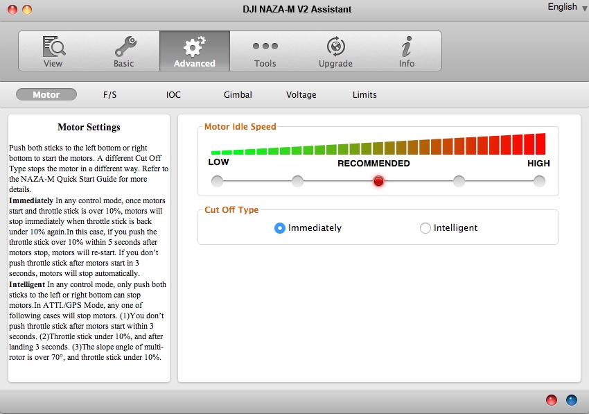

By navigating into the NAZA-M assistant, I found this :
Yes a DJI PHANTOM FC-40 and any others Phantoms which you can modify this parameter can have the motors cuted-off during a flight by putting the left stick (Throttle) full down.
It's just depend of the settings of this parameter.
Obviously I didn't wanted this and I still don't want this settings to be into "Immediatly".
I switched to Intelligent and it seems to have fixed my issue by testing my Phantom into my room without propellers. I'll do some in flight tests when I'll get my new propellers.
So every second hand owner of any phantoms which you can modify this parameter should check this before flying to don't have the same issue as me ;).

I can affirm that this feature is available for my FC-40 by the NAZA-M assistant I downloaded from DJI.
Maybe my NAZA has been changed by the previous owner, I can't tell and I don't know how to check.
I just made new tests switching the settings from "Inteligent" to "Immediatly" and It's changing the behavour as describe into the description from my screenshot.
Without any doubt my issue came from here.
