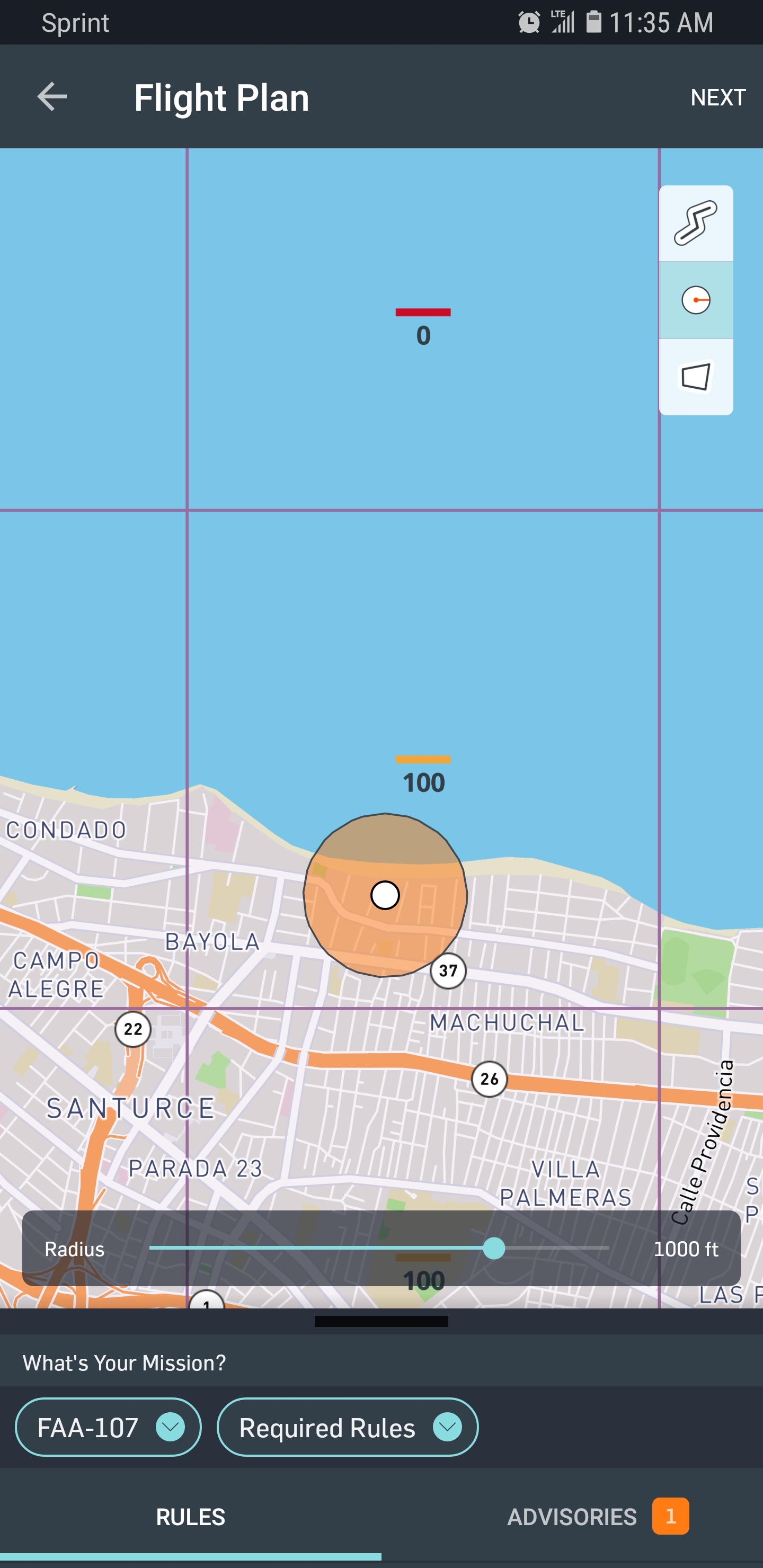

I have another question. If I'm flying in a 100' ceiling area, but I'm doing an inspection of a building that is aprox. 180', am I allowed 100' over the building like normal?
Negative .... authorizations are MAX height period!
I was half asleep when I typed that.... I wanted to add that LAANC heights are "absolute" and can not be combined with any other circumstances or "deviations". For those things you'll need to get an approval from ATC.
So if I wanted to fly up to the height of the building (not go above it) I will have to ask the ATC? Correct?
Yes exactly. If you are "approved" in LAANC to say 200' AGL (that's an absolute) and you want to fly up & over a building that's 300' then you have to get approval. While that makes no sense (at least to me) it's how the rules are currently written for LAANC.
If you want to fly above the building you put in the height you want to fly at in your LAANC request.

I can get instant LAANC to fly in that area up to 100', but the building in said area is 180-200' high.
Since Part 107 is allowed to fly 400' over objects, my question was if it also applied in this area where it clearly was stated that the max allowed ceiling for authorization was 100'.
If I want to finish my inspection, then I have to use the old method of authorization that may take up to 90 days.
