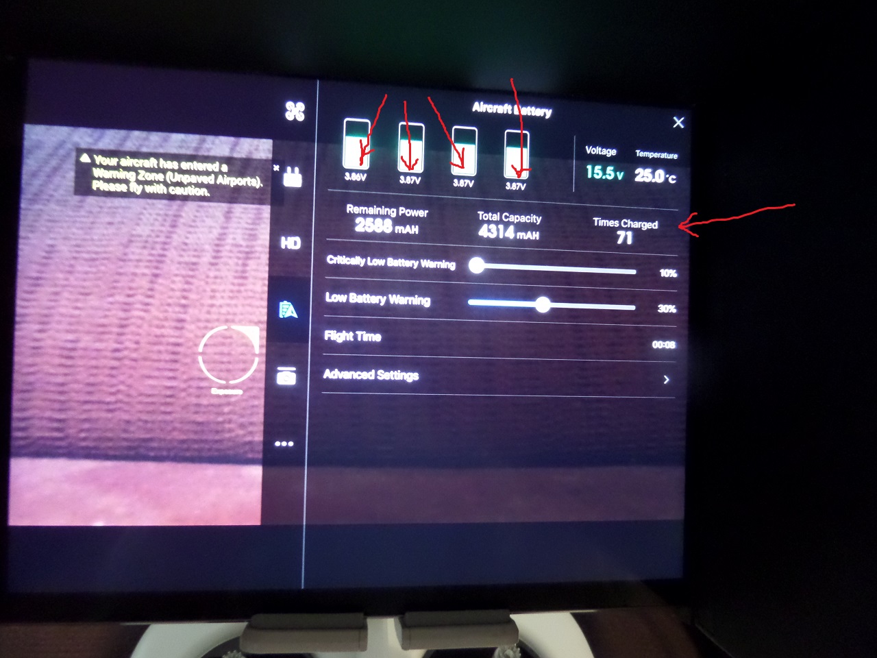

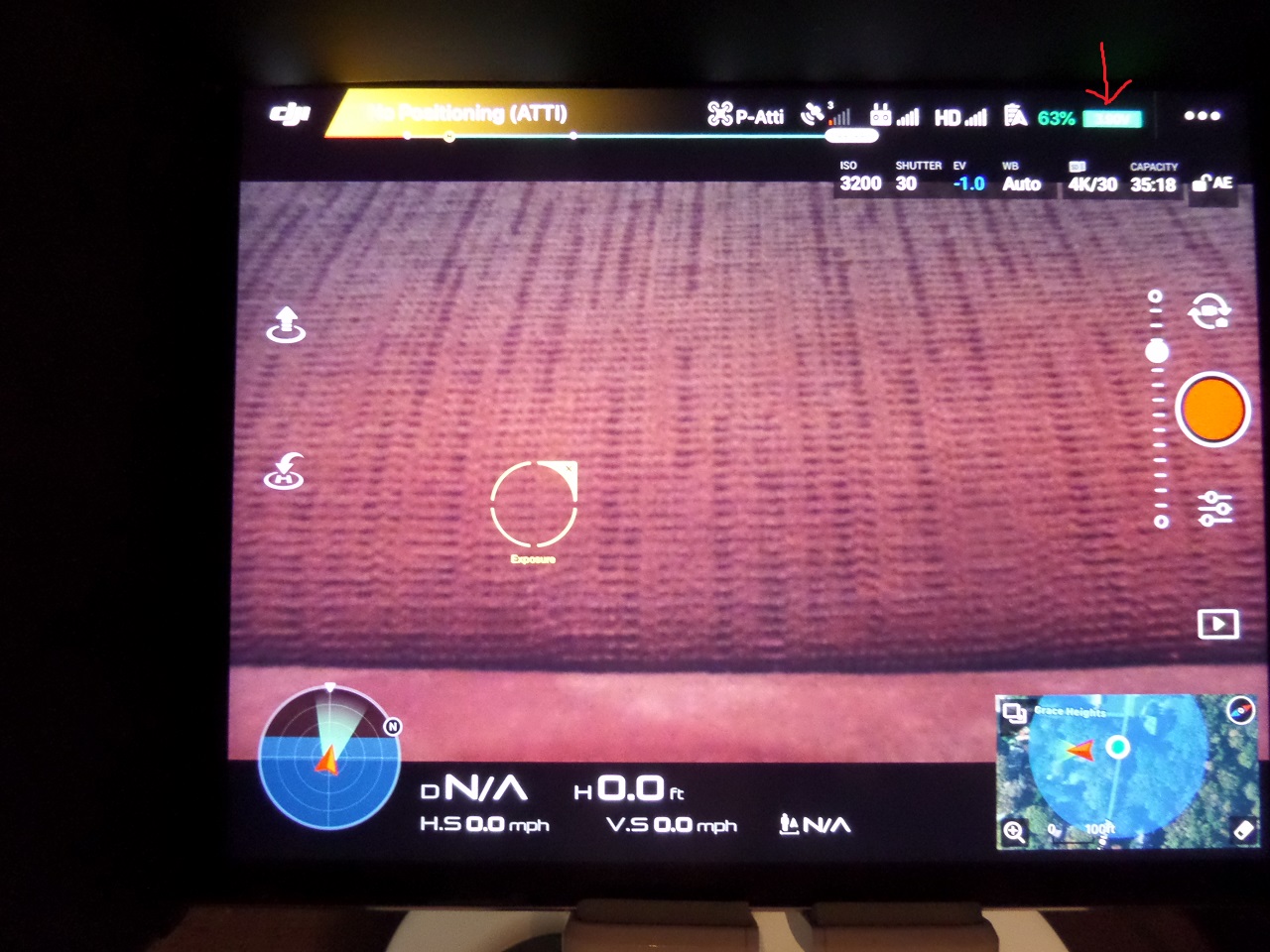

WOW ! 4K miles and 5 hours later there. The care and feeding of batteries (in order to maximize their life and useful capacity) is a whole study in itself .... and a very worthwhile one. I'll send you a link or two that I have found useful. Meanwhile, you can click touch the battery icon at the top right in the DJI GO app (see P1 below) and it brings up P2 below. There you will see the number of times the battery pack in the drone has been charged. As you can see, the battery pack in my example has been charged 71 times. 200 charges is considered the normal life of a pack and the care and feeding you give it will be vital in achieving that. Also take note of the cell voltages. You want them to be as close as possible to each other. A cell that continually reads significantly lower is a sign of trouble developing.
