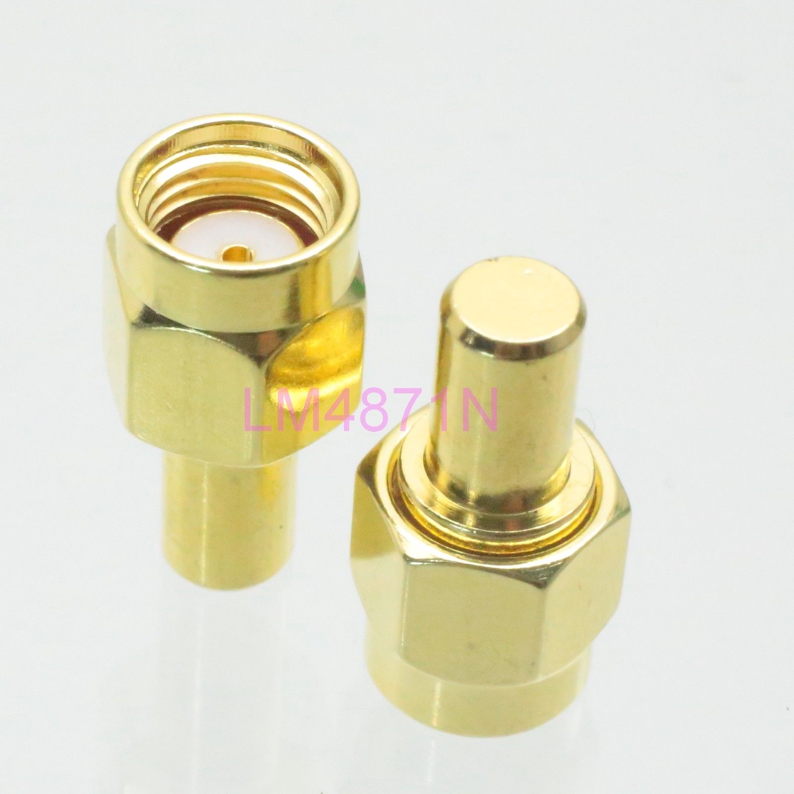

    I will replace the 2 white plastic caps I am using to cover the connectors on the RC with 2 dummy loads.
    That will not be 100% safe for all cases, but at least the case where you turn on and forget to connect the antenna will be covered.
  9. flybid
    Dec 21, 2015
    50
    19
    Can you show me what you're going to buy? Sounds like a good idea and I may want to do that.

  11. Dronason
    Aug 9, 2015
    515
    83
    Switzerland
    flybid likes this.
  12. Dronason
    Aug 9, 2015
    515
    83
    Switzerland
    Could be a good alternative, but maybe you will see that you forget the panel antenna when the bird is at some distance.
    Advantage is that you can do test without need to mount the panel antenna.
    flybid likes this.
