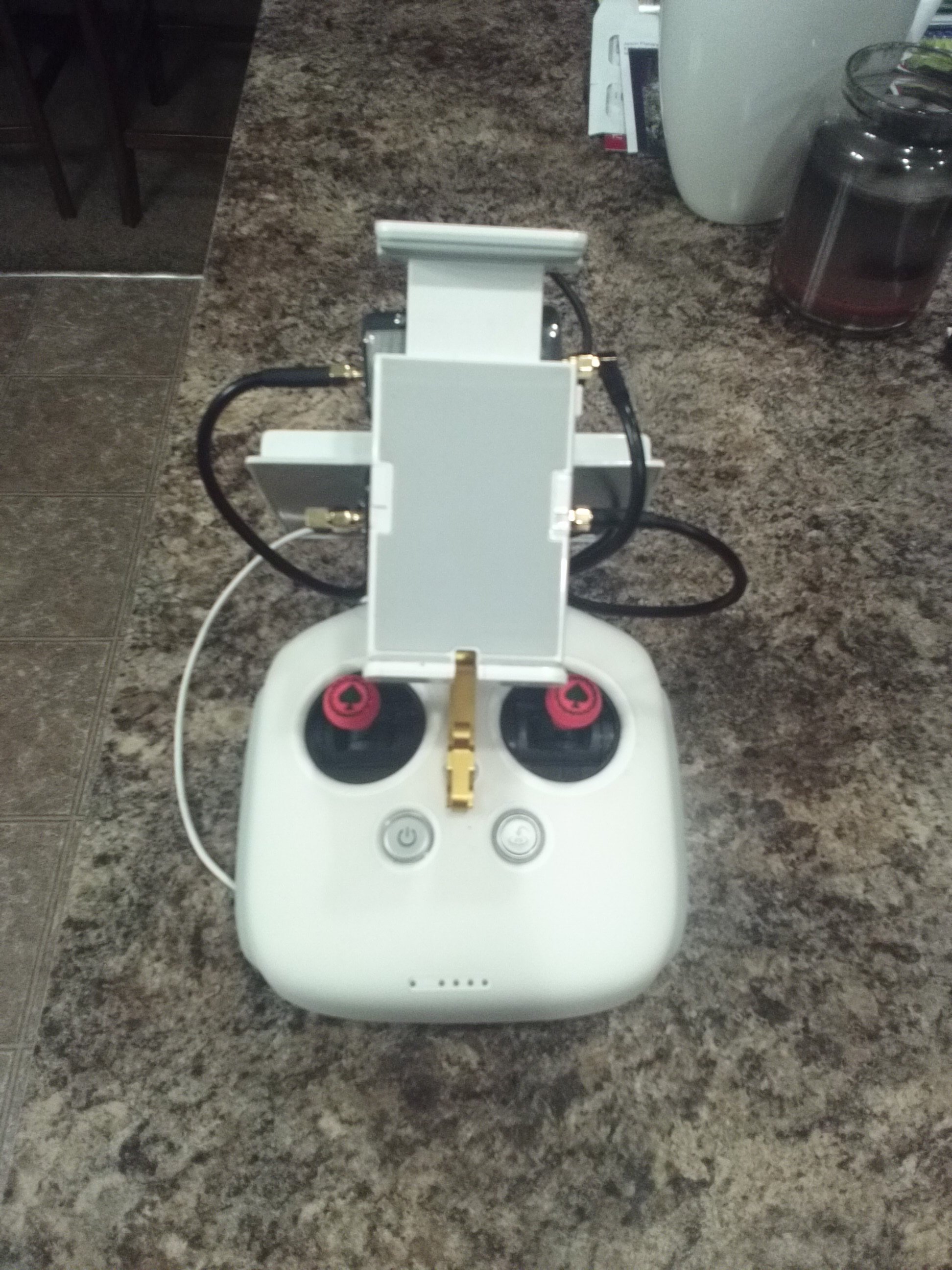

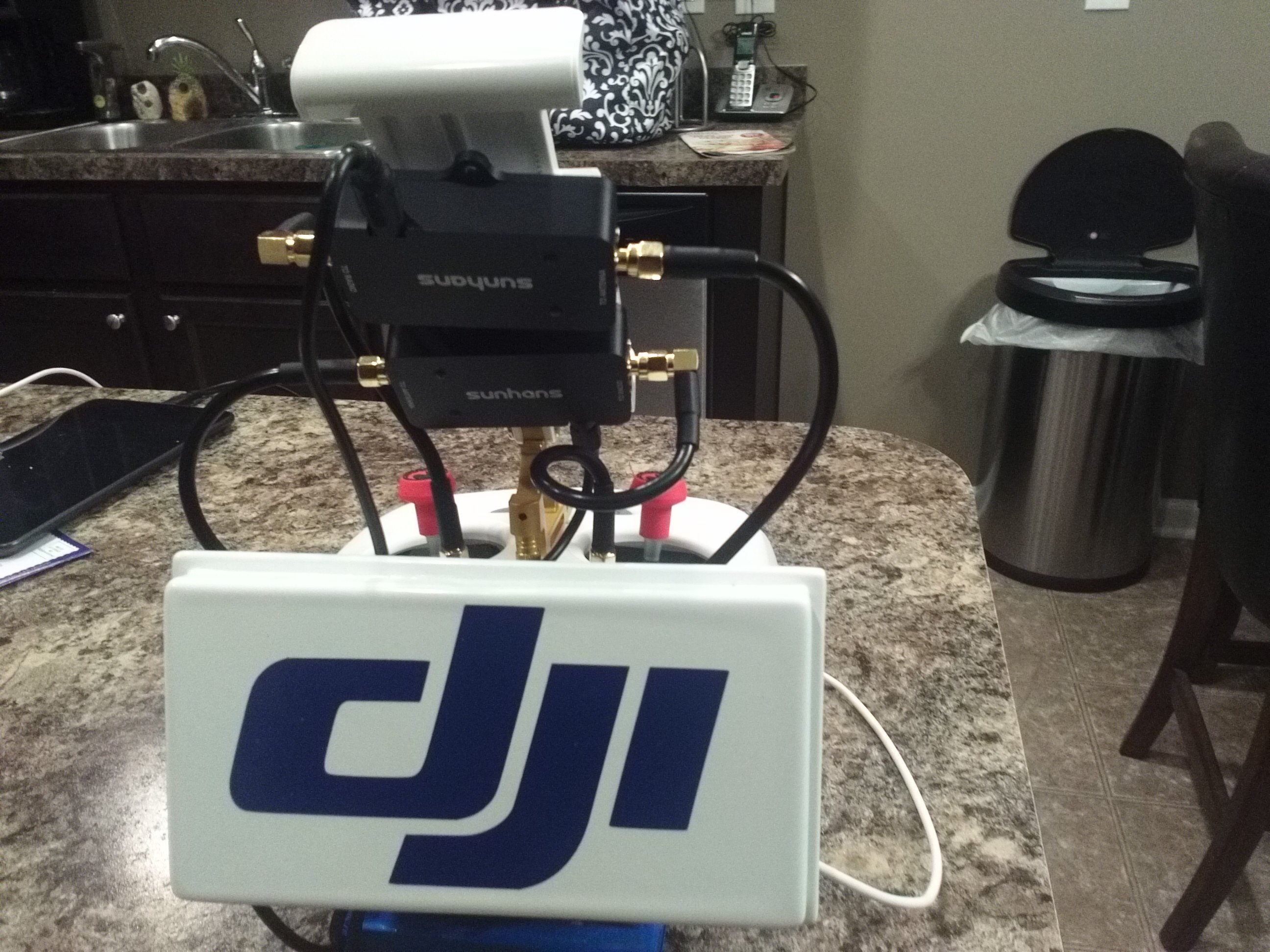

Tommymonkey and phantom13flyer,
Do you have picture of your setup? And what's swr? I'm new at this and am trying read/learn as much as I can. I'm also waiting for my DBS antenna for my P3P to arrive (hopefully tomorrow).
SWR is standing wave ratio which measures the amount of reflected power from an antenna or in the case cables. The more power reflected leads to heat buildup which over time can lead to damage. I'll post a couple pics tonight. Welcome to the club!!

Also, I saw one of you posts in another thread regarding rg58 over rg402. For our application, is rg58 the best cable to use? I tried researching this online, but got confused with all the other "rg" cables out there, i.e., rg59, rg213, etc.
I just made the switch from the rg402 to the rg58. The weather has been crappy and I haven't gotten a chance to make any long distance flights. The rg58 cables are thicker and more flexible than the 402's . Tony from fpvlr recommended them over the rg402 cables. The 402's can break over time and you won't know it because it's on the inside . I'm hoping to be able to get out this weekend and I'll post my results .
