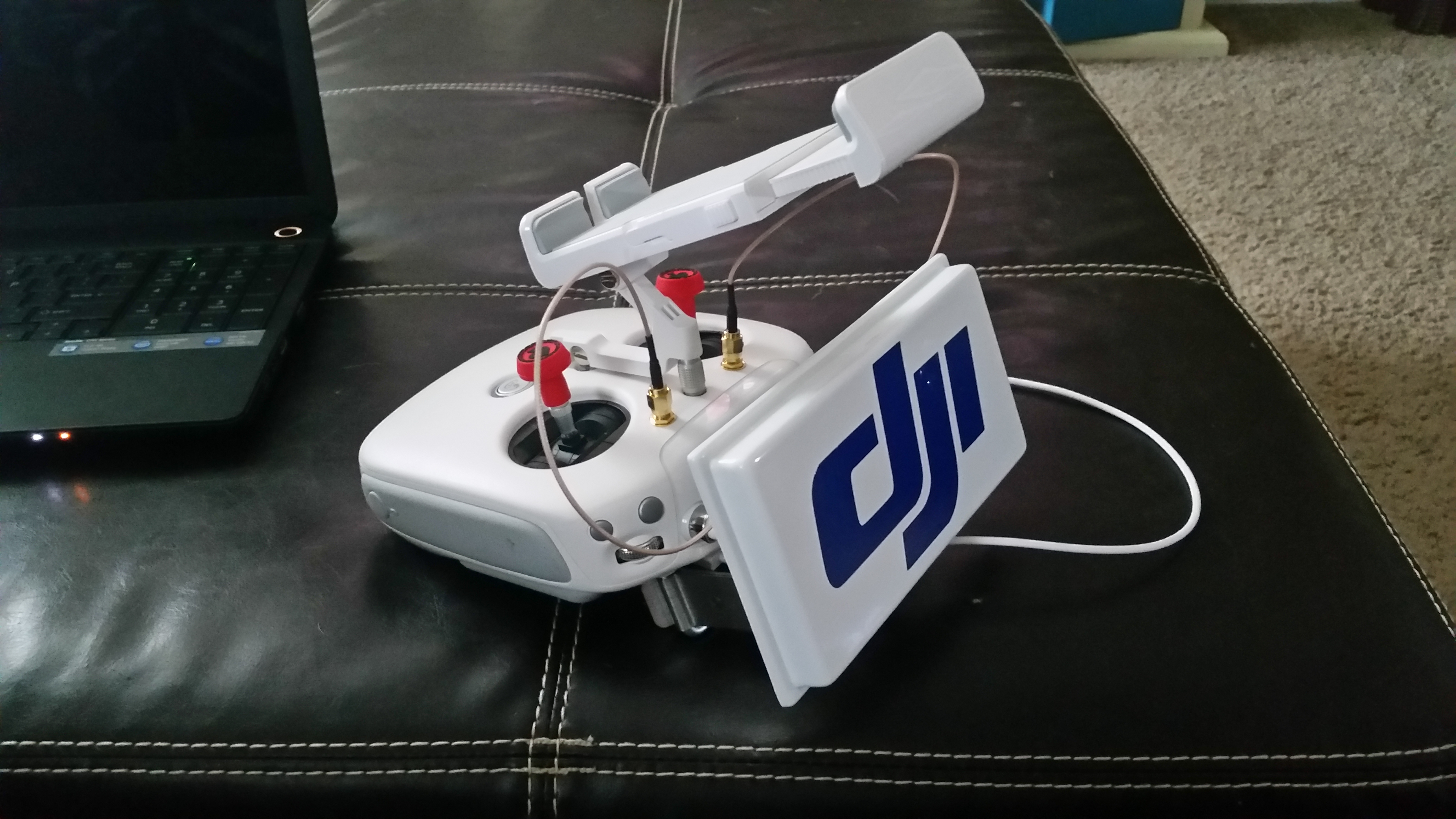

ITElite DBS Mod Not easy!!

I have the DBS mod antenna and love it. Easy to do-just take your time. I did buy the shorter cables and they fit good....BUT I noticed consistent signal loss. Signal is strong then completely cuts out.... Then comes back. Switched back to the original DBS issued and back to strong signal. I don't know.... I'll just stick with the original ones

I just finished the install of my new DBS Mod and it was challenging to say the least. From start to finish I was a little under an hour. It was successful but lets say I may of lost weight as I was sweating through many stages. I can see now the reason why many are damaging the ribbon cable is not just from getting it out or getting it back in the slot but the hard part is getting it back in position through the slot back to the board it fits into . I will admit I was shocked to see the size of the ribbon cable and I can see now that strictly using your fingers(I wear latex gloves) will not work with these ribbon cable as they are too small. As I said in other posts I am a computer support specialist and have been working on computers for almost 20 years and installing or replacing a ribbon cable is far from a new event for me. This is a challenging install and the amount of things that can go wrong are many. My suggestion to anyone who is not 100% into this sort of thing is send your remote to DBS or I think you will likely be out the cost of a new remote. In hindsight I would've sent mine to them even though all appears to be working fine.

Also recommend upgrading the outside cable to a thicker rg402 coaxial cables . You can find them on eBay for just a few bucks.
No way these are having any appreciable impact. The connections will have the most loss. If the cables were ran directly from the RC board and soldered directly to the antenna then that would be beneficial.
The trick to reattaching the ribbon cable to the con board, is the actually unscrew the con board from the controller BEFORE trying to put the ribbon cable back on. If I would have done this the first time around I would not have damaged the ribbon cable.
