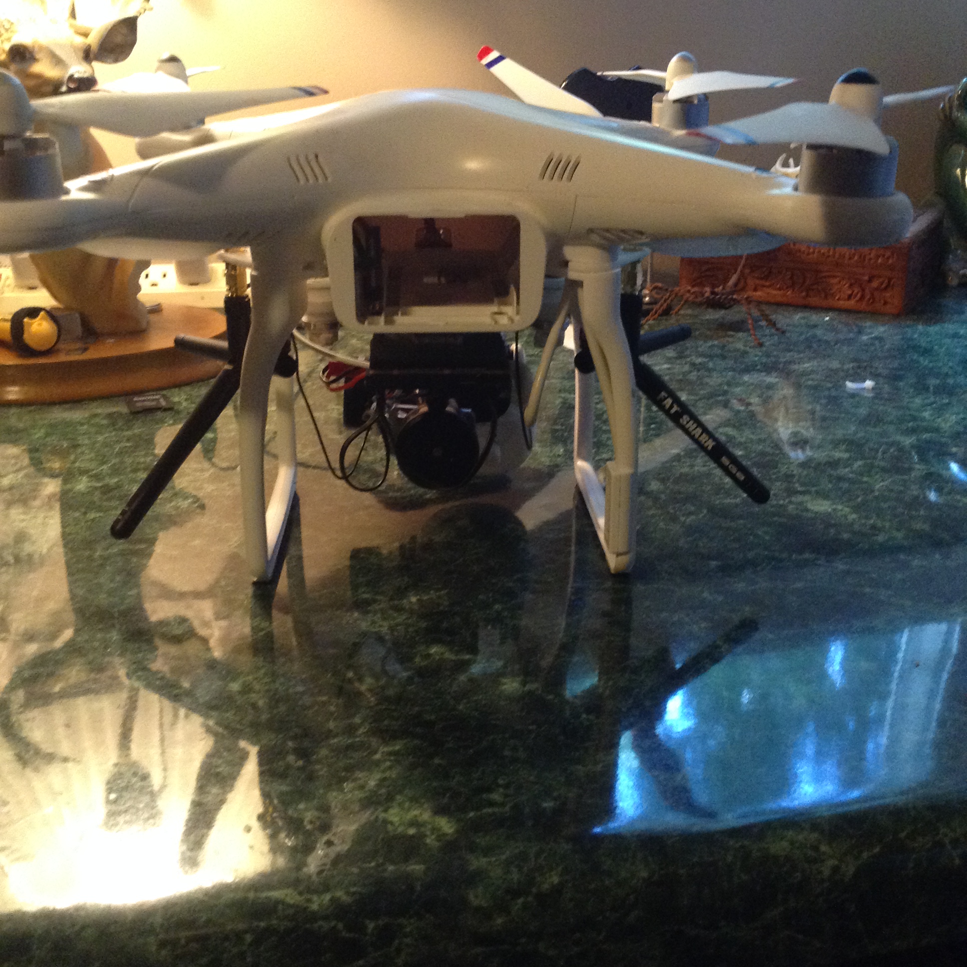

Sorry I keep asking this but I have yet to get an answer !
What bird side antennas do I need to have for my set up ?
I have to use external 2.4's as the gimbal covers 1 of the panel antennas in my FC200 so that's no good .
I already have the cables set up for and was using FPVLR ones and have tried the fat Shark ones as shown in back post .
No good !!! Does anybody have a clue to just what I need to get ? I am starting to think I will be better off just going back to the
others I was using before but had rather use this one . This is how it is set up now and it sucks !
Before I will stick those flat panels on my bird or hang them I will just go back to FPVLR ones even though they a pain to transport and this ITELITE TX panel is much easier for me to transport !
Thanks

When you say flat panel do you mean the stock one's?

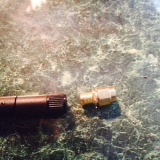

With that the only other think I see can be my problem is when they sent the antennas all 4 had the same ends as the one's coming from my bird so I had to order 4 connecters [ can't remember what there called] to beable to use the antennas .
Maybe this is my only problem then !

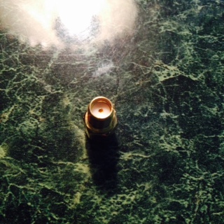

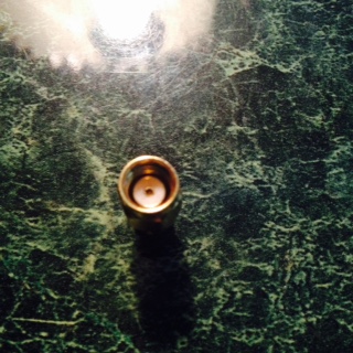

can you take a picture of the inside of the connector of the antenna and also the connector on the aircraft
dirk
From your picture I can tell ya , From bird is RP-SMA Female and the ones on the fat's are SMA Male . That's why I got the connecter so I could at least try them out .
dirtdummy I am sorry I just reread this and saw I had missed what you asked .
Yes that's the ones I am referring to like in the video where they have them removed from the Plus and on the outside of the bird .
Am just trying to find out if the one's I have pictured are what I need or the ones I've seen with the dome at the end or what .
Are you sure? bird -> rp-sma female has pin in centre, fat shark -> sma male pin in the middle - these 2 can't be connected together....
Yea me sure that's what this was for
That's what I am wondering is this my weak link ?

Yea me sure that's what this was for View attachment 18822 That's what I am wondering is this my weak link ?
Can you please take photos of the connector so i can see centre / inside of all the connectors - bird, antenna and little adaptor (like the picture I posted)
Connecter gonna be hard to get picture of with my phone bro but both ends have the hole for the pins to go in .
Thats ok - when you plug the adaptor you convert the fat shark from SMA male to RP-sma male which will fit the rp-sma female on the bird
The one on the left
