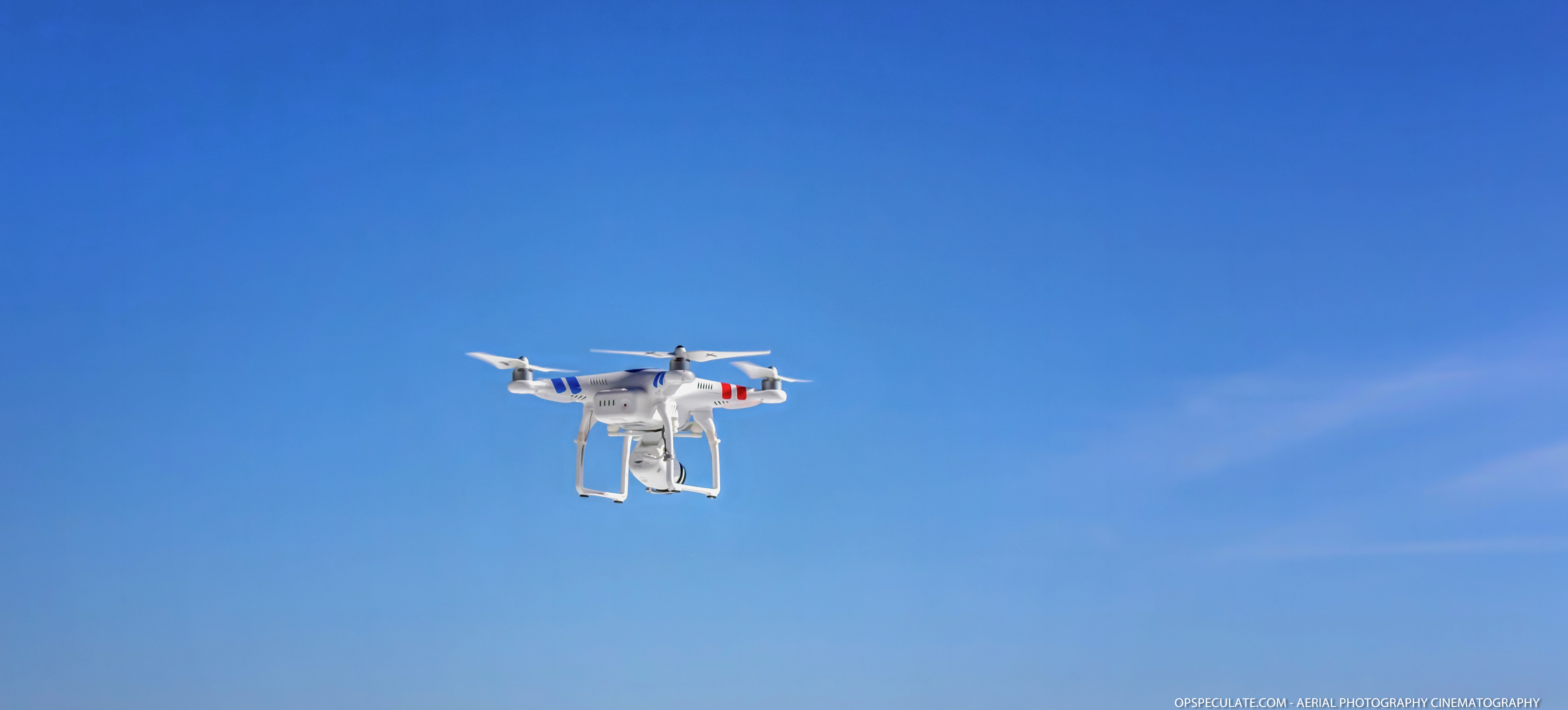

    Image00034_cr-2.jpg After 2764 flights with a Vision 2 and current Vision 2 plus v3 I had my first fly away with the plusV3 flight 2765 yesterday in the middle of nowhere in Ontario Canada. I have been filming there since March this year and other locations. There is zero cell and power lines only trees for hundreds of square miles all around me. We canoe in for days to locations. I started up with normal compass cal and waited for min 7 sats. All the norm for years, same routine, another day. Flew around after normal take off and did normal B-Roll video fly around first then went to pictures after 5 min of flying around and finding the view I wanted for stills.
    I was in complete hover at around 35m or 100 feet almost direct but out front above me taking pano shots and in the middle of an 8 picture set.
    After 5 min of hovering it suddenly took off to the direct right at full speed. My spotter called out to ask what the heck am I doing, with zero input from me on control I looked up from the screen app and saw it take off over the tree line, FAST !!! I could see it in the app it was flying hard towards the water and I knew it was not me flying but remained calm with the few choices I had.
    I could not believe after reading about fly aways over the years it was finally happening and that WTF I am going to lose my sh@t comes over you.
    I went to atti right away thinking sat signal issue with no response from control at all, it was already close to range so not much time left for home or course, it was approaching the sound barrier lol
    There was no wind either, just raw quad power flying on a one way mission to who knows...
    I turned off the controller and it went to rth right away and correctly. On the app it said return to home and it turned direct towards me all calm and relaxed and flew home like a pro. Once it was close I turned on the controller to try and land myself and it went direct to exact same fly away again in same direction... FAST !!!
    Again I turned and left off the controller and it went rth and landed exactly at the take off spot perfectly.
    Conclusion...
    The phantom plus v3 was fine.
    It knew how to find home and it knew how to fly correctly to get home without me.
    The controller in on state was the thing messing it up so I am convinced it was the controller hardware / software relationship or bind that failed not the Phantom.
    Once back at my office I checked inside for obvious failure in both controller and phantom and tested all on the computer link. I then did a recal and forced the already existing updates to update again to just refresh the current in both controller Phantom. Have flown in my office atti obviously 4 times since without any issue. Going to try outside test again in a few days with better wind and rain conditions.
    Take my word for it as an insured certified CCUVS UAS seasoned pilot and not new to this at all
    A FLY AWAY IS VERY REAL !!!
    It will happen very sudden without warning and there will be very little if anything at all you can do but remain calm. I was left with one option to turn off the controller and it worked. It may not work for other types of fly aways but it is another working option when you have about 3 to 5 seconds to make the call.
    I have never seen first hand before until yesterday flying for the last few years of using dji hearing about a fly away so it is not very common but it is very real.
    It really does just fly away at full speed and it is not the pilot !!!
