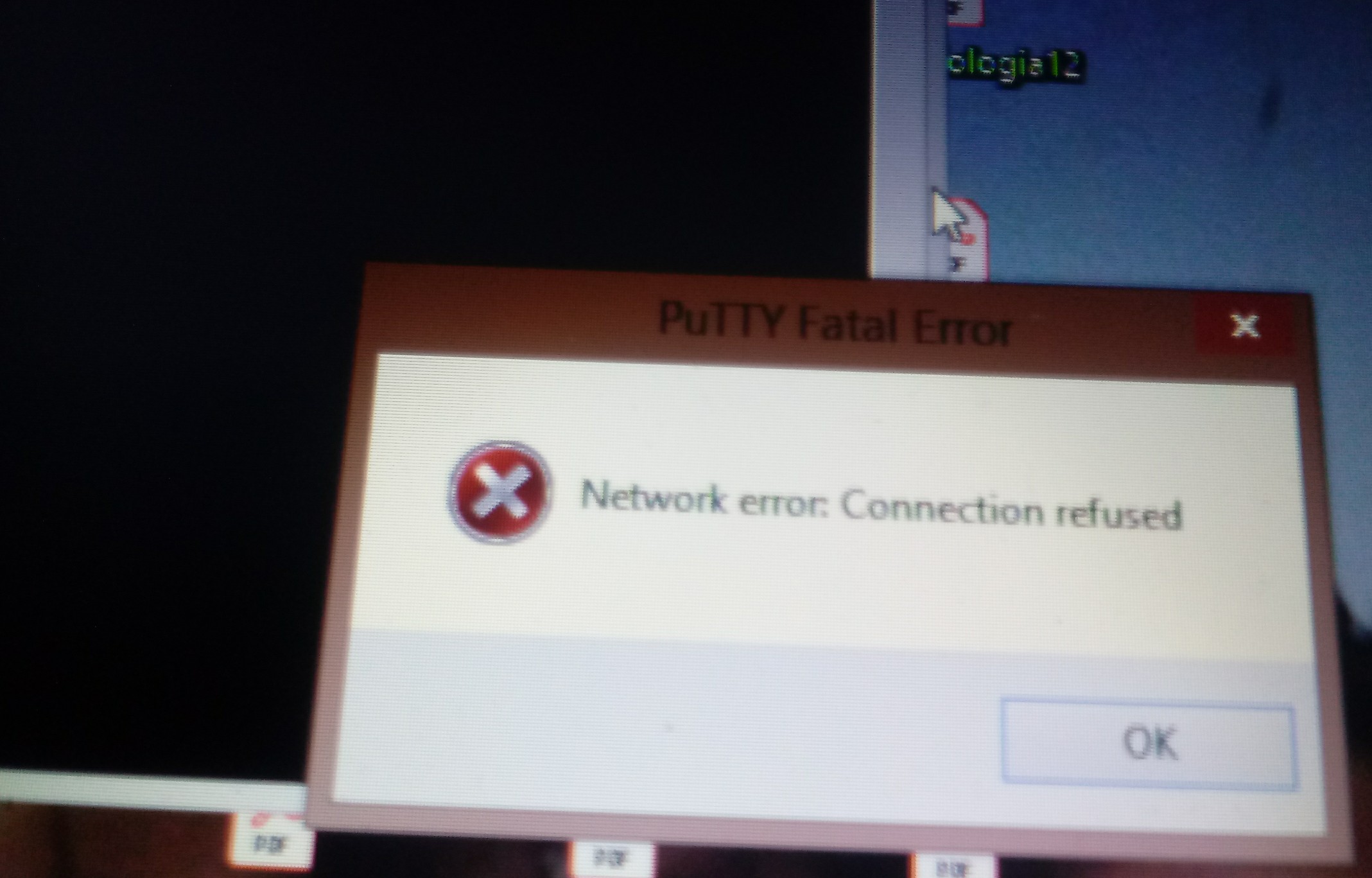

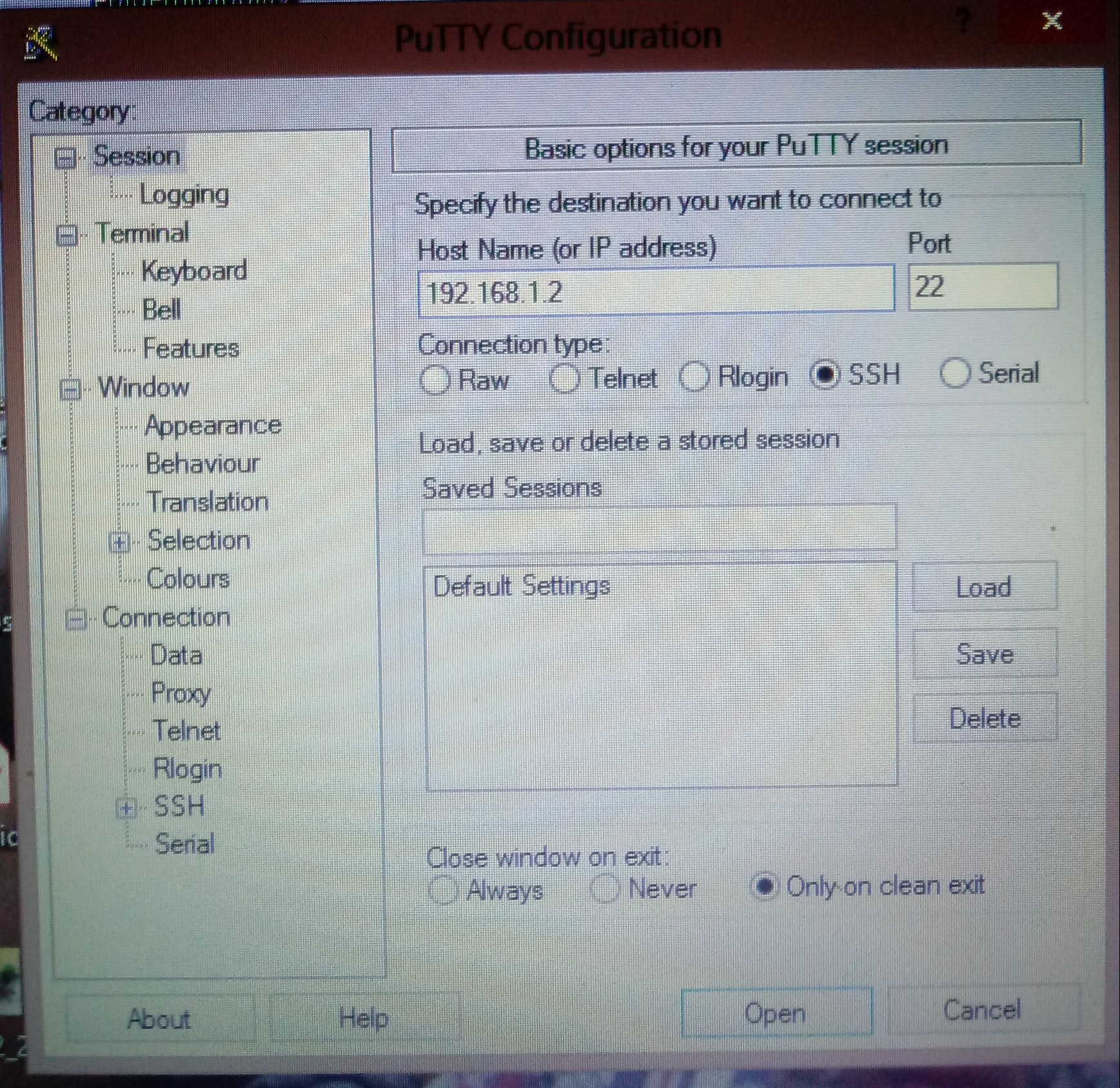

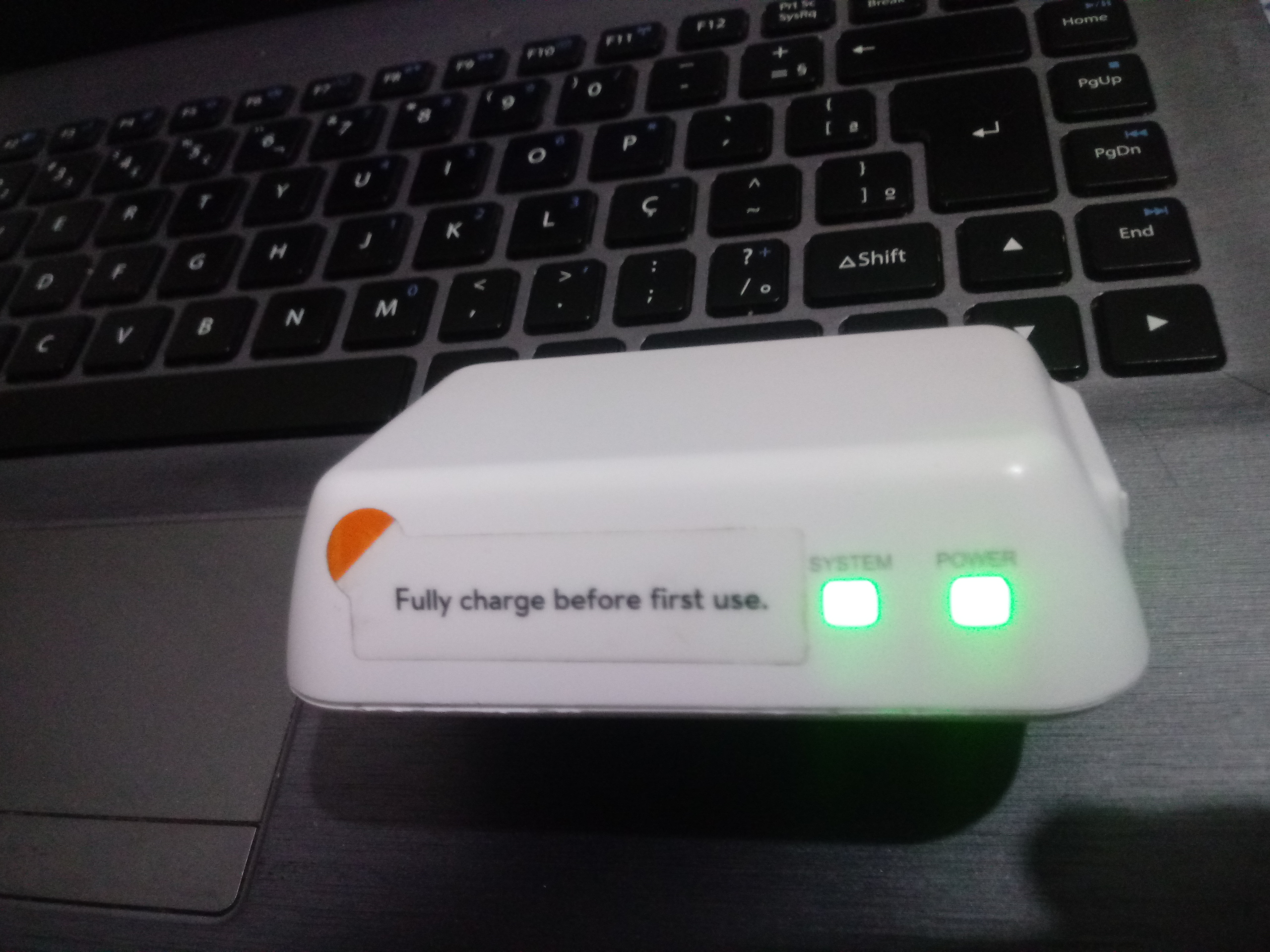

Hi, I'm from Brazil and my English is not good! I executed the procedures in putty, but I did not succeed in downloading the packages, because I was giving error because of the link of the OpenWRT site that changed! I tried in many ways, but I did not succeed. and finally the range extender (re700) battery discharged .. and the unit turned off! I left loading !! then I turned it on again and when I ran the "putty" I inserted the IP: 192.168.1.2, but it no longer appears the login, only the green dash flashes in the "putty" box and a "PuTTY fatal error Network Error: Connection refused "and the range extender does not blink anymore! I already tried to reset it but it does not respond anymore the reset does not flash the green light. it goes straight on! I do not know what to do anymore Can someone help me?
