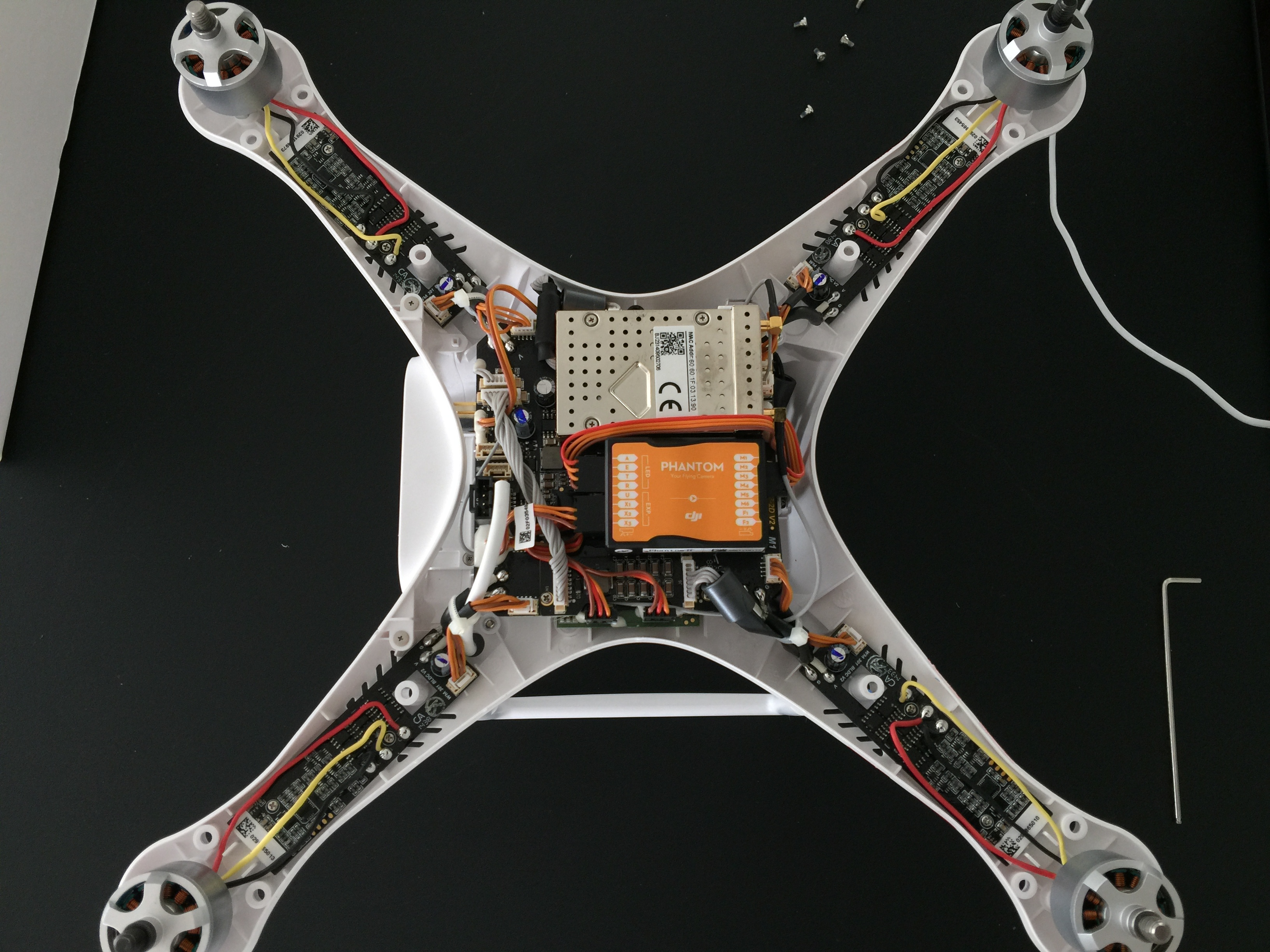

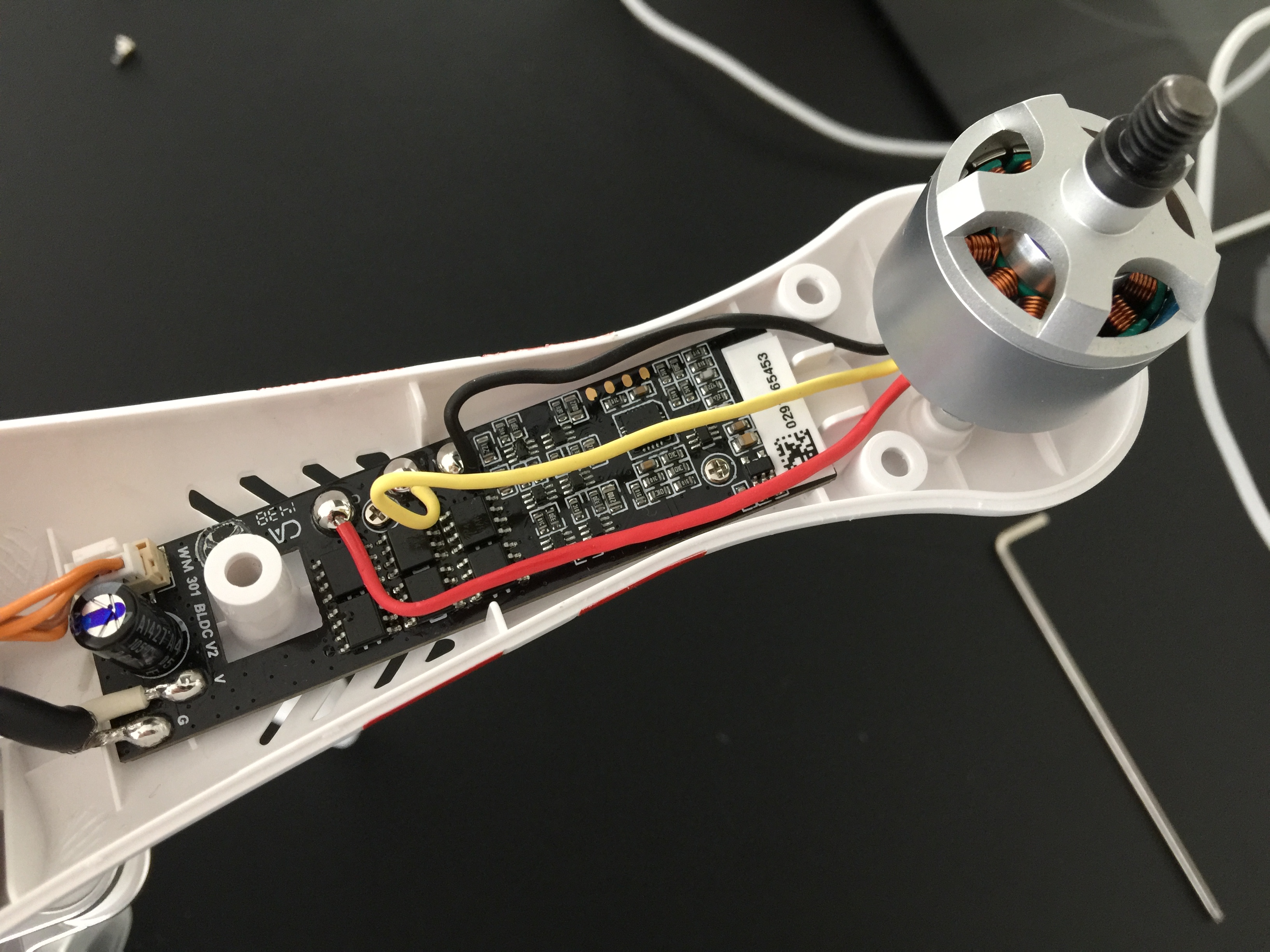

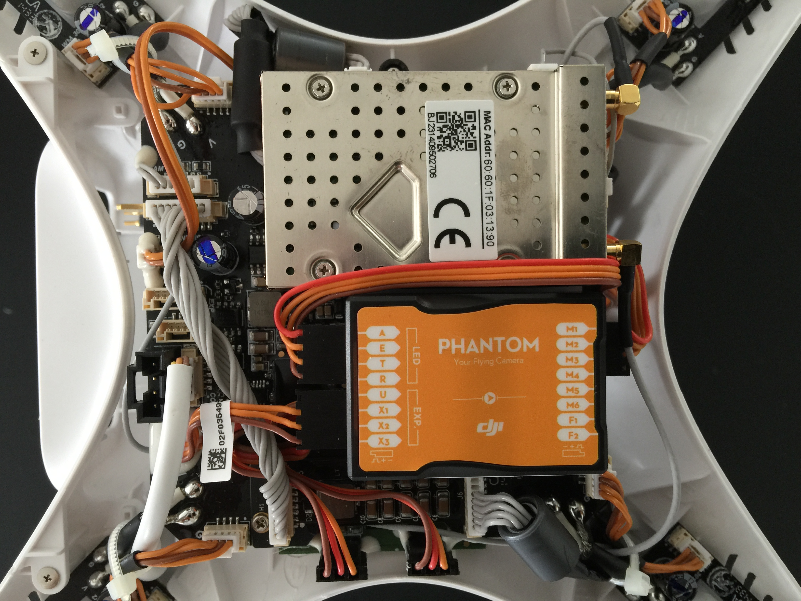

Hello to all
I have a Phantom 2 Vision+ V3 and i think it falls from the air like a stone because the battery get to cold.
I read this 42 Pages for about 30% and my English is not so good so please help me.
It's a lot of information and for a beginner like me now im out of focus ;-(
I have open my Phantom and rearranged the wires a bit.
Do anybody see another problem or what exactly i have to do for a save flight?
Thanks all.
Philippe

View attachment 17073 View attachment 17074 View attachment 17075
Based on your photos and the info I have received from DJI, the ESC's are incorrect for your motors (blue mark on capacitor).
