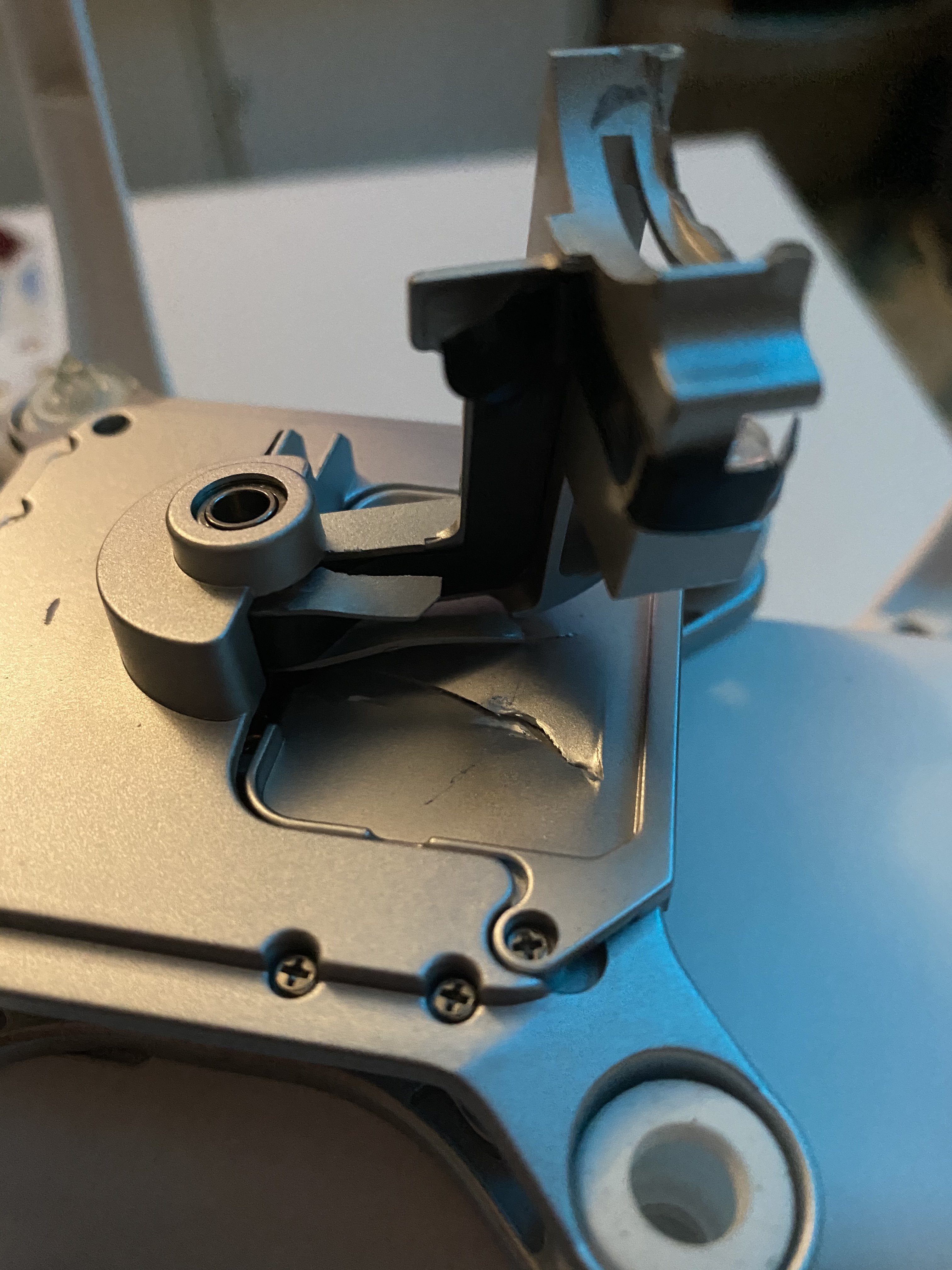

Well didn’t last long. Had a really hard landing due to operator error on my part. I was bring the drone down manually and glanced down to hit the land button on the phone and didn’t realize the left stick locked down. Looked up just in time to see the lights go out and gravity take over. Fell from about 30 ft on asphalt so it could’ve been worse if higher up and further away from me and didn’t see exactly where it hit the ground. Actually could’ve caught it if not for total shock of what happened. Didn’t realize stick was locked until after the fact. Good news it will still power up and take off so I assume it will fly although I didn’t really test it just in case. Will probably try tomorrow.

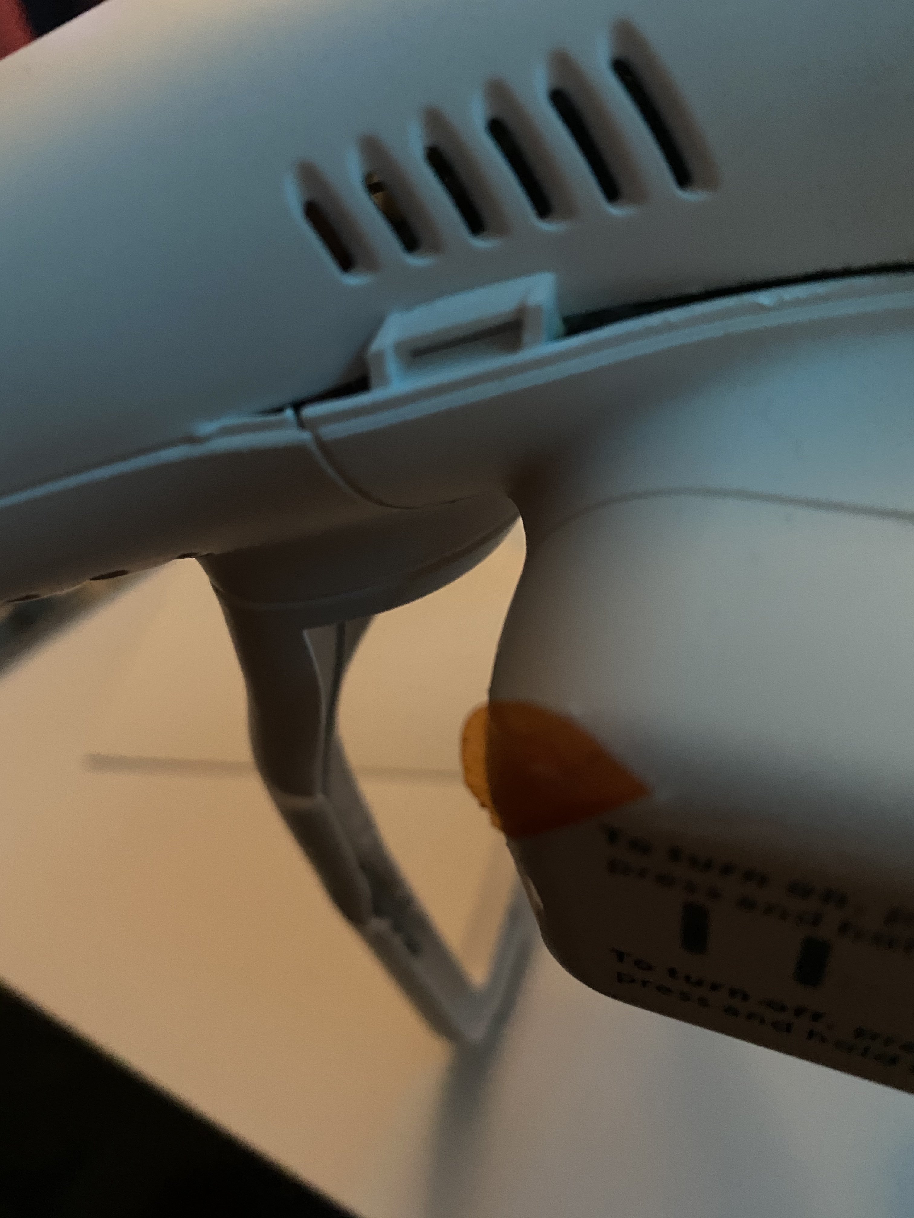

So here’s my question. I broke the gimbal arm which cracked the plate below it(see pic), cable is broke, camera completely off, bottom shell cracked in one spot(see pic), legs are a little bent but not cracked but will replace as safety concern. What all would I actually need to order to fix this thing and get it back in the air safely with a working gimbal/camera?

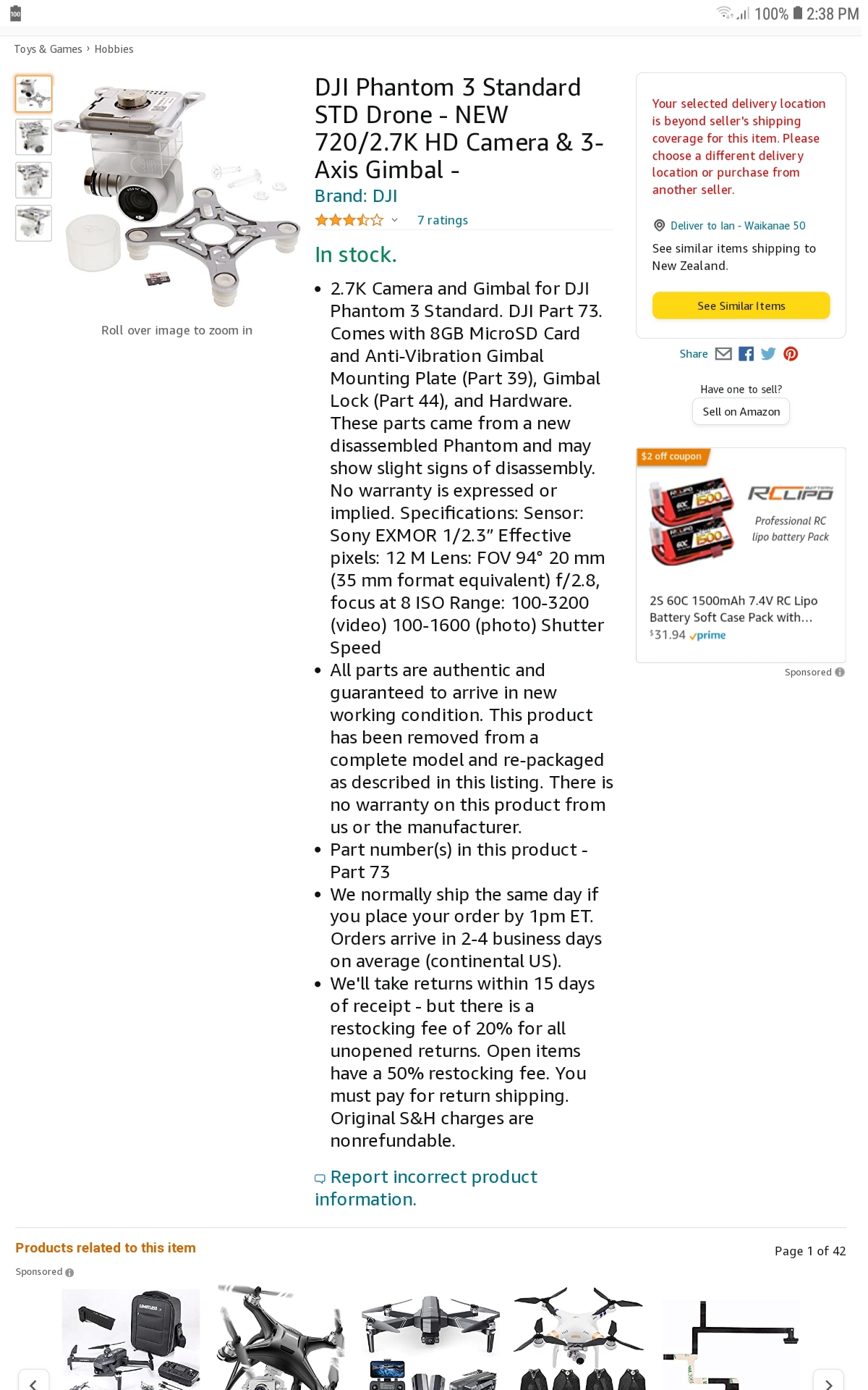

Easy to do ,yip left stick down in that position is for shutting motors off on the deck,you must had hard lead thumb (like lead foot as some say)..Ebay or Amazon or similar sites sell replacement kits and you might find one complete with cam since it to took a knock ..this one I show is Amazon but might be cheaper on Ebay with your $$ currency,,,bummer alright but can easily happen ,pays to try find a set or individual parts cost will add up,,,,man I got fright to see that totally unexpected,,sure I heard you shout....shell should just clip back together with loosening of couple screws

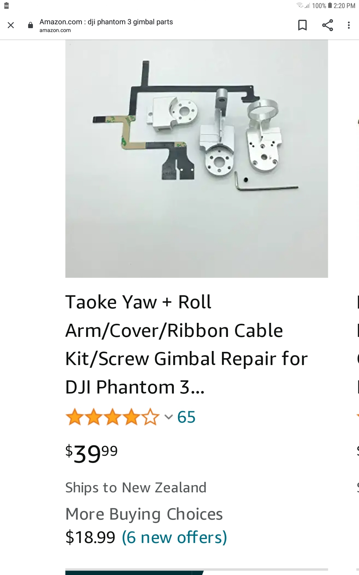

Anyway thanks for the input. I saw that kit the only thing I’m worried about is the plate under the arm being cracked as well. I’m going to try the camera out before I replace. The kit with camera is more than I paid for the drone lol.
Edit: upon closer look. The bottom shell is not cracked it’s just pulled apart at the battery tray. So as long as none of the tabs broke off I might be good there. Won’t know until I take it apart to do the work on the gimbal.

Can get whole complete kit,,have search Amazon, the price should be cheaper where you are....yes can fly with no cam but no telemetry or re linking available ,,,,mayby buy another cheap p3s for flying and keep yours for parts ,,good luck man ,,bloody bummer,,,,,,,mayby someone here can sort you some spares or complete unit near your location

$289 USD and would still need to get the kit from the first screenshot you sent for another $40. Here’s to hoping the camera’s not busted but took a shot so who knows. If it comes down the needing all of it I may just try to find another P3 deal and either keep this one for parts or fix it later and have 2 to fly. Maybe I could get the wife into it. ?

If repairing make sure the ribbon cable says DJI oem, not FOR DJI. 3rd party don't usually work. P3s parts are cheap but so are the used drones. GL and sorry bout that. Hope you get fishing soon. That left stick lock was discontinued on later models, for good reason.

Thanks Capt. I will make sure it’s a DJI cable. I’m looking at my options now. Going to buy the arm replacement and cable first and hook it all up. If camera is trashed I’ll probably by a used P3S and may fix it later or fly without the camera on this one. The main thing I’m worried about is getting telemetry and everything back on the app. Nothing shows up where the gimbal is disconnected so not really safe to fly without knowing critical info, battery level, cant use RTH,etc.

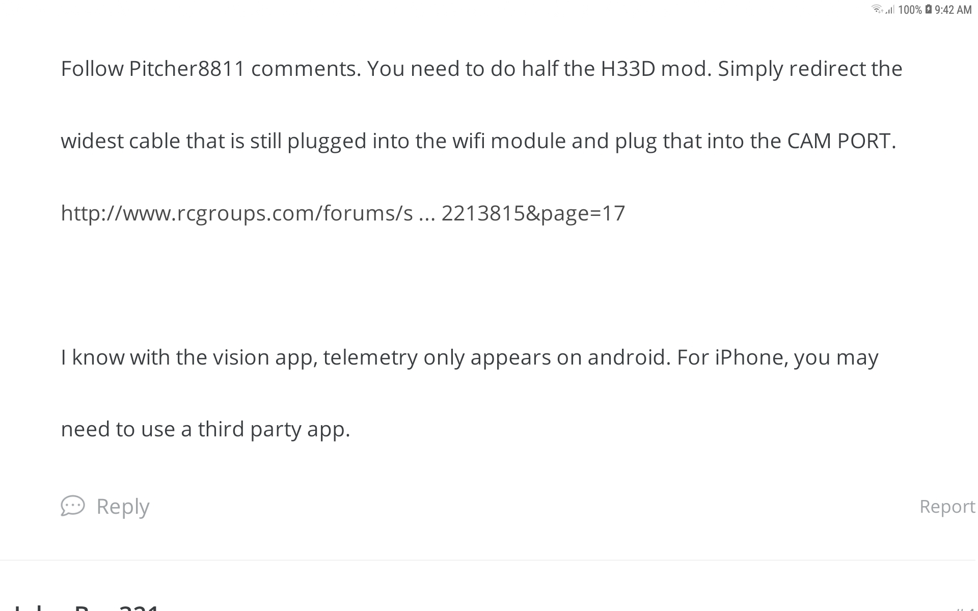

Seems I have some pretty knowledgeable people and people that have been around a while in this thread, so I’ll ask here first instead of making a new one.
I’ve searched google which pointed me right back here saying that someone at some point in time found a way to fly a P3S without a camera/gimbal and still have telemetry in the DJI go app. Anyone know if/how this would be possible or where I could find info on it? I have searched the forum but no luck so far.
I have another P3S in the works, but I would like to keep this one as well. I’m not 100% sure the camera is actually busted but trying to fix as cheap as possible. Will only be using for LOS flight anyway as this will be my fishing rig so I really don’t have to have the camera on it at all. Would like it to connect to the app if at all possible just more for safety concerns, ease of landing and so that RTH would work. I appreciate any help. If I’m reading correctly signal is carried from WiFi to the drone down to the gimbal and back up to drone. Surely there is a way to cut out the gimbal part of that so it just sends and receives from RC to AC and back.
If not replacing the cam,dont link remote with another or your original p3s wont be able to be relinked to it since cam missing,to my knowledge no cam means no telemetry since it helps power the wifi module,,I have seen a post where one mention bypassing the cam with its large wire plug back into the board but cant find no pictures or info about it,still not sure if that will give telemetry either but might restore live view to a go pro,,this was something I just read so not sure if it's even possible since the OP in question never replyed with update,,,should work fine as fishing drone though,go bit faster to with cam gone,less weight and wind drag,,,,this post below was what I seen..again dont know if works or not
Thanks I saw that post as well. Going to just order the $40 kit with the gimbal arm and ribbon cable and see if that will work. Even if the camera doesn’t show images maybe with everything plugged back in I’ll at least get the WiFi back working correctly. Then I’ll focus on camera later.
