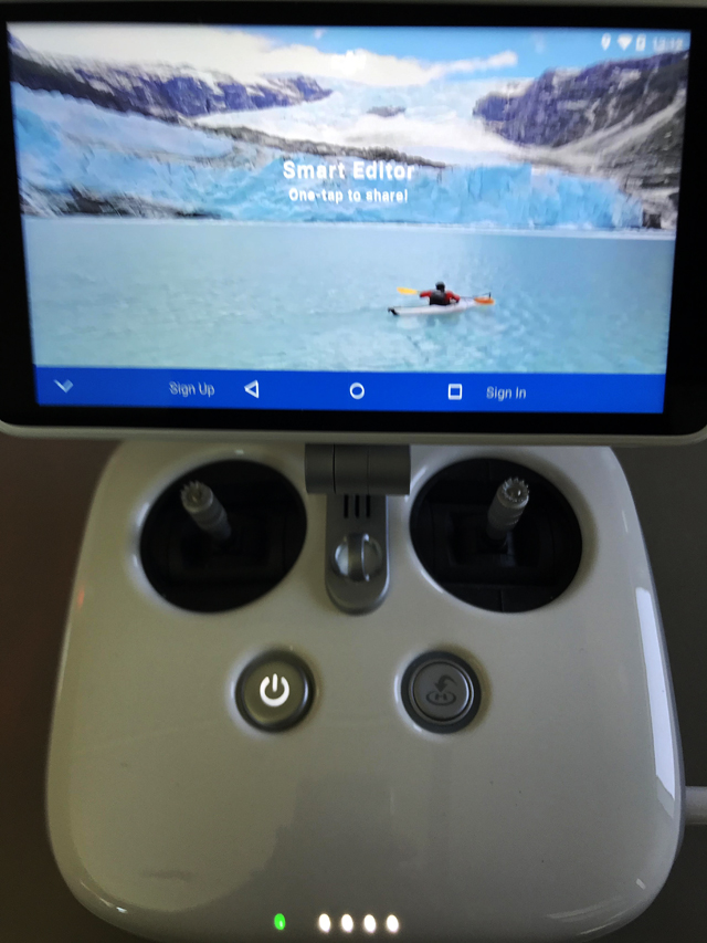

To answer your question: " I'm not sure if the "Sign In" screen is for the controller, the DJI Account or the Go 4 app. .
How do I determine which one"?
I'm posting a photo of my "Sign-In" screen as you requested.......
I am able to sign into my DJI account using my Lenovo Desktop Computer and I'm able to access the DJI Go app on my IPhone 7+.
but I'm unable to "Sign-In" with the DJI Controller. The prompt continues to display: "Network Unavailable".
WiFi is turned "ON".
I really appreciate your response....and hope we can continue to work together and solve the problem.
It's been very frustrating and I have flown the aircraft several times without "Signing In" but I have no

Forgot to attach the photo....sorry about that!

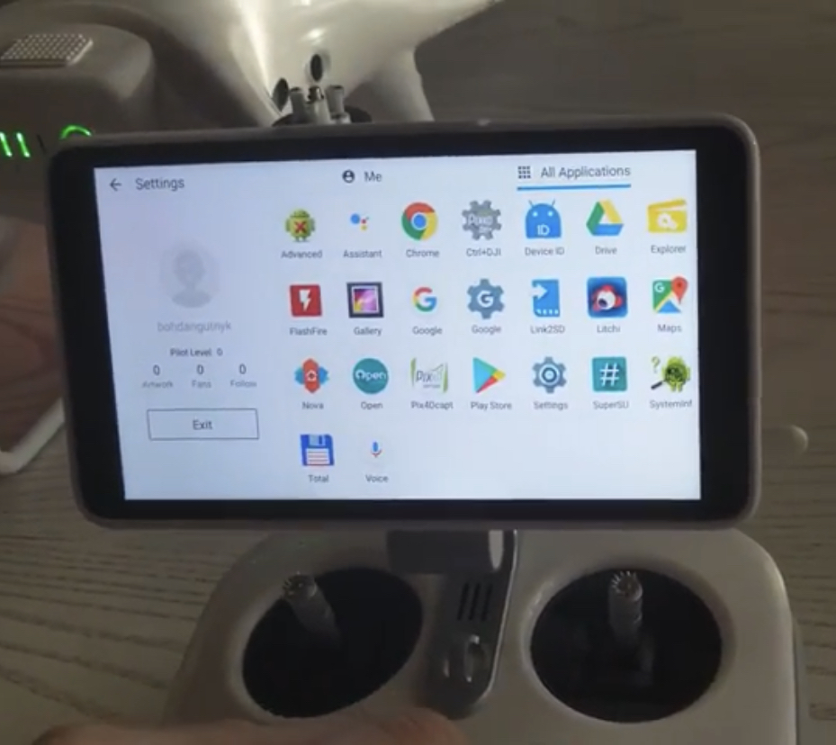

I don’t have a + RC, so unless someone who owns one replies all I can do is search here in the forum and search on Google.
You’ve said several times that you can swipe down from the top and get to the menus. You’ve said that you’ve gone there to check that your WIFI is enabled. When you are in those menus/screens, do you see “All Applications” which should lead you to the screen in the picture below. I found the picture in a quick Google search. On that screen is an icon for Chrome which is the standard browser on Android devices such as your RC’s monitor.
I'm unable to access the screen as you have shown. When I click on "All Apps", I get a small drop-down list of apps that are installed on the controller....
and....DJI Go 4 is on the list but when I click "It" , the prompt states it's running and "Do not Stop the App."
So then when you saw the drop down menu of apps, you certainly must have checked to see if one of them was the Chrome browser. Did you and was it passing internet traffic?
