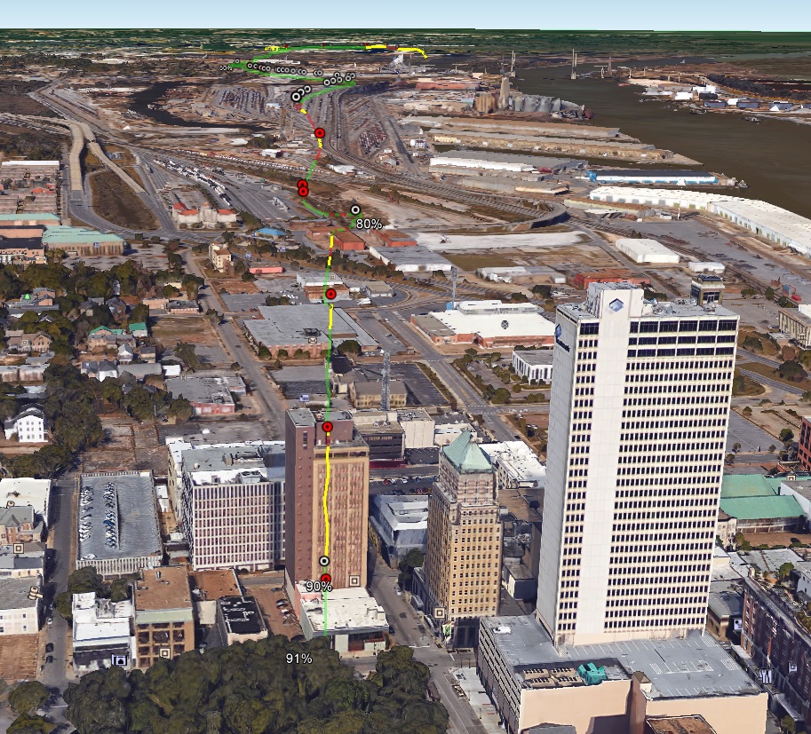

Attached is the flight log...would anyone who knows how to read these things tell me if I did anything I shouldn't have done?
The most obvious thing is the wind speed that day.
The Phantom is up nearly 600 feet where the wind is much stronger than on the ground.
You flew your Phantom away downwind in a strong wind which will always mean a hard slog back with a headwind.
This is a huge mistake which is a factor in many reported "flyaways"
AT 3:43 with the Phantom only 740 feet away you initiated RTH and watched your Phantom go backwards at 3-4mph until it was 4300 feet away and signal was lost because a tall building blocked things.
You tried a couple of times to power into the headwind but that only slowed the drift and didn't reverse it.
You left your Phantom up high in a wind that was blowing harder than RTH could fight.
Had you brought the Phantom down out of the worst of the wind as well as pushing the right stick to kick up the speed you would still have your Phantom.
Of course the easiest thing would have been to prevent the incident by flying upwind and not so high in the first place.
