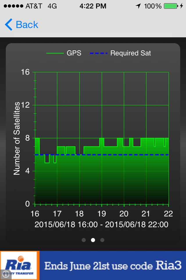

Guess is not safe to fly here by 4:30 bet i get a flyaway with no sat
bet a lots of pilots font have any idea
The best prevention to help prevent fly a ways.... Calibrate. Calibrate and Calibrate.... That's the IMU number one most important. Compass 2nd and the RC sticks third. After those it wold be due to pilot error or a hardware failure of sensors.
Yep land but if un experiece pilot on 10 m wind is going crash almost 90% of time key is prevention and using all tool an calibration
Guess is not safe to fly here by 4:30 bet i get a flyaway with no satView attachment 22323 bet a lots of pilots font have any idea
The available GPS satellites shown there is dependent on your settings (elevation mask). You will find that there will be more sats shown as available with a lower mask setting. Bottom line: when you take off and gain some altitude there will normally be enough sats for a good lock. Try lowering your elevation mask setting, then through trial and error you'll get a feel for the correct setting.
If I left the default mask setting I never would have seen enough sats to attempt to fly. For my location and area of flight the appropriate setting turned out to be 5 degrees.
Best of luck.
set at 15 here Houston will ck thanks
