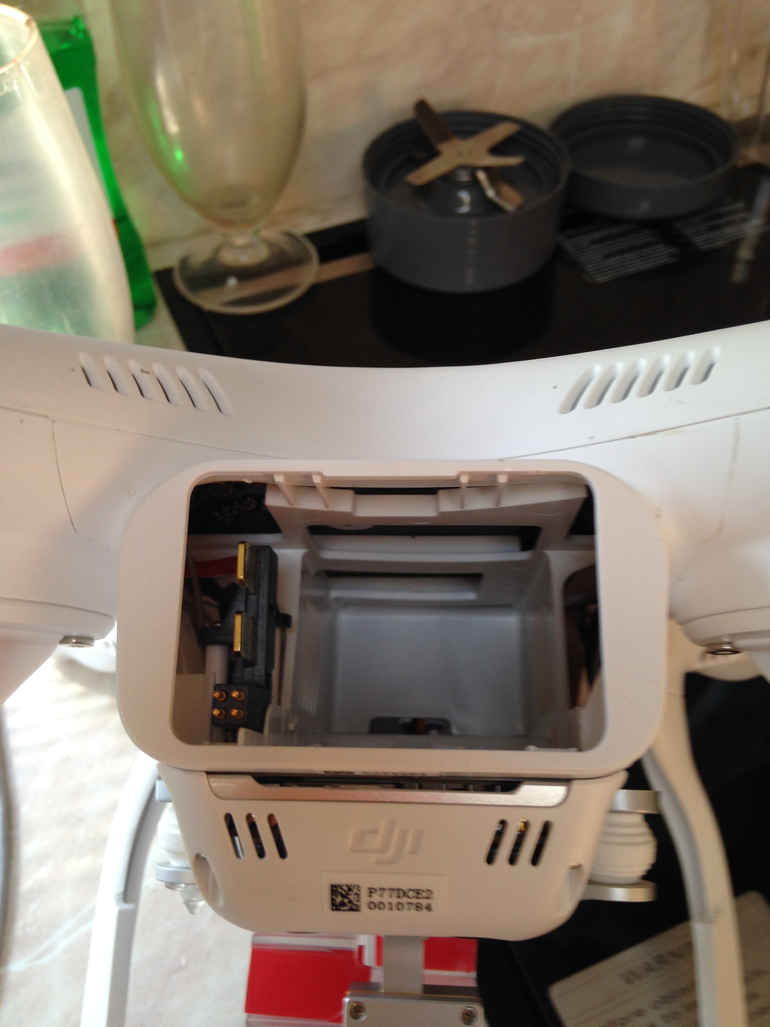

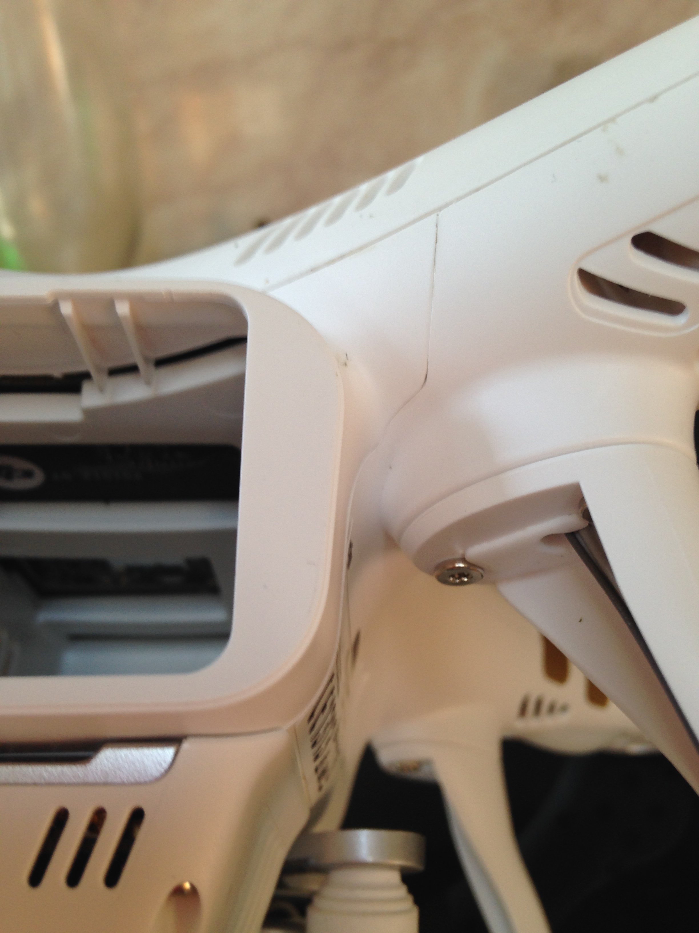

I'm not sure if these are cracks to?
View attachment 34733View attachment 34734
Those are not cracks. The shell is divided there. Nothing to worry about
Admittedly I did not read all the replies, but have we established if this "new and improved shell" is the latest generation with larger vent holes and motor mount cross bracing? I would like to see a flashlight under the motor and a perfect top down shot highlighting the small gap between the motor and the circular cut out in the top shell half.
