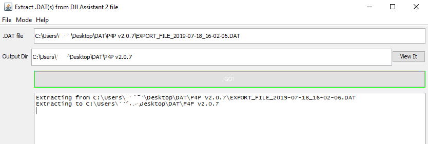

Hello, here's what i have done so far:
1) Exported logs from drones internal memory
2) File saved as: EXPORT_FILE_2019-07-18_16-02-06.DAT
3) Run ExtractDJI from DatCon (3.6.6)
4) Select saved .DAT
5) Mode is default (Extract DATs only)
6) Click GO! button
7) Results:
112938
After extracting, there is no extracted FLYXXX.DAT in output folder

Looks like there wasn't any FLYxxx.DATs within the EXPORT_FILE_2019-07-18_16-02-06.DAT file.You can check the contents of the EXPORT_FILE_2019-07-18_16-02-06.DAT file by selecting List Contents
112939

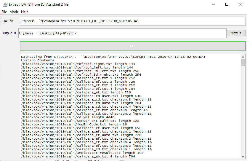

Should see something like this
112940
DJI Assistant 2 wasn't given the right specs when you told it to create the EXTRACTxxxx.DAT file. There are several different versions of DJI Assistant 2 now so I can't offer any more specific advice.
I have tried these options:
1) List Contents
112954
But there are no data in output folder

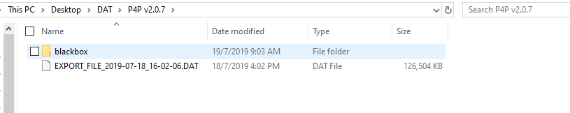

2) But when i use 'Extract All", I have these files from black box. How can i use this data?
112956
1) List Contents
Btw, i have used several DJI Assistant apps, but still get the same results
- DJI Assistant 2 v1.2.5
- DJI Assistant 2 For Phantom v2.0.7
AFAIK there is no way to use this data.
I'm gonna guess that you told DJI Assistant 2 to extract the black box data? If so, this isn't the correct option. Try these instructions
