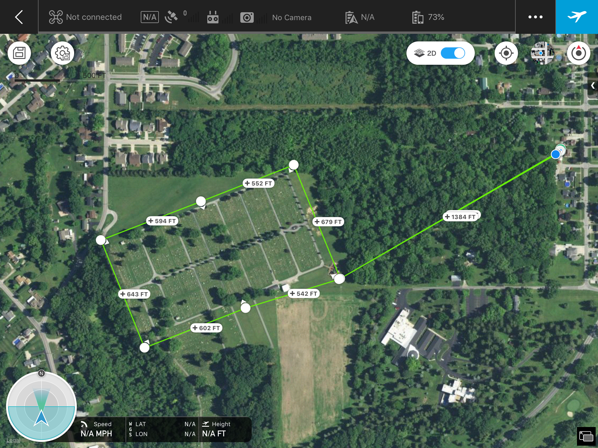

You can use DJI Ground Station Pro to setup waypoints and actions then fly the route autonomously. Each point can be edited for camera angle, position, height, etc.
