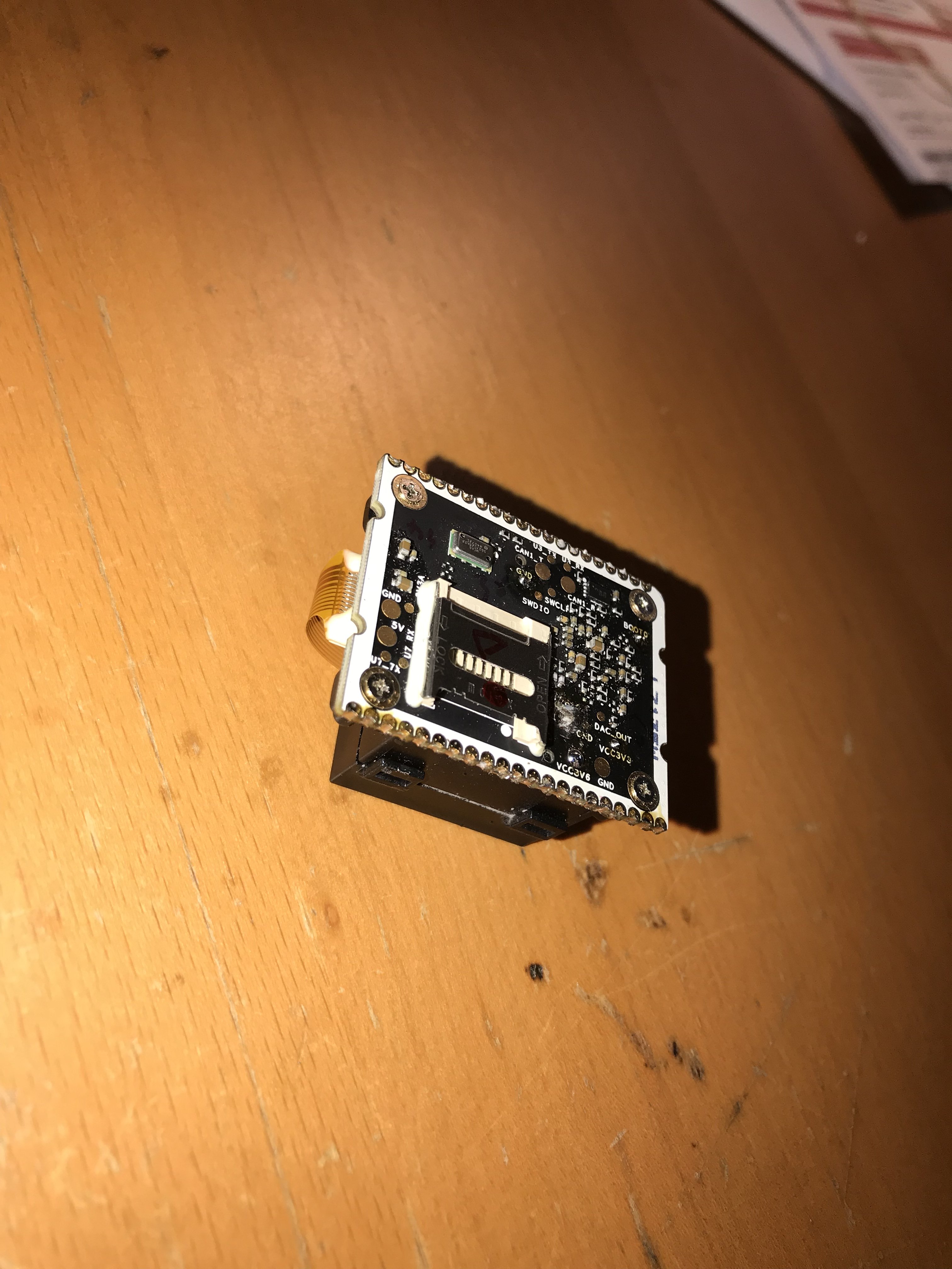

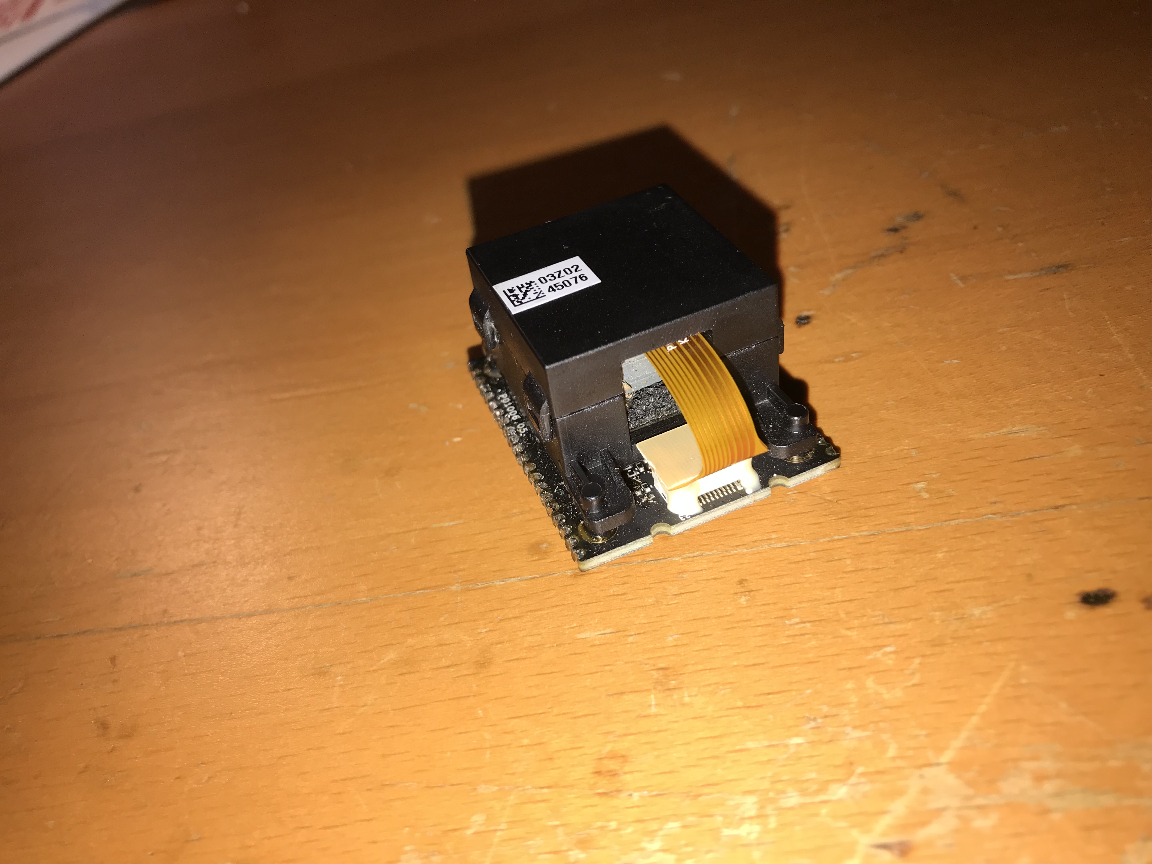

Ive managed to brick my p3 pro. its giving me constant beeps and flashing red light.
Ok, so the issue is with the bird itself, not with the camera. That is actually good - the camera is the most expensive part nowadays.
I tried to flash it with a wrong file.
Unless you modded it yourself, this isn't that easy:
P3 Firmware - You can't flash wrong firmware on DJI products
The controler connects to it and I get a feed. i can downgrade firmware and upgrade but it will not fly.

First of all let me say wow this explanation is great. Yesterday I tried very carefully to solder some hair thin wires to the pb10 and pb11 tiny tiny pads on the MC. Pb10 I did ok (while my solder Iron was heating up), pb11 I accidentally pulled because I had forgotten my solder Iron on too high a temperature and I burned off the pad... That was stupid. So I basically screwed myself once again out of trying to solve it by flashing by uart. The I got an idea which is identical to your first suggestion of putting the bootloader in a wait state and flash by sd. I shorted the boot0 pad to 3v3 and tried. I was hopeful that this would put the bootloader in a "wait" state. Nope. Nothing. Tried again shorting boot0 with ground. Again nothing. In the datasheet of the specific stm32f427 it says you need to pull boot0 and boot1 to a combination of high and low or something like that. I dont know what pulling a boot pad low or high means. Yes I Googled it hehehe. Couldn't make sense of it. So the first method I either did wrong or doesnt work :(
I then carefully sucked all the solder off the main controller and carefully detached it from the mainboard and I am waiting a "esc error" p3 pro mainboard from a local repair Shop to steal the "good" mc from and swap into my mainboard. If that doesnt work I will have to buy an stlink and learn how to program the chip. I hope the stlink doesnt need to use the pb10 of pb11 and only uses the sdio and sdwc pads among the other "still safe" pads on the MC board or else that bridge is burned too... Here's some pics I took of the now removed mc. Again I can't thank you enough for the good and simple explanation you gave me on your post above. Also your own ordeal with replacing that chip on your camera board and being successful was an inspiration to me to try and repair mine. Not so much because I am a cheapskate and dont want to spend 150 on a new mainboard, but also because its a shame to throw out a perfectly good mainboard because the easily de-solderable mc has a problem and the MC alone is no where to be sold seperately. Its a waste of electronics and a huge contribution to the whole used electronics pollution problem. Ofcourse why dji would care about that? They just designed the p3 with undetachable esc's and I can only imagine how many people had to throw out a whole board with a perfectly good mc and a couple of good esc's just because one esc failed!!!! Its also the only electronics board I have seen been sold to the public from their official site. Thank God they didnt keep at this stupid design with their p4 series and thankfully designed it for seperate esc boards!!!
Reactions: quaddamage
