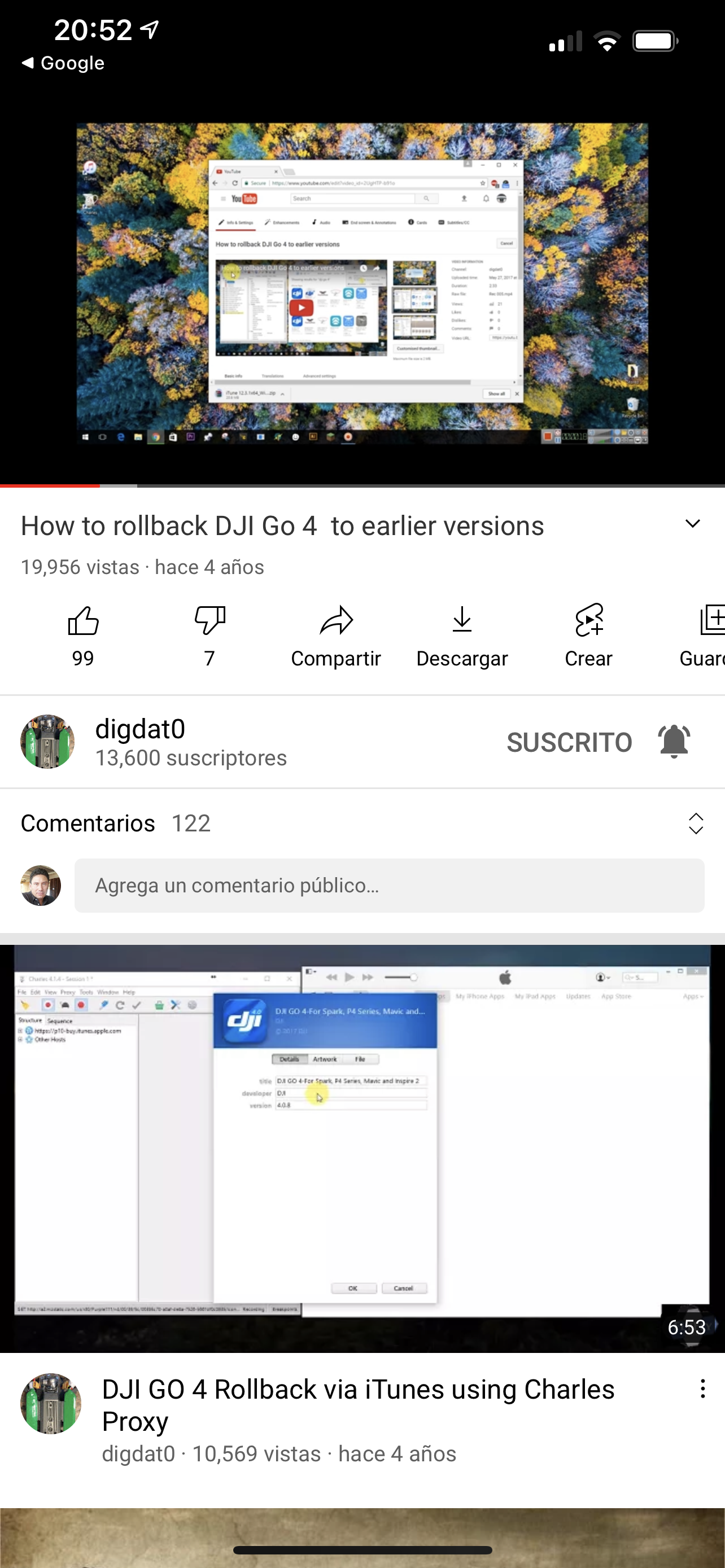

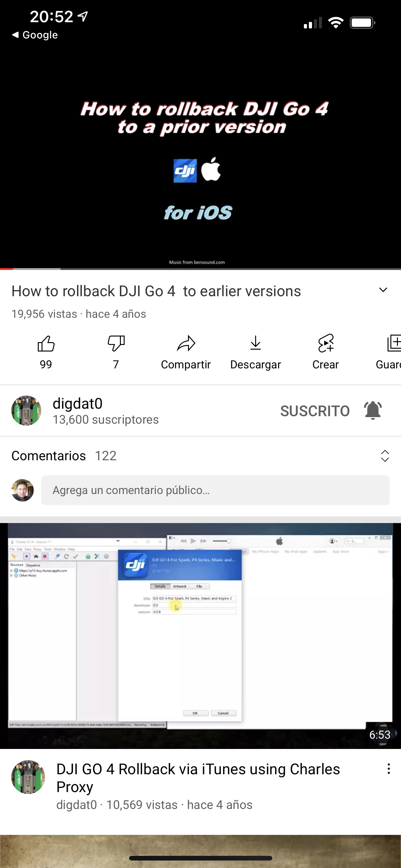

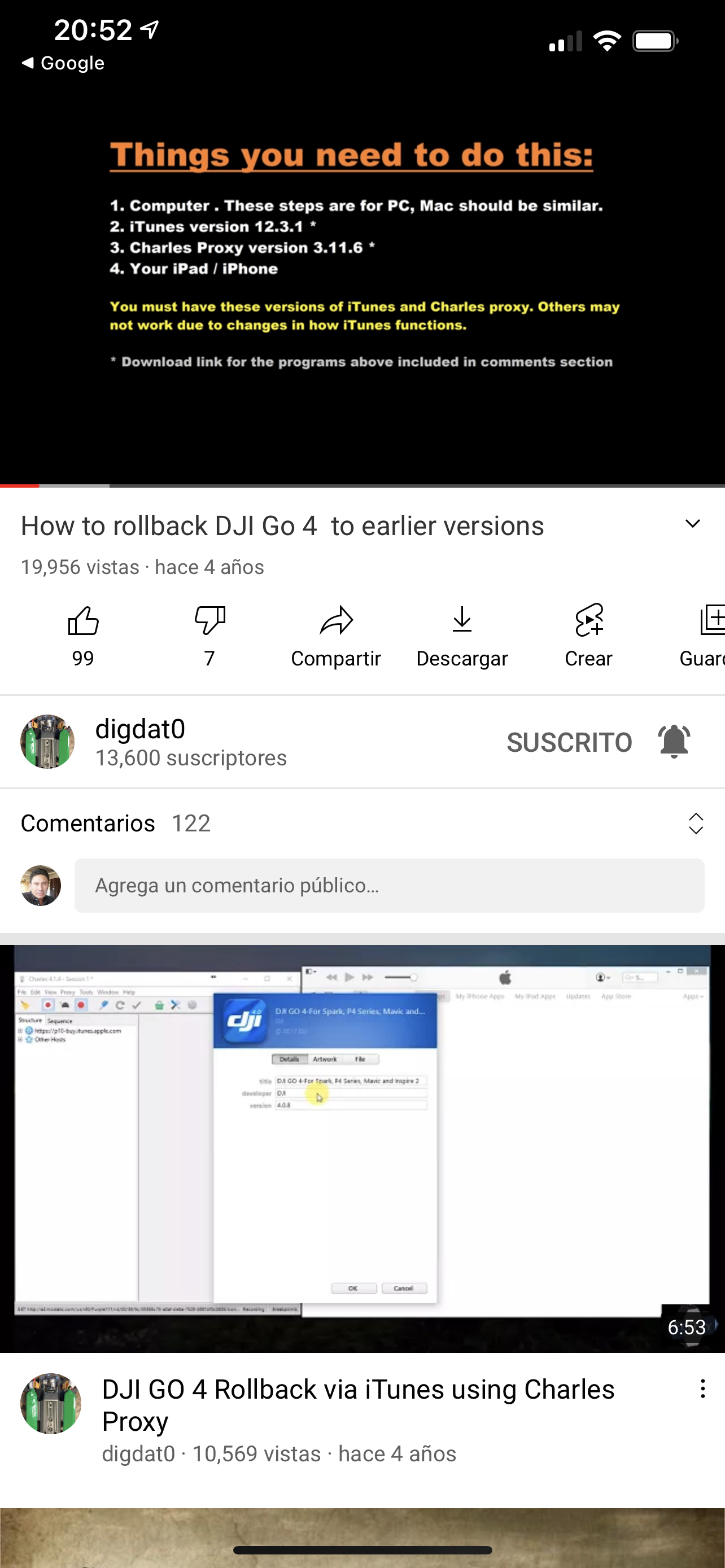

Greetings Pilots.! .. Any of you know how to downgrade the DJI GO4 App on IOS. ?… I found a video on YouTube where they explain how to do it but it is a video from 3 years ago and uses a program called Charly Server, iTunes with an old version and a list with the numberings associated with each DJI GO4 Firmware… I tried to do it described in the video but I could not achieve it, since the versions used are very old ... Do any of you know how to do it with updated programs? Thanks .!

* Installing an older version of the Go4 app requires legacy iOS versions (which may require the purchase of a legacy iPad) and requires legacy iTunes (v12.5.4.42 is my recommendation).
* The program you are referring to is "Charles Proxy," and is what I used to download legacy .ipa files.

Hello Harleydude… Thanks for your comments. About outdating the Firmware of my Drones ... maybe I did not know how to express it, but the truth is not what I am looking to do, I have three teams, an Inspire 2, Phantom 4Pro, Mavic 2 Zoom, which are working perfect. What I need is to download the version of the DJI GO4 App that I have installed on my IPhone and my IPad, on both devices I have version 4.3.42 installed and I want version 4.3.41 or 4.3.40. I have looked for other ways to do it in addition to the one you have already described to me and that is by using the AnyTrans program in conjunction with ITunes. I haven't tried it yet as my shift work hasn't allowed it, so I'll try to do it in the next few days. If you have more detailed information on how to do it with the method you described in your post, I will appreciate it, my email [email protected]. Greetings

In a nutshell, one can't just download legacy .ipa files. You have to steal them....<:^/ The good news is that they're all on the Apple servers. The bad news is it's a hack to get them. Do a YouTube search for "Charles proxy go app" and that will probably get you in the ballpark. It's not easy and it's not an exact science. Because computers and their environments have so many variables, what works for some doesn't always work for others. So you're just going to have to dive down the rabbit hole yourself to get the files. I already gave you a big jump with the iTunes version, which you will have to find on your own. And I also gave you a shortcut telling you that you may have to use a legacy iOS....and a legacy iPad. At least now you're cognizant of these variables - which I had to learn the hard way and discover all on my own.
