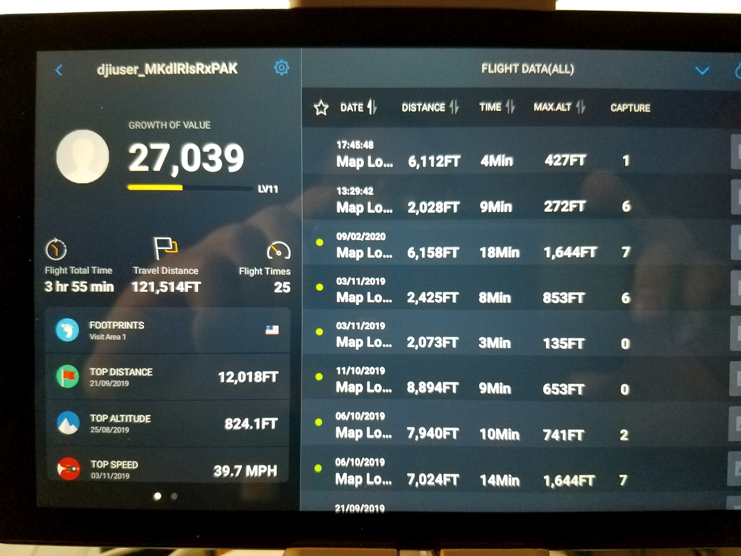

I'm unable to locate any 'DAT information on my controller. No idea where that is located. I can find the "flight data (all)" list, but when I click on my last flight it just says "loading", but never loads anything, even after several minutes. I know my "show flight route" has always been turned on. Nothing quite as expensive as learning by braille.

I thought my recorded flights would provide a path to go back over, but none of them will load. See Pic.

Goshawk you can click your last flight there on the right it should bring up a map and video recording of you flying the drone also should have coordinates I know cause my dad uses the Dji Go app for his phantom 3 pro you should be able to find the last location of your drone or a rough estimate of its location that's better than nothing.
Correct. It just says "loading" but nothing ever loads. None of my past 20+ flights will load. I'm heading off to bed, so thanks to all. I'll check back tomorrow, but it will be late as I'm Pacific time.
That's what I thought too, but none of them will load. Of course I only need the last one to work but it just says "Loading", but never loads up. I've stopped and restarted at least 5 times with no improvement. A great idea, so thanks for thinking of it. It looks like my system never was working properly in that respect.

Yip as post #10 metion,,did you try sync your flight with cloud, it might let you watch it back then I think ? I know for some reason some last flights dont show cause flight ended suddenly but bit unsure here,,I did have auto land with p3s other day at 50 odd% battery but could cancel with × on screen..just wondering does p3p have esc beeping like p4 does,,if battery still in and on turn it on in the app,,,its called esc beeping,,it makes drone make loud find me noise
Do you sync your flights with cloud at top right of screen,if not they wont load...if flights aren't synced with cloud they wont load...you growth of value should grow each time you sync a new flight,, if you are syncing to the cloud uninstall the app and reinstall it that should bring it right but you will get new playstore app update,,,,,,,,,,,,! Some dont like to update when things work fine,,your choice on that
Cloud sync also does not load. It hovers at 65% and never goes beyond that.
