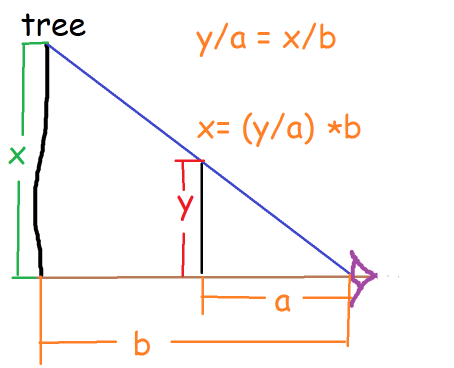

Get some paracord pull it up to tree top mark cord then measure might get you the height
maybe not the most accurate but close good luck!
If you have line of sight.
